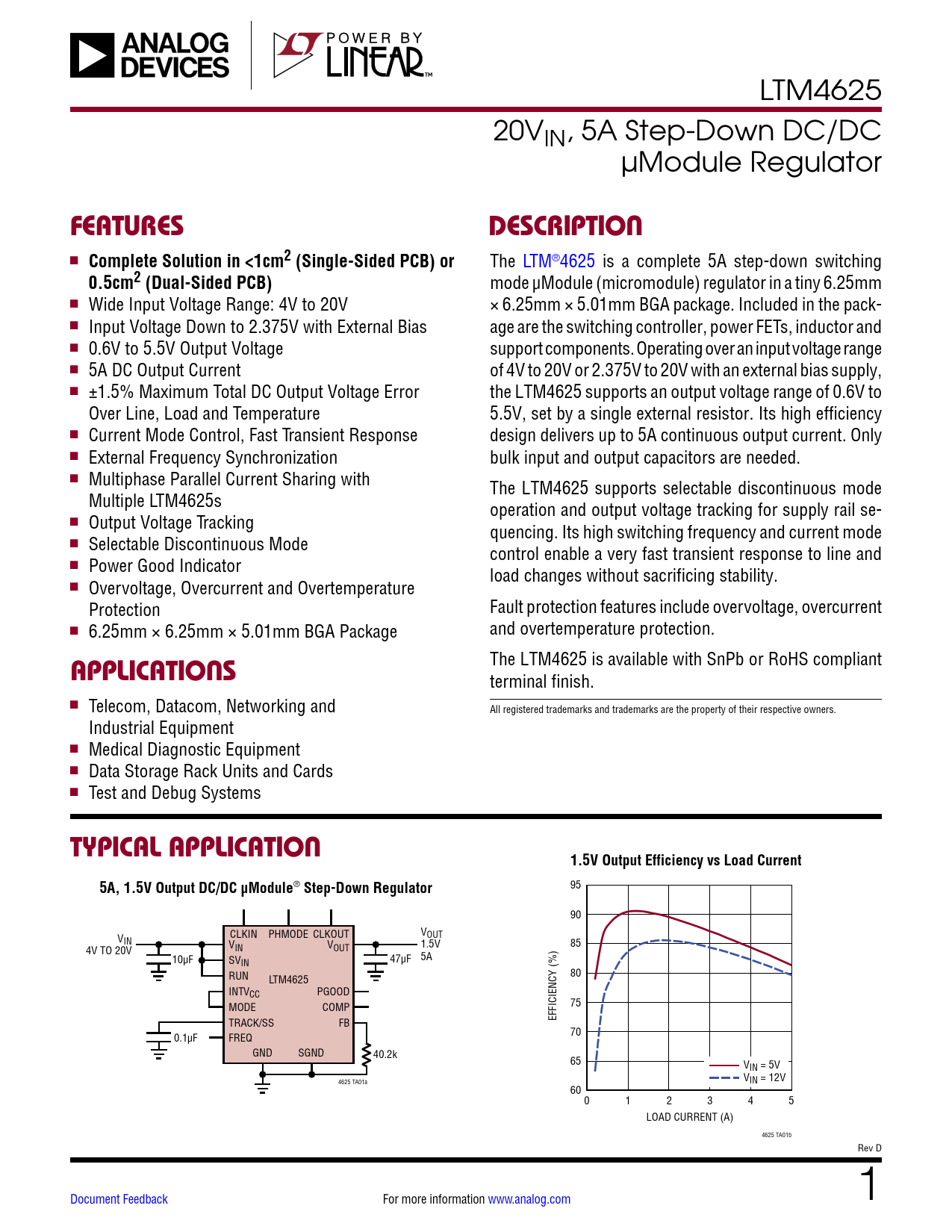

FEATURES. DESCRIPTION. Complete Solution in <1cm2 (Single-Sided PCB) or. 0.5cm2 (Dual-Sided PCB). APPLICATIONS

FEATURES DESCRIPTION
n
The LTM®4625 is a complete 5A step-down switching
mode µModule (micromodule) regulator in a tiny 6.25mm n Wide Input Voltage Range: 4V to 20V × 6.25mm × 5.01mm BGA package. Included in the pack- n Input Voltage Down to 2.375V with External Bias age are the switching controller, power FETs, inductor and n 0.6V to 5.5V Output Voltage support components. Operating over an input voltage range n 5A DC Output Current of 4V to 20V or 2.375V to 20V with an external bias supply, n ±1.5% Maximum Total DC Output Voltage Error the LTM4625 supports an output voltage range of 0.6V to Over Line, Load and Temperature 5.5V, set by a single external resistor. Its high efficiency n Current Mode Control, Fast Transient Response design delivers up to 5A continuous output current. Only n External Frequency Synchronization bulk input and output capacitors are needed. n Multiphase Parallel Current Sharing with The LTM4625 supports selectable discontinuous mode Multiple LTM4625s operation and output voltage tracking for supply rail se- n Output Voltage Tracking quencing. Its high switching frequency and current mode n Selectable Discontinuous Mode control enable a very fast transient response to line and n Power Good Indicator load changes without sacrificing stability. n Overvoltage, Overcurrent and Overtemperature Protection Fault protection features include overvoltage, overcurrent n 6.25mm × 6.25mm × 5.01mm BGA Package and overtemperature protection. The LTM4625 is available with SnPb or RoHS compliant

TYPICAL APPLICATION 1.5V Output Efficiency vs Load Current 5A, 1.5V Output DC/DC µModule
Step-Down Regulator
95 90 V CLKIN PHMODE CLKOUT VOUT IN 85 4V TO 20V V V 1.5V IN OUT 10µF SV 47µF 5A IN RUN LTM4625 80 INTVCC PGOOD MODE COMP 75 TRACK/SS FB EFFICIENCY (%) 0.1µF FREQ 70 GND SGND 40.2k 65 VIN = 5V V 4625 TA01a IN = 12V 60 0 1 2 3 4 5 LOAD CURRENT (A) 4625 TA01b Rev D Document Feedback For more information www.analog.com 1 Document Outline Features Applications Description Typical Application Absolute Maximum Ratings Pin Configuration Order Information Electrical Characteristics Typical Performance Characteristics Pin Functions Block Diagram Decoupling Requirements Operation Applications Information Package Description Revision History Package Photo Design Resources Related Parts
