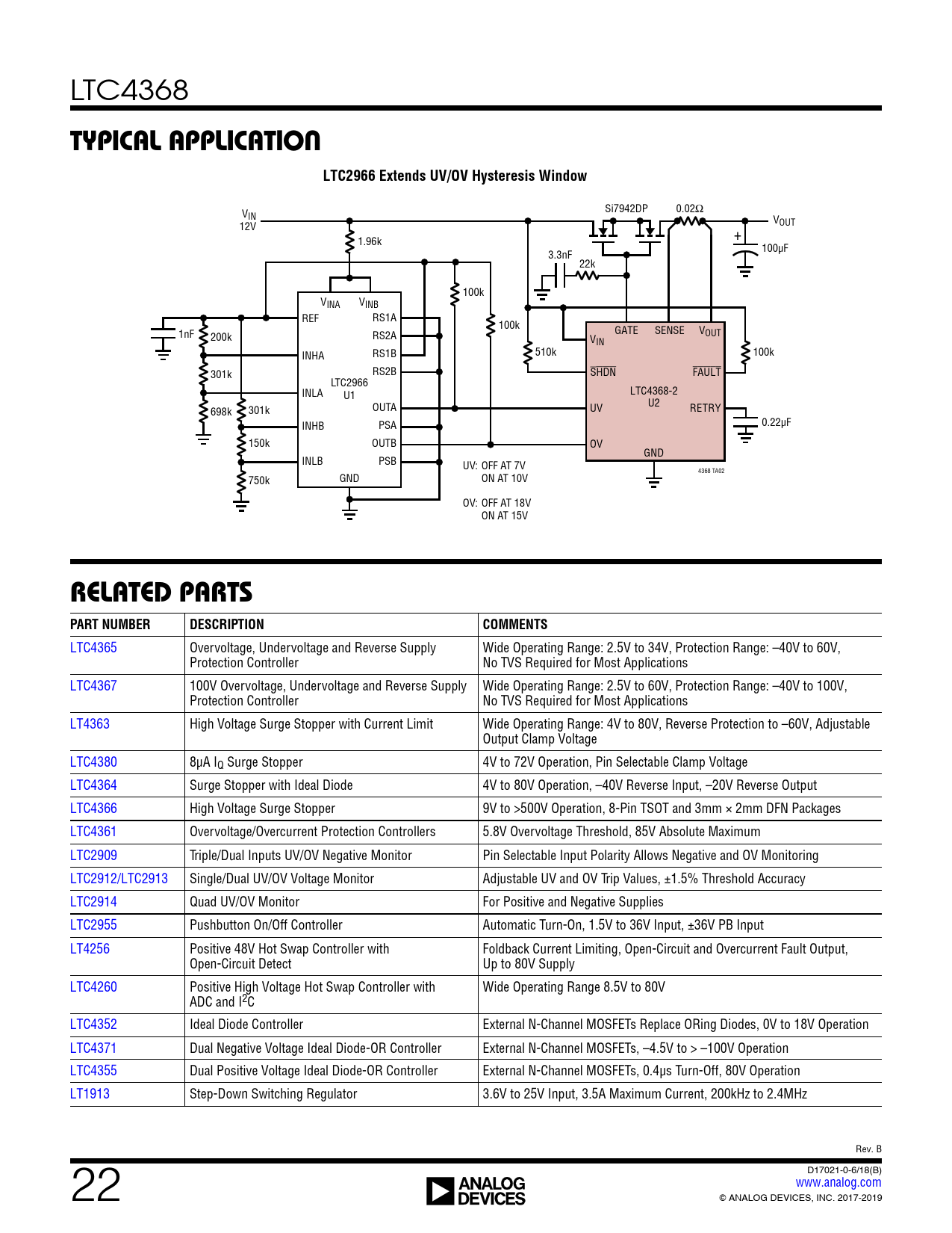

TYPICAL APPLICATION. LTC2966 Extends UV/OV Hysteresis Window. RELATED PARTS PART NUMBER. DESCRIPTION. COMMENTS
TYPICAL APPLICATION LTC2966 Extends UV/OV Hysteresis Window RELATED PARTS PART NUMBER DESCRIPTION COMMENTS
LTC4368
V Si7942DP 0.02Ω IN V 12V OUT 1.96k + 100µF 3.3nF 22k 100k VINA VINB REF RS1A 100k 1nF 200k RS2A GATE SENSE VOUT VIN INHA RS1B 510k 100k 301k RS2B SHDN FAULT LTC2966 INLA U1 LTC4368-2 U2 698k 301k OUTA UV RETRY INHB PSA 0.22µF 150k OUTB OV GND INLB PSB UV: OFF AT 7V 4368 TA02 750k GND ON AT 10V OV: OFF AT 18V ON AT 15V
