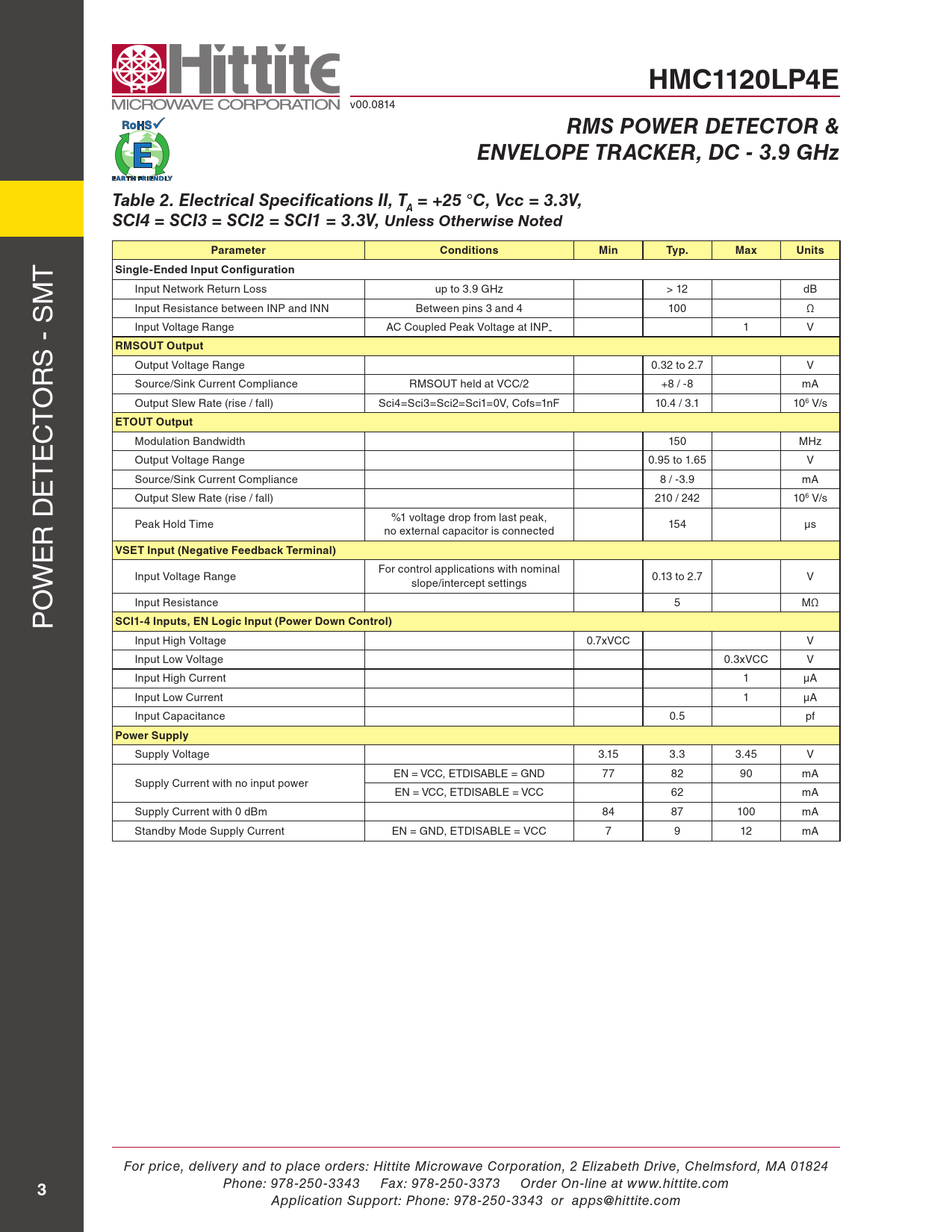

RMS POWER DETECTOR & ENVELOPE TRACKER, DC - 3.9 GHz Table 2. Electrical Specifications ii, T = +25 °C, Vcc = 3.3V, A SCi4 = SCi3 = SCi2 = SCi1 = 3.3V, Unless Otherwise Noted Parameter Conditions Min Typ. Max Units
T
Single-Ended Input Configuration
M Input Network Return Loss up to 3.9 GHz > 12 dB S Input Resistance between INP and INN Between pins 3 and 4 100 Ω - Input Voltage Range AC Coupled Peak Voltage at INP- 1 V
RMSOUT Output
RS Output Voltage Range 0.32 to 2.7 V O Source/Sink Current Compliance RMSOUT held at VCC/2 +8 / -8 mA T Output Slew Rate (rise / fall) Sci4=Sci3=Sci2=Sci1=0V, Cofs=1nF 10.4 / 3.1 106 V/s C
ETOUT Output
E Modulation Bandwidth 150 MHz T Output Voltage Range 0.95 to 1.65 V E Source/Sink Current Compliance 8 / -3.9 mA Output Slew Rate (rise / fall) 210 / 242 106 V/s D %1 voltage drop from last peak, R Peak Hold Time 154 μs no external capacitor is connected E
VSET Input (Negative Feedback Terminal)
W For control applications with nominal Input Voltage Range 0.13 to 2.7 V slope/intercept settings O Input Resistance 5 MΩ P
SCI1-4 Inputs, EN Logic Input (Power Down Control)
Input High Voltage 0.7xVCC V Input Low Voltage 0.3xVCC V Input High Current 1 μA Input Low Current 1 μA Input Capacitance 0.5 pf
Power Supply
Supply Voltage 3.15 3.3 3.45 V EN = VCC, ETDISABLE = GND 77 82 90 mA Supply Current with no input power EN = VCC, ETDISABLE = VCC 62 mA Supply Current with 0 dBm 84 87 100 mA Standby Mode Supply Current EN = GND, ETDISABLE = VCC 7 9 12 mA For price, delivery and to place orders: Hittite Microwave Corporation, 2 Elizabeth Drive, Chelmsford, MA 01824 Phone: 978-250-3343 Fax: 978-250-3373 Order On-line at www.hittite.com
