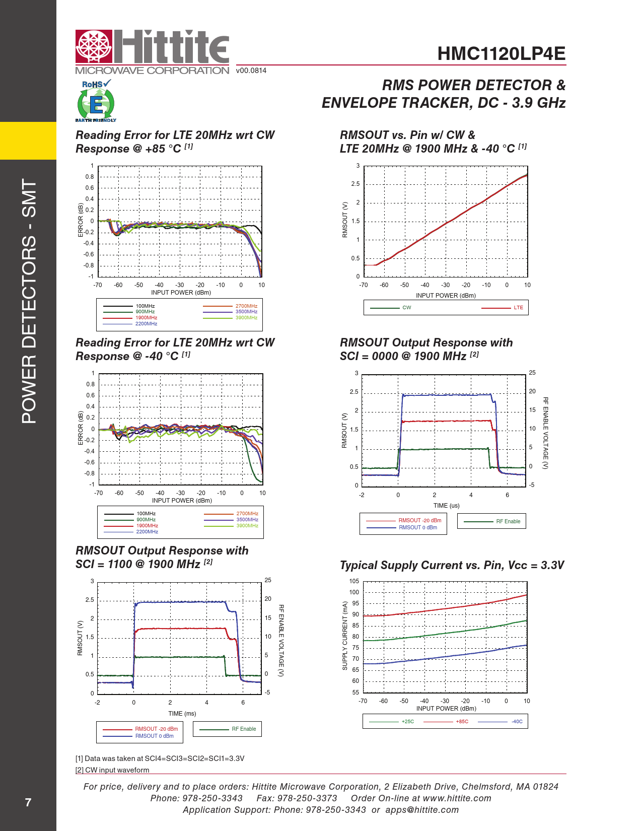

HMC1120LP4E. RMS POWER DETECTOR &. ENVELOPE TRACKER, DC - 3.9 GHz. Reading Error for LTE 20MHz wrt CW
HMC1120LP4E RMS POWER DETECTOR & ENVELOPE TRACKER, DC - 3.9 GHz Reading Error for LTE 20MHz wrt CW
HMC1120LP4E
v00.0814
RMS POWER DETECTOR & ENVELOPE TRACKER, DC - 3.9 GHz Reading Error for LTE 20MHz wrt CW RMSOUT vs. Pin w/ CW & Response @ +85 °C [1] LTE 20MHz @ 1900 MHz & -40 °C [1]
1 3 T 0.8 0.6 2.5 M 0.4 2 S 0.2 - 0 1.5 -0.2 ERROR (dB) RMSOUT (V) -0.4 1 RS -0.6 O 0.5 -0.8 T -1 0 C -70 -60 -50 -40 -30 -20 -10 0 10 -70 -60 -50 -40 -30 -20 -10 0 10 INPUT POWER (dBm) E INPUT POWER (dBm) T 100MHz 2700MHz CW LTE 900MHz 3500MHz 1900MHz 3900MHz E 2200MHz D
Reading Error for LTE 20MHz wrt CW RMSOUT Output Response with
R
Response @ -40 °C [1] SCi = 0000 @ 1900 MHz [2]
E 1 3 25 W 0.8 2.5 20 O 0.6 RF ENABLE VOLTAGE (V) 0.4 P 2 15 0.2 0 1.5 10 -0.2 ERROR (dB) RMSOUT (V) -0.4 1 5 -0.6 0.5 0 -0.8 -1 0 -5 -70 -60 -50 -40 -30 -20 -10 0 10 -2 0 2 4 6 INPUT POWER (dBm) TIME (us) 100MHz 2700MHz 900MHz 3500MHz RMSOUT -20 dBm RF Enable 1900MHz 3900MHz RMSOUT 0 dBm 2200MHz
RMSOUT Output Response with SCi = 1100 @ 1900 MHz [2] Typical Supply Current vs. Pin, Vcc = 3.3V
3 25 105 100 2.5 20 RF ENABLE VOLTAGE (V) 95 90 2 15 85 1.5 10 80 75 RMSOUT (V) 1 5 70 SUPPLY CURRENT (mA) 65 0.5 0 60 0 -5 55 -2 0 2 4 6 -70 -60 -50 -40 -30 -20 -10 0 10 INPUT POWER (dBm) TIME (ms) +25C +85C -40C RMSOUT -20 dBm RF Enable RMSOUT 0 dBm [1] Data was taken at SCI4=SCI3=SCI2=SCI1=3.3V [2] CW input waveform For price, delivery and to place orders: Hittite Microwave Corporation, 2 Elizabeth Drive, Chelmsford, MA 01824 Phone: 978-250-3343 Fax: 978-250-3373 Order On-line at www.hittite.com
