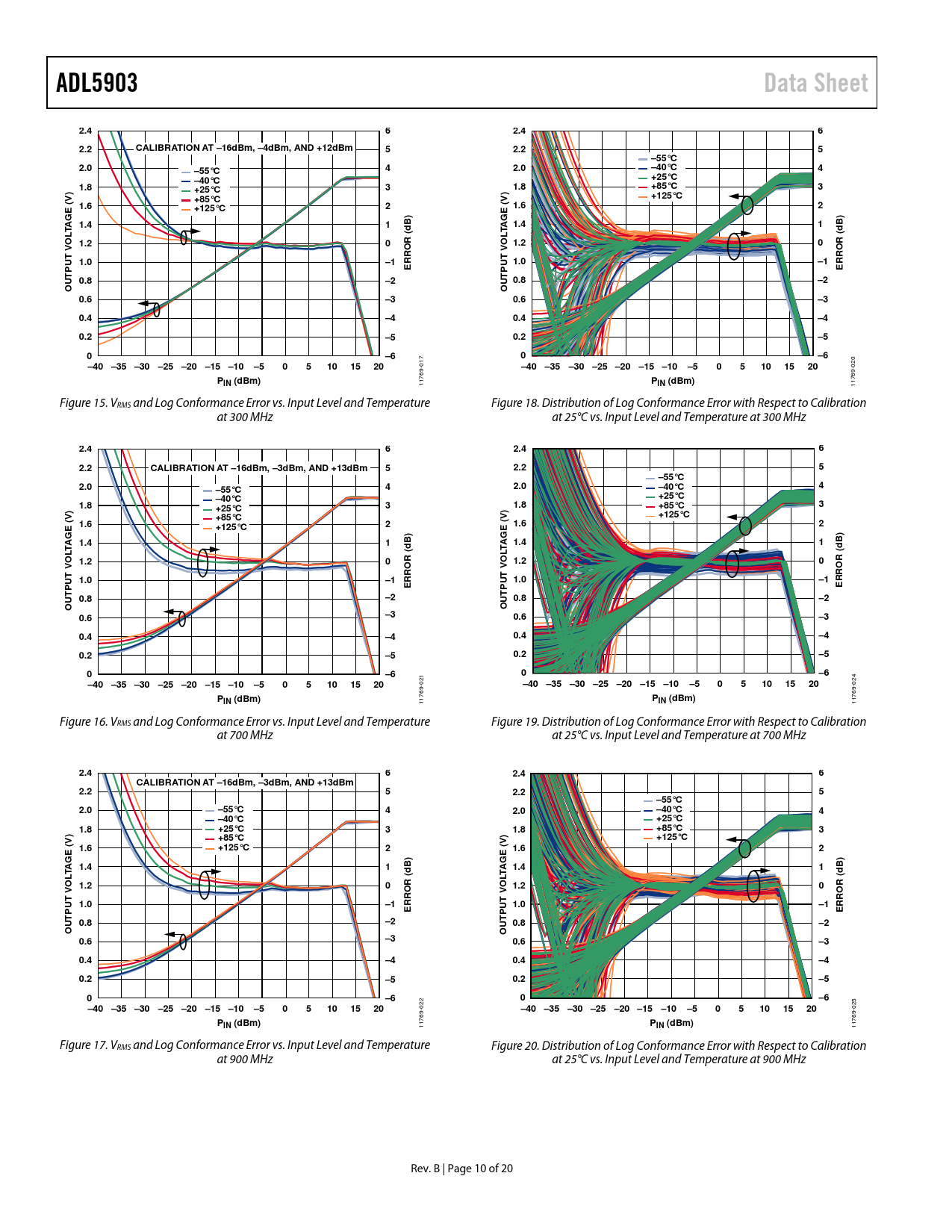

ADL5903. Data Sheet. 2.4. 2.2. CALIBRATION AT –16dBm, –4dBm, AND +12dBm. –55°C. 2.0. –40°C. +25°C. 1.8. +85°C. +125°C. 1.6. E (V). A 1.4. O 1.2. R (. T V
ADL5903 Data Sheet 2.4 2.2 CALIBRATION AT –16dBm, –4dBm, AND +12dBm –55°C 2.0 –40°C +25°C 1.8 +85°C +125°C 1.6 E (V) A 1.4 O 1.2 R ( T V
ADL5903 Data Sheet 2.4 6 2.4 6 2.2 CALIBRATION AT –16dBm, –4dBm, AND +12dBm 5 2.2 5 –55°C 2.0 4 –55°C 2.0 –40°C 4 –40°C +25°C 1.8 3 +25°C 1.8 +85°C 3 +85°C +125°C 1.6 2 1.6 2 E (V) +125°C E (V) G G A 1.4 1 B) B) d A 1.4 1 d LT LT O 1.2 0 R ( O 1.2 0 R ( T V T V U 1.0 –1 RRO U 1.0 –1 RRO E E TP TP 0.8 –2 0.8 –2 OU OU 0.6 –3 0.6 –3 0.4 –4 0.4 –4 0.2 –5 0.2 –5 0 –6 0 –6 –40 –35 –30 –25 –20 –15 –10 –5 0 5 10 15 20

11769- Figure 15. VRMS and Log Conformance Error vs. Input Level and Temperature Figure 18. Distribution of Log Conformance Error with Respect to Calibration at 300 MHz at 25°C vs. Input Level and Temperature at 300 MHz
2.4 6 2.4 6 2.2 CALIBRATION AT –16dBm, –3dBm, AND +13dBm 5 2.2 5 –55°C 2.0 4 –55°C 2.0 –40°C 4 –40°C +25°C 1.8 3 +25°C 1.8 +85°C 3 +85°C +125°C 1.6 2 1.6 2 E (V) +125°C E (V) G G A 1.4 1 B) B) d A 1.4 1 d LT LT O 1.2 0 R ( O 1.2 0 R ( T V T V U 1.0 –1 RRO U 1.0 –1 RRO E E TP TP 0.8 –2 0.8 –2 OU OU 0.6 –3 0.6 –3 0.4 –4 0.4 –4 0.2 –5 0.2 –5 0 –6 0 –6 –40 –35 –30 –25 –20 –15 –10 –5 0 5 10 15 20

11769- Figure 16. VRMS and Log Conformance Error vs. Input Level and Temperature Figure 19. Distribution of Log Conformance Error with Respect to Calibration at 700 MHz at 25°C vs. Input Level and Temperature at 700 MHz
2.4 6 2.4 6 CALIBRATION AT –16dBm, –3dBm, AND +13dBm 2.2 5 2.2 5 –55°C 2.0 –55°C 4 2.0 –40°C 4 –40°C +25°C 1.8 +25°C 3 1.8 +85°C 3 +85°C +125°C 1.6 +125°C 2 1.6 2 E (V) E (V) G G A 1.4 1 B) B) d A 1.4 1 d LT LT O 1.2 0 R ( O 1.2 0 R ( T V T V U 1.0 –1 RRO U 1.0 –1 RRO E E TP TP 0.8 –2 0.8 –2 OU OU 0.6 –3 0.6 –3 0.4 –4 0.4 –4 0.2 –5 0.2 –5 0 –6 0 –6 –40 –35 –30 –25 –20 –15 –10 –5 0 5 10 15 20

11769- Figure 17. VRMS and Log Conformance Error vs. Input Level and Temperature Figure 20. Distribution of Log Conformance Error with Respect to Calibration at 900 MHz at 25°C vs. Input Level and Temperature at 900 MHz Rev. B | Page 10 of 20 Document Outline FEATURES APPLICATIONS FUNCTIONAL BLOCK DIAGRAM GENERAL DESCRIPTION TABLE OF CONTENTS REVISION HISTORY SPECIFICATIONS ABSOLUTE MAXIMUM RATINGS ESD CAUTION PIN CONFIGURATION AND FUNCTION DESCRIPTIONS TYPICAL PERFORMANCE CHARACTERISTICS MEASUREMENT SETUPS THEORY OF OPERATION RF INPUT INTERFACE BASIC CONNECTIONS CHOOSING A VALUE FOR CRMS DEVICE CALIBRATION AND ERROR CALCULATION EVALUATION BOARD SCHEMATIC AND CONFIGURATION OPTIONS OUTLINE DIMENSIONS ORDERING GUIDE
