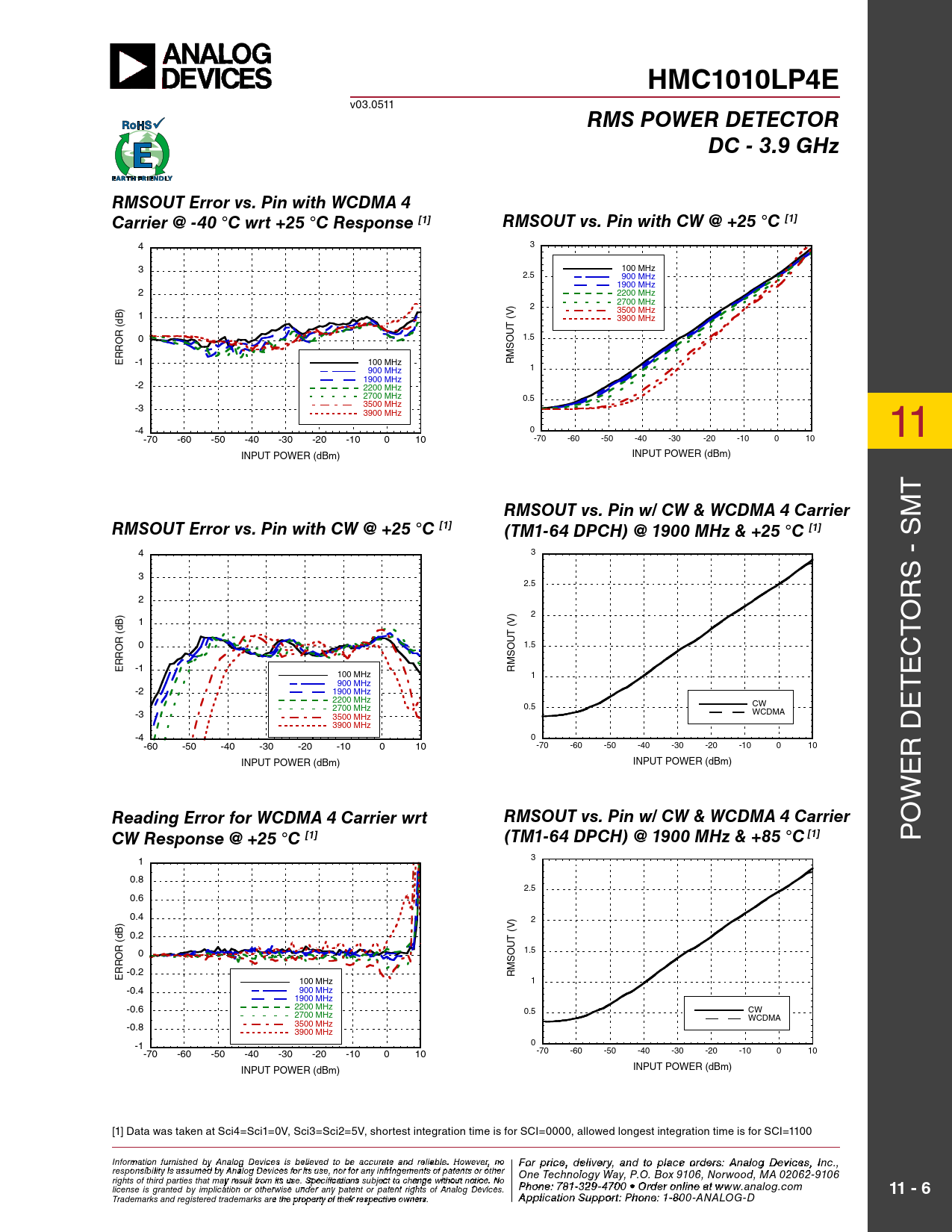

DescriptionRMS Power Detector SMT, DC - 3.9 GHz
Pages / Page24 / 6 — HMC1010LP4E. RMS POWER DETECTOR. DC - 3.9 GHz. RMSOUT Error vs. Pin with …
File Format / SizePDF / 2.8 Mb
HMC1010LP4E. RMS POWER DETECTOR. DC - 3.9 GHz. RMSOUT Error vs. Pin with WCDMA 4 Carrier @ -40 °C wrt +25 °C Response [1]
HMC1010LP4E RMS POWER DETECTOR DC - 3.9 GHz RMSOUT Error vs Pin with WCDMA 4 Carrier @ -40 °C wrt +25 °C Response [1]
HMC1010LP4E
v03.0511
RMS POWER DETECTOR DC - 3.9 GHz RMSOUT Error vs. Pin with WCDMA 4 Carrier @ -40 °C wrt +25 °C Response [1] RMSOUT vs. Pin with CW @ +25 °C [1]
4 3 3 100 MHz 2.5 900 MHz 1900 MHz 2 2200 MHz 2 2700 MHz 1 3500 MHz (V) (dB) 3900 MHz 0 1.5 ERROR -1 100 MHz RMSOUT 900 MHz 1 -2 1900 MHz 2200 MHz 2700 MHz 0.5 -3 3500 MHz 3900 MHz -4 0 -70 -60 -50 -40 -30 -20 -10 0 10 -70 -60 -50 -40 -30 -20 -10 0 10 11 INPUT POWER (dBm) INPUT POWER (dBm) t
RMSOUT vs. Pin w/ CW & WCDMA 4 Carrier
M
RMSOUT Error vs. Pin with CW @ +25 °C [1] (TM1-64 DPCH) @ 1900 MHz & +25 °C [1]
s 4 3 - 3 2.5 2 rs 2 1 o (V) (dB) t 0 1.5 c ERROR -1 RMSOUT 100 MHz 1 e 900 MHz -2 1900 MHz t 2200 MHz CW 2700 MHz 0.5 WCDMA e -3 3500 MHz 3900 MHz -4 0 D -60 -50 -40 -30 -20 -10 0 10 -70 -60 -50 -40 -30 -20 -10 0 10 r INPUT POWER (dBm) INPUT POWER (dBm) e w
Reading Error for WCDMA 4 Carrier wrt RMSOUT vs. Pin w/ CW & WCDMA 4 Carrier
o
CW Response @ +25 °C [1] (TM1-64 DPCH) @ 1900 MHz & +85 °C [1]
P 1 3 0.8 2.5 0.6 0.4 2 (V) 0.2 (dB) 0 1.5 -0.2 ERROR RMSOUT 100 MHz 1 -0.4 900 MHz 1900 MHz -0.6 2200 MHz CW 2700 MHz 0.5 WCDMA -0.8 3500 MHz 3900 MHz -1 0 -70 -60 -50 -40 -30 -20 -10 0 10 -70 -60 -50 -40 -30 -20 -10 0 10 INPUT POWER (dBm) INPUT POWER (dBm) [1] Data was taken at sci4=sci1=0V, sci3=sci2=5V, shortest integration time is for scI=0000, allowed longest integration time is for scI=1100 Info F rmoatr p ion rfiurcne is , d hed ebly ivAe n r al y a og D n evd t ice o p s is bla eli c eve o ed t rd o b e e ras: H ccuratite tiatne M d reli iac bl reo . w Ho av wev e C er, n o o For price, delivery, and to place orders: Analog Devices, Inc., responsibility is assumed by Analog Devices for its use, nor for any infringements of patents or other rporation, 20 Alpha Road, Chelmsford, MA 01824 One Technology Way, P.O. Box 9106, Norwood, MA 02062-9106 Phone: 978-250-3343 Fax: 978-250-3373 O rights of third parties that may result from its use. Specifications subject to change without notice. No P rd ho e ne r O : 7 n 81- -3li 2n 9 e a -47 t w 0 w 0 • O w rd .h e it r o tniltie n .c e ao t m license is granted by implication or otherwise under any patent or patent rights of Analog Devices. www.analog.com
