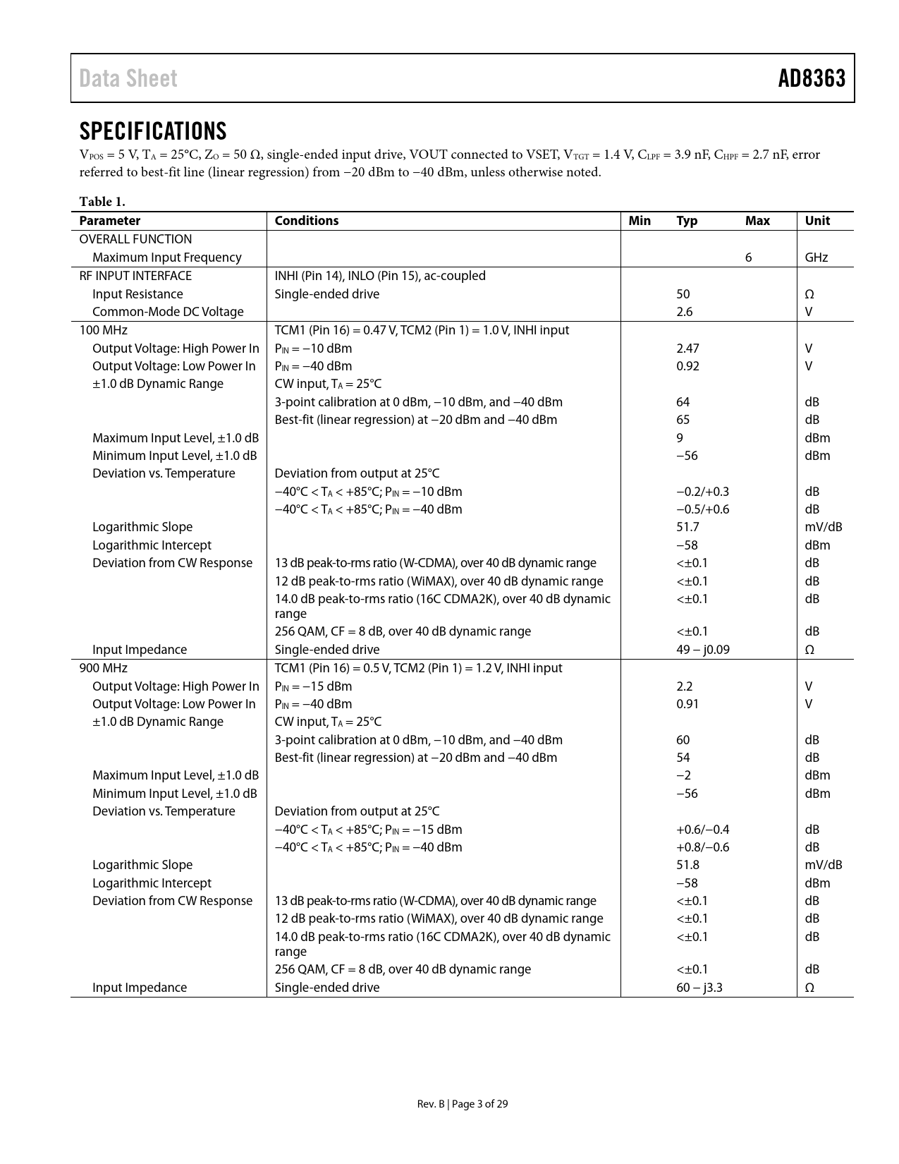

Data Sheet. AD8363. SPECIFICATIONS. Table 1. Parameter. Conditions. Min. Typ. Max. Unit
Data Sheet AD8363 SPECIFICATIONS Table 1 Parameter Conditions Min Typ Max Unit
VPOS = 5 V, TA = 25°C, ZO = 50 Ω, single-ended input drive, VOUT connected to VSET, VTGT = 1.4 V, CLPF = 3.9 nF, CHPF = 2.7 nF, error referred to best-fit line (linear regression) from −20 dBm to −40 dBm, unless otherwise noted.
Table 1. Parameter Conditions Min Typ Max Unit
OVERALL FUNCTION Maximum Input Frequency 6 GHz RF INPUT INTERFACE INHI (Pin 14), INLO (Pin 15), ac-coupled Input Resistance Single-ended drive 50 Ω Common-Mode DC Voltage 2.6 V 100 MHz TCM1 (Pin 16) = 0.47 V, TCM2 (Pin 1) = 1.0 V, INHI input Output Voltage: High Power In PIN = −10 dBm 2.47 V Output Voltage: Low Power In PIN = −40 dBm 0.92 V ±1.0 dB Dynamic Range CW input, TA = 25°C 3-point calibration at 0 dBm, −10 dBm, and −40 dBm 64 dB Best-fit (linear regression) at −20 dBm and −40 dBm 65 dB Maximum Input Level, ±1.0 dB 9 dBm Minimum Input Level, ±1.0 dB −56 dBm Deviation vs. Temperature Deviation from output at 25°C −40°C < TA < +85°C; PIN = −10 dBm −0.2/+0.3 dB −40°C < TA < +85°C; PIN = −40 dBm −0.5/+0.6 dB Logarithmic Slope 51.7 mV/dB Logarithmic Intercept −58 dBm Deviation from CW Response 13 dB peak-to-rms ratio (W-CDMA), over 40 dB dynamic range <±0.1 dB 12 dB peak-to-rms ratio (WiMAX), over 40 dB dynamic range <±0.1 dB 14.0 dB peak-to-rms ratio (16C CDMA2K), over 40 dB dynamic <±0.1 dB range 256 QAM, CF = 8 dB, over 40 dB dynamic range <±0.1 dB Input Impedance Single-ended drive 49 − j0.09 Ω 900 MHz TCM1 (Pin 16) = 0.5 V, TCM2 (Pin 1) = 1.2 V, INHI input Output Voltage: High Power In PIN = −15 dBm 2.2 V Output Voltage: Low Power In PIN = −40 dBm 0.91 V ±1.0 dB Dynamic Range CW input, TA = 25°C 3-point calibration at 0 dBm, −10 dBm, and −40 dBm 60 dB Best-fit (linear regression) at −20 dBm and −40 dBm 54 dB Maximum Input Level, ±1.0 dB −2 dBm Minimum Input Level, ±1.0 dB −56 dBm Deviation vs. Temperature Deviation from output at 25°C −40°C < TA < +85°C; PIN = −15 dBm +0.6/−0.4 dB −40°C < TA < +85°C; PIN = −40 dBm +0.8/−0.6 dB Logarithmic Slope 51.8 mV/dB Logarithmic Intercept −58 dBm Deviation from CW Response 13 dB peak-to-rms ratio (W-CDMA), over 40 dB dynamic range <±0.1 dB 12 dB peak-to-rms ratio (WiMAX), over 40 dB dynamic range <±0.1 dB 14.0 dB peak-to-rms ratio (16C CDMA2K), over 40 dB dynamic <±0.1 dB range 256 QAM, CF = 8 dB, over 40 dB dynamic range <±0.1 dB Input Impedance Single-ended drive 60 − j3.3 Ω Rev. B | Page 3 of 29 Document Outline FEATURES APPLICATIONS FUNCTIONAL BLOCK DIAGRAM GENERAL DESCRIPTION TABLE OF CONTENTS REVISION HISTORY SPECIFICATIONS ABSOLUTE MAXIMUM RATINGS ESD CAUTION PIN CONFIGURATION AND FUNCTION DESCRIPTIONS TYPICAL PERFORMANCE CHARACTERISTICS THEORY OF OPERATION SQUARE LAW DETECTOR AND AMPLITUDE TARGET RF INPUT INTERFACE CHOICE OF RF INPUT PIN SMALL SIGNAL LOOP RESPONSE TEMPERATURE SENSOR INTERFACE VREF INTERFACE TEMPERATURE COMPENSATION INTERFACE POWER-DOWN INTERFACE VSET INTERFACE OUTPUT INTERFACE VTGT INTERFACE MEASUREMENT MODE BASIC CONNECTIONS SYSTEM CALIBRATION AND ERROR CALCULATION OPERATION TO 125°C OUTPUT VOLTAGE SCALING OFFSET COMPENSATION, MINIMUM CLPF, AND MAXIMUM CHPF CAPACITANCE VALUES CHOOSING A VALUE FOR CLPF RF PULSE RESPONSE AND VTGT CONTROLLER MODE BASIC CONNECTIONS CONSTANT OUTPUT POWER OPERATION DESCRIPTION OF RF CHARACTERIZATION EVALUATION AND CHARACTERIZATION CIRCUIT BOARD LAYOUTS ASSEMBLY DRAWINGS OUTLINE DIMENSIONS ORDERING GUIDE
