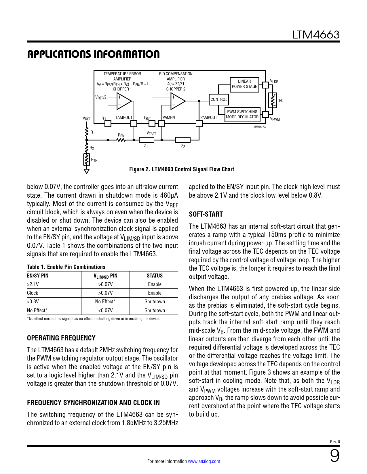

TEMPERATURE ERROR PID COMPENSATION AMPLIFIER AMPLIFIER LINEAR V A LDR V = RFB/(RTH + RX) – RFB /R +1 AV = Z2/Z1 POWER STAGE CHOPPER 1 CHOPPER 2 + VREF/2 + + CONTROL TEC – – – PWM SWITCHING TAMPOUT T MODE REGULATOR VREF TFB SET PAMPN PAMPOUT VPWM LTM4663 F02 R VTSET RFB R Z X 1 Z2 RTH
Figure 2. LTM4663 Control Signal Flow Chart
