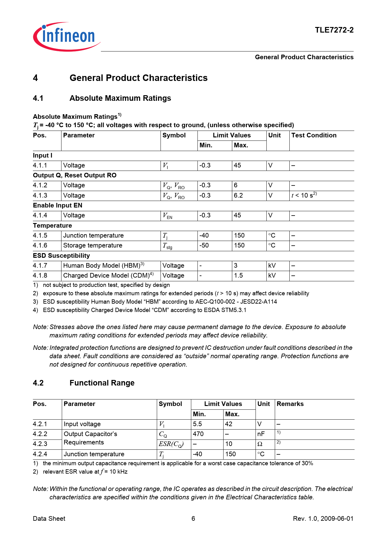

TLE7272-2. General Product Characteristics. 4.1. Absolute Maximum Ratings. Absolute Maximum Ratings1) T
TLE7272-2 General Product Characteristics 4.1 Absolute Maximum Ratings Absolute Maximum Ratings1) T
TLE7272-2 General Product Characteristics 4 General Product Characteristics 4.1 Absolute Maximum Ratings Absolute Maximum Ratings1) T j = -40 °C to 150 °C; all voltages with respect to ground, (unless otherwise specified) Pos. Parameter Symbol Limit Values Unit Test Condition Min. Max. Input I
4.1.1 Voltage VI -0.3 45 V –
Output Q, Reset Output RO
4.1.2 Voltage VQ, VRO -0.3 6 V – 4.1.3 Voltage VQ, VRO -0.3 6.2 V t < 10 s2)
Enable Input EN
4.1.4 Voltage V -0.3 45 V – EN
Temperature
4.1.5 Junction temperature Tj -40 150 °C – 4.1.6 Storage temperature Tstg -50 150 °C –
ESD Susceptibility
4.1.7 Human Body Model (HBM)3) Voltage - Voltage - 3 kV – 4.1.8 Charged Device Model (CDM)4) 1.5 kV – 1) not subject to production test, specified by design 2) exposure to these absolute maximum ratings for extended periods (t > 10 s) may affect device reliability 3) ESD susceptibility Human Body Model “HBM” according to AEC-Q100-002 - JESD22-A114 4) ESD susceptibility Charged Device Model “CDM” according to ESDA STM5.3.1 Note: Stresses above the ones listed here may cause permanent damage to the device. Exposure to absolute maximum rating conditions for extended periods may affect device reliability. Note: Integrated protection functions are designed to prevent IC destruction under fault conditions described in the data sheet. Fault conditions are considered as “outside” normal operating range. Protection functions are not designed for continuous repetitive operation.
4.2 Functional Range Pos. Parameter Symbol Limit Values Unit Remarks Min. Max.
4.2.1 Input voltage VI 5.5 42 V – 4.2.2 Output Capacitor’s CQ 470 – nF 1) Requirements 4.2.3 ESR(C ) Q – 10 Ω 2) 4.2.4 Junction temperature Tj -40 150 °C – 1) the minimum output capacitance requirement is applicable for a worst case capacitance tolerance of 30% 2) relevant ESR value at f = 10 kHz Note: Within the functional or operating range, the IC operates as described in the circuit description. The electrical characteristics are specified within the conditions given in the Electrical Characteristics table. Data Sheet 6 Rev. 1.0, 2009-06-01 Document Outline 1 Overview 2 Block Diagram 3 Pin Configuration 3.1 Pin Assignment PG-SSOP-14 Exposed Pad 3.2 Pin Definitions and Functions PG-SSOP-14 Exposed Pad 3.3 Pin Assignment PG-TO252-5 3.4 Pin Definitions and Functions PG-TO252-5 4 General Product Characteristics 4.1 Absolute Maximum Ratings 4.2 Functional Range 4.3 Thermal Resistance 5 Electrical Characteristics 5.1 Electrical Characteristics Voltage Regulator 5.2 Typical Performance Characteristics Voltage Regulator 5.3 Electrical Characteristics Enable Function 5.4 Typical Performance Characteristics Enable Function 5.5 Electrical Characteristics Reset Function 5.6 Typical Performance Characteristics Reset Function 6 Package Outlines 7 Revision History
