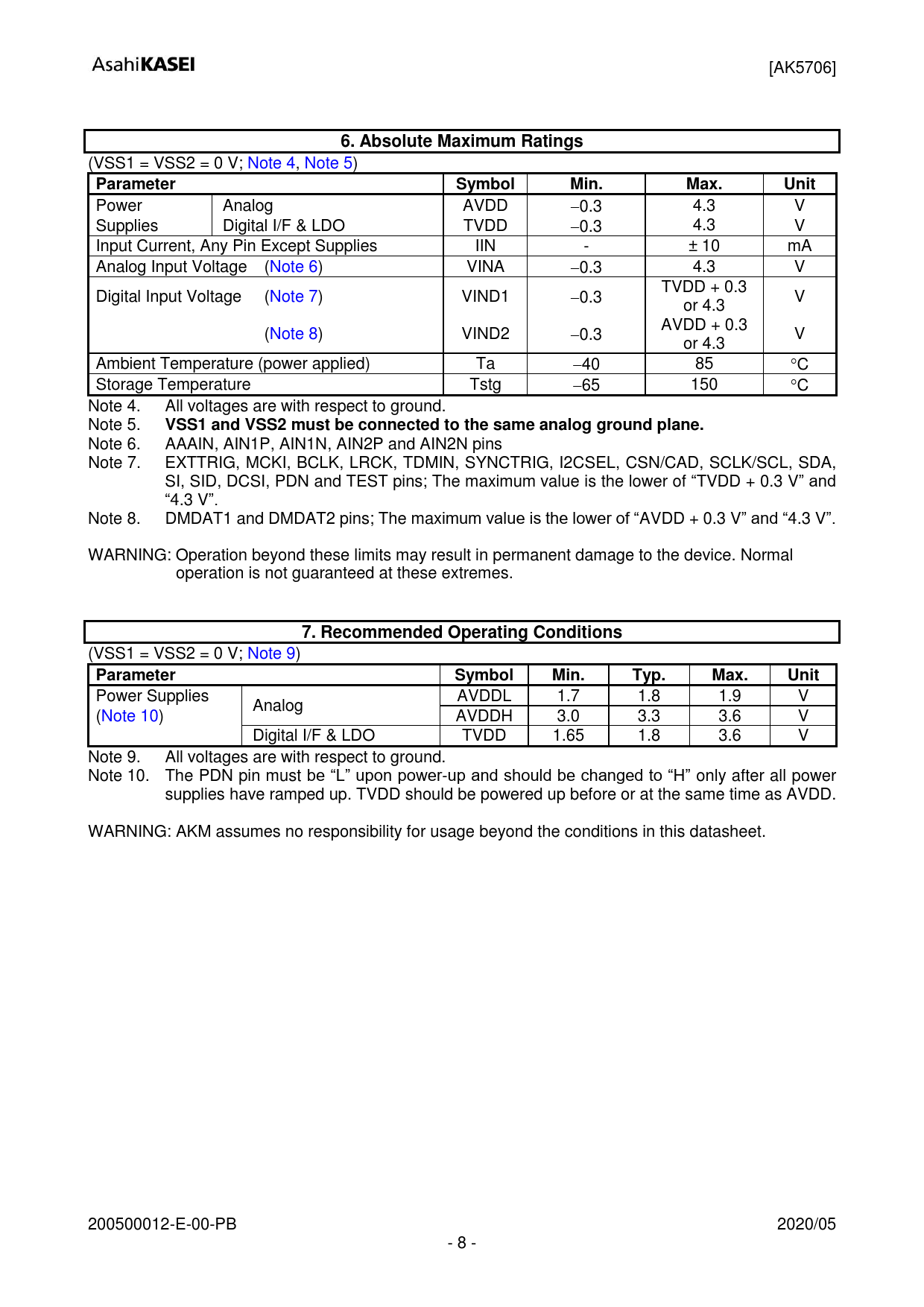

6. Absolute Maximum Ratings
(VSS1 = VSS2 = 0 V; Note 4, Note 5)
Parameter Symbol Min. Max. Unit
Power Analog AVDD −0.3 4.3 V Supplies Digital I/F & LDO TVDD −0.3 4.3 V Input Current, Any Pin Except Supplies IIN - ± 10 mA Analog Input Voltage (Note 6) VINA −0.3 4.3 V TVDD + 0.3 Digital Input Voltage (Note 7) VIND1 −0.3 V or 4.3 AVDD + 0.3 (Note 8) VIND2 −0.3 V or 4.3 Ambient Temperature (power applied) Ta −40 85 C Storage Temperature Tstg −65 150 C Note 4. All voltages are with respect to ground. Note 5.
VSS1 and VSS2 must be connected to the same analog ground plane.
Note 6. AAAIN, AIN1P, AIN1N, AIN2P and AIN2N pins Note 7. EXTTRIG, MCKI, BCLK, LRCK, TDMIN, SYNCTRIG, I2CSEL, CSN/CAD, SCLK/SCL, SDA, SI, SID, DCSI, PDN and TEST pins; The maximum value is the lower of “TVDD + 0.3 V” and “4.3 V”. Note 8. DMDAT1 and DMDAT2 pins; The maximum value is the lower of “AVDD + 0.3 V” and “4.3 V”. WARNING: Operation beyond these limits may result in permanent damage to the device. Normal operation is not guaranteed at these extremes.
7. Recommended Operating Conditions
(VSS1 = VSS2 = 0 V; Note 9)
Parameter Symbol Min. Typ. Max. Unit
Power Supplies AVDDL 1.7 1.8 1.9 V Analog (Note 10) AVDDH 3.0 3.3 3.6 V Digital I/F & LDO TVDD 1.65 1.8 3.6 V Note 9. All voltages are with respect to ground. Note 10. The PDN pin must be “L” upon power-up and should be changed to “H” only after all power supplies have ramped up. TVDD should be powered up before or at the same time as AVDD. WARNING: AKM assumes no responsibility for usage beyond the conditions in this datasheet. 200500012-E-00-PB 2020/05 - 8 - Document Outline 1. General Description 2. Features 3. Table of Contents 4. Block Diagram 5. Pin Configurations and Functions 5.1. Pin Configurations 5.2. Functions 5.3. Handling of Unused Pins 5.4. Pin State in Power-down Mode 6. Absolute Maximum Ratings 7. Recommended Operating Conditions 8. Electrical Characteristics 8.1. Microphone & ADC Analog Characteristics (AVDD = 3.3V: AVDDMD bit = “1”) 8.2. Microphone & ADC Analog Characteristics (AVDD = 1.8V: AVDDMD bit = “0”) 8.3. Acoustic Activity Analyzer Characteristics 8.4. PLL, AOSC Characteristics 8.5. LDO Characteristics 8.6. VCOM Characteristics 8.7. Power Supply Current 8.8. Power Consumption for Each Operation Mode (Typ.) 8.9. Filter Characteristics 8.9.1. Short Delay Sharp Roll-off Filter (ADVF bit = “0”) 8.9.2. Voice Filter (ADVF bit = “1”) 8.10. DC Characteristics 8.11. Switching Characteristics 9. Package 9.1. Outline Dimensions 9.2. Material & Lead finish 9.3. Marking 10. Ordering Guide 11. Revision History IMPORTANT NOTICE
