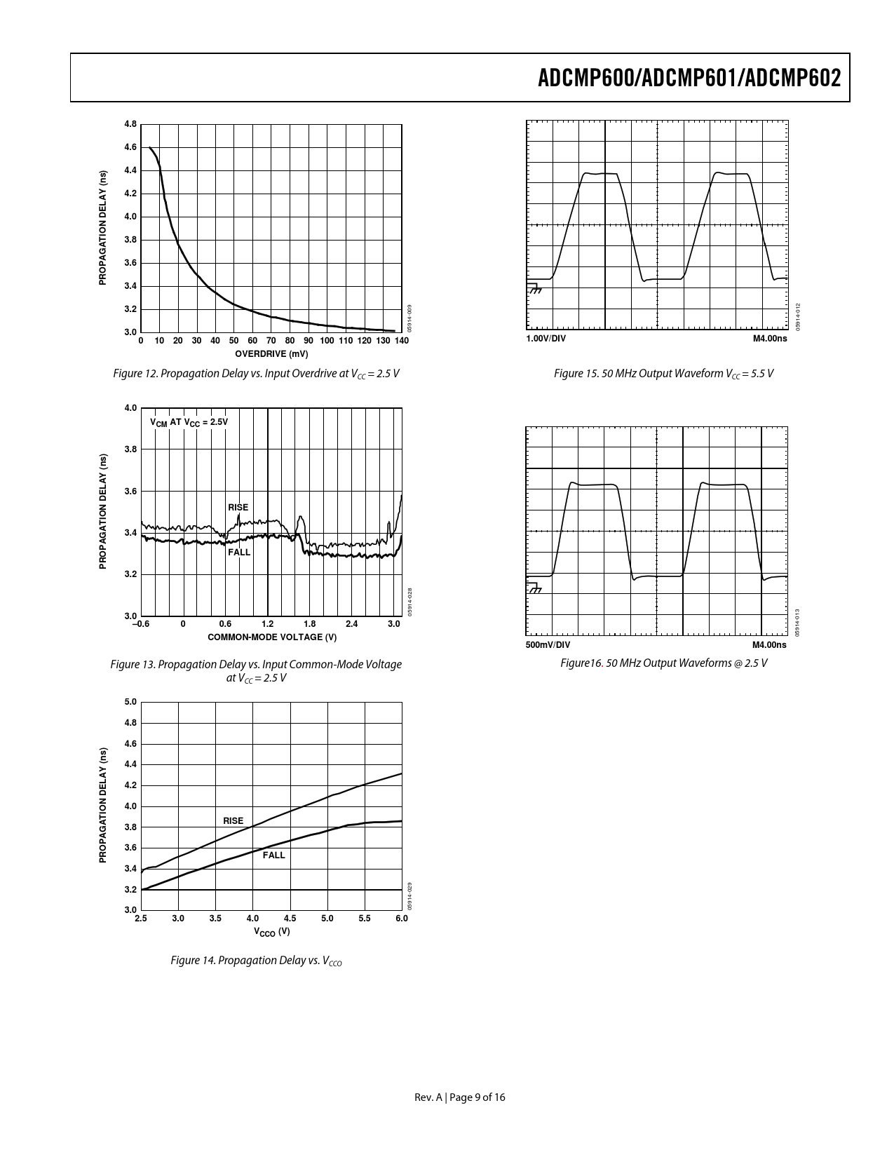

Model Line for this Datasheet Text Version of Document ADCMP600/ADCMP601/ADCMP602 4.8 4.6 4.4 s) n ( 4.2 AY L 4.0 N DE IO 3.8 AT AG P 3.6 RO P 3.4 3.2 009 0123.0 05914- 05914-0 10 20 30 40 50 60 70 80 90 100 110 120 130 140 1.00V/DIV M4.00ns OVERDRIVE (mV) Figure 12. Propagation Delay vs. Input Overdrive at VCC = 2.5 V Figure 15. 50 MHz Output Waveform VCC = 5.5 V4.0 VCM AT VCC = 2.5V 3.8 s) n ( AY L 3.6 N DE RISE IO AT 3.4 AG P FALL RO P 3.2 0283.0 05914- 013–0.6 0 0.6 1.2 1.8 2.4 3.0 COMMON-MODE VOLTAGE (V) 05914-500mV/DIV M4.00ns Figure 13. Propagation Delay vs. Input Common-Mode Voltage Figure16. 50 MHz Output Waveforms @ 2.5 V at VCC = 2.5 V5.0 4.8 4.6 s) n ( 4.4 AY L 4.2 N DE 4.0 IO AT RISE 3.8 AG P 3.6 RO FALL P 3.4 3.2 0293.0 05914-2.5 3.0 3.5 4.0 4.5 5.0 5.5 6.0 VCCO (V) Figure 14. Propagation Delay vs. VCCO Rev. A | Page 9 of 16 Document Outline Features Applications Functional Block Diagram General Description Revision History Specifications Electrical Characteristics Timing Information Absolute Maximum Ratings Thermal Resistance ESD Caution Pin Configuration and Function Descriptions Typical Performance Characteristics Application Information Power/Ground Layout and Bypassing TTL-/CMOS-Compatible Output Stage Using/Disabling the Latch Feature Optimizing Performance Comparator Propagation Delay Dispersion Comparator Hysteresis Crossover Bias Point Minimum Input Slew Rate Requirement Typical Application Circuits Outline Dimensions Ordering Guide
