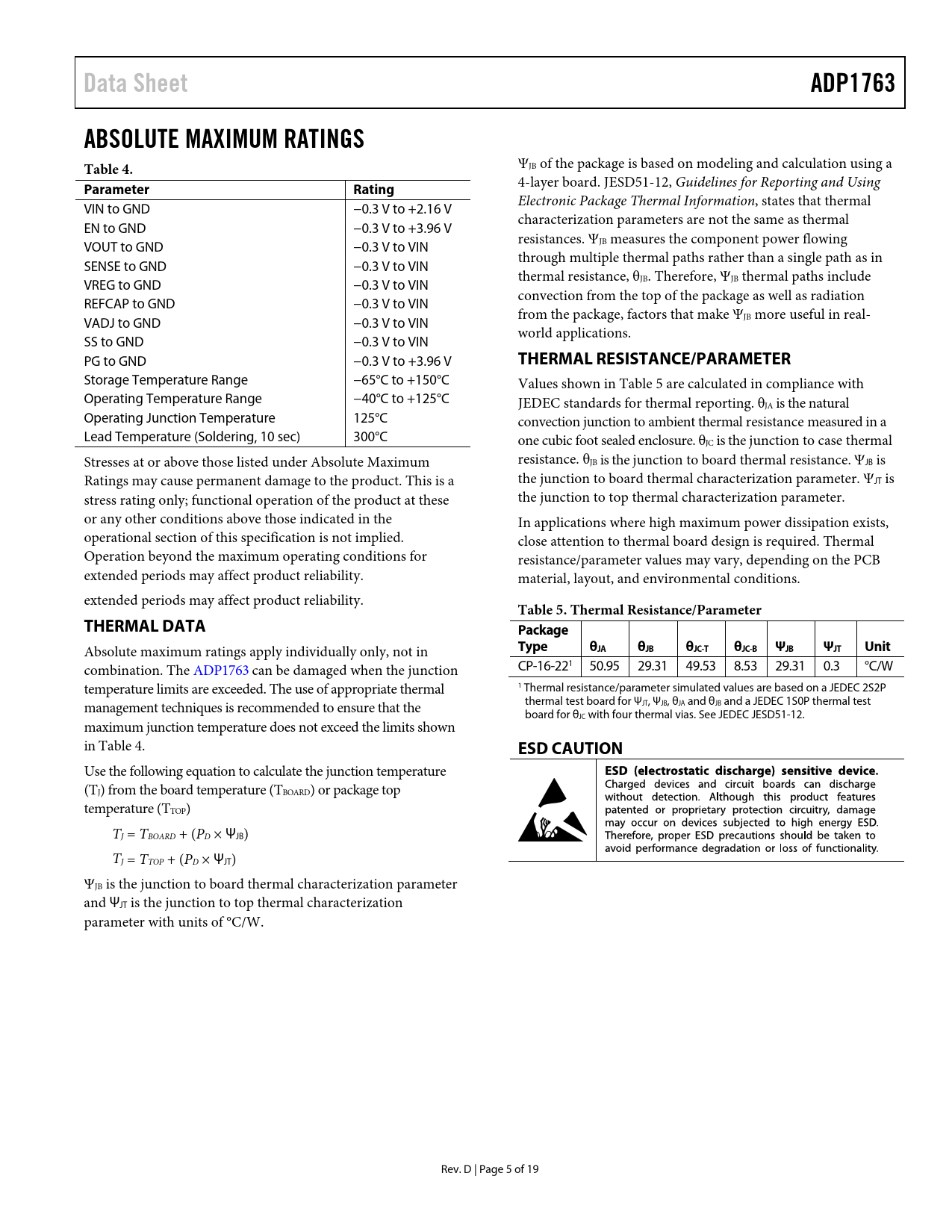

Data Sheet. ADP1763. ABSOLUTE MAXIMUM RATINGS Table 4. Parameter Rating. THERMAL RESISTANCE/PARAMETER
Data Sheet ADP1763 ABSOLUTE MAXIMUM RATINGS Table 4 Parameter Rating THERMAL RESISTANCE/PARAMETER
link to page 5 link to page 5
Data Sheet ADP1763 ABSOLUTE MAXIMUM RATINGS Table 4.
ΨJB of the package is based on modeling and calculation using a 4-layer board. JESD51-12, Guidelines for Reporting and Using
Parameter Rating
Electronic Package Thermal Information, states that thermal VIN to GND −0.3 V to +2.16 V characterization parameters are not the same as thermal EN to GND −0.3 V to +3.96 V resistances. Ψ VOUT to GND −0.3 V to VIN JB measures the component power flowing through multiple thermal paths rather than a single path as in SENSE to GND −0.3 V to VIN thermal resistance, θ VREG to GND −0.3 V to VIN JB. Therefore, ΨJB thermal paths include convection from the top of the package as well as radiation REFCAP to GND −0.3 V to VIN from the package, factors that make ΨJB more useful in real- VADJ to GND −0.3 V to VIN world applications. SS to GND −0.3 V to VIN PG to GND −0.3 V to +3.96 V
Storage Temperature Range −65°C to +150°C Values shown in Table 5 are calculated in compliance with Operating Temperature Range −40°C to +125°C JEDEC standards for thermal reporting. θJA is the natural Operating Junction Temperature 125°C convection junction to ambient thermal resistance measured in a Lead Temperature (Soldering, 10 sec) 300°C one cubic foot sealed enclosure. θJC is the junction to case thermal Stresses at or above those listed under Absolute Maximum resistance. θJB is the junction to board thermal resistance. ΨJB is Ratings may cause permanent damage to the product. This is a the junction to board thermal characterization parameter. ΨJT is stress rating only; functional operation of the product at these the junction to top thermal characterization parameter. or any other conditions above those indicated in the In applications where high maximum power dissipation exists, operational section of this specification is not implied. close attention to thermal board design is required. Thermal Operation beyond the maximum operating conditions for resistance/parameter values may vary, depending on the PCB extended periods may affect product reliability. material, layout, and environmental conditions. extended periods may affect product reliability.
Table 5. Thermal Resistance/Parameter THERMAL DATA Package
Absolute maximum ratings apply individually only, not in
Type θJA θJB θJC-T θJC-B ΨJB ΨJT Unit
combination. The ADP1763 can be damaged when the junction CP-16-221 50.95 29.31 49.53 8.53 29.31 0.3 °C/W temperature limits are exceeded. The use of appropriate thermal 1 Thermal resistance/parameter simulated values are based on a JEDEC 2S2P thermal test board for Ψ management techniques is recommended to ensure that the JT, ΨJB, θJA and θJB and a JEDEC 1S0P thermal test board for θJC with four thermal vias. See JEDEC JESD51-12. maximum junction temperature does not exceed the limits shown in Table 4.
ESD CAUTION
Use the following equation to calculate the junction temperature (TJ) from the board temperature (TBOARD) or package top temperature (TTOP) TJ = TBOARD + (PD × ΨJB) TJ = TTOP + (PD × ΨJT) ΨJB is the junction to board thermal characterization parameter and ΨJT is the junction to top thermal characterization parameter with units of °C/W. Rev. D | Page 5 of 19 Document Outline Features Applications General Description Typical Application Circuits Revision History Specifications Input and Output Capacitor: Recommended Specifications Absolute Maximum Ratings Thermal Data Thermal Resistance/Parameter ESD Caution Pin Configuration and Function Descriptions Typical Performance Characteristics Theory of Operation Soft Start Function Adjustable Output Voltage Enable Feature Power-Good (PG) Feature Applications Information Capacitor Selection Output Capacitor Input Bypass Capacitor Input and Output Capacitor Properties Undervoltage Lockout Current-Limit and Thermal Overload Protection Paralleling ADP1763 for High Current Applications Thermal Considerations PCB Layout Considerations Outline Dimensions Ordering Guide
