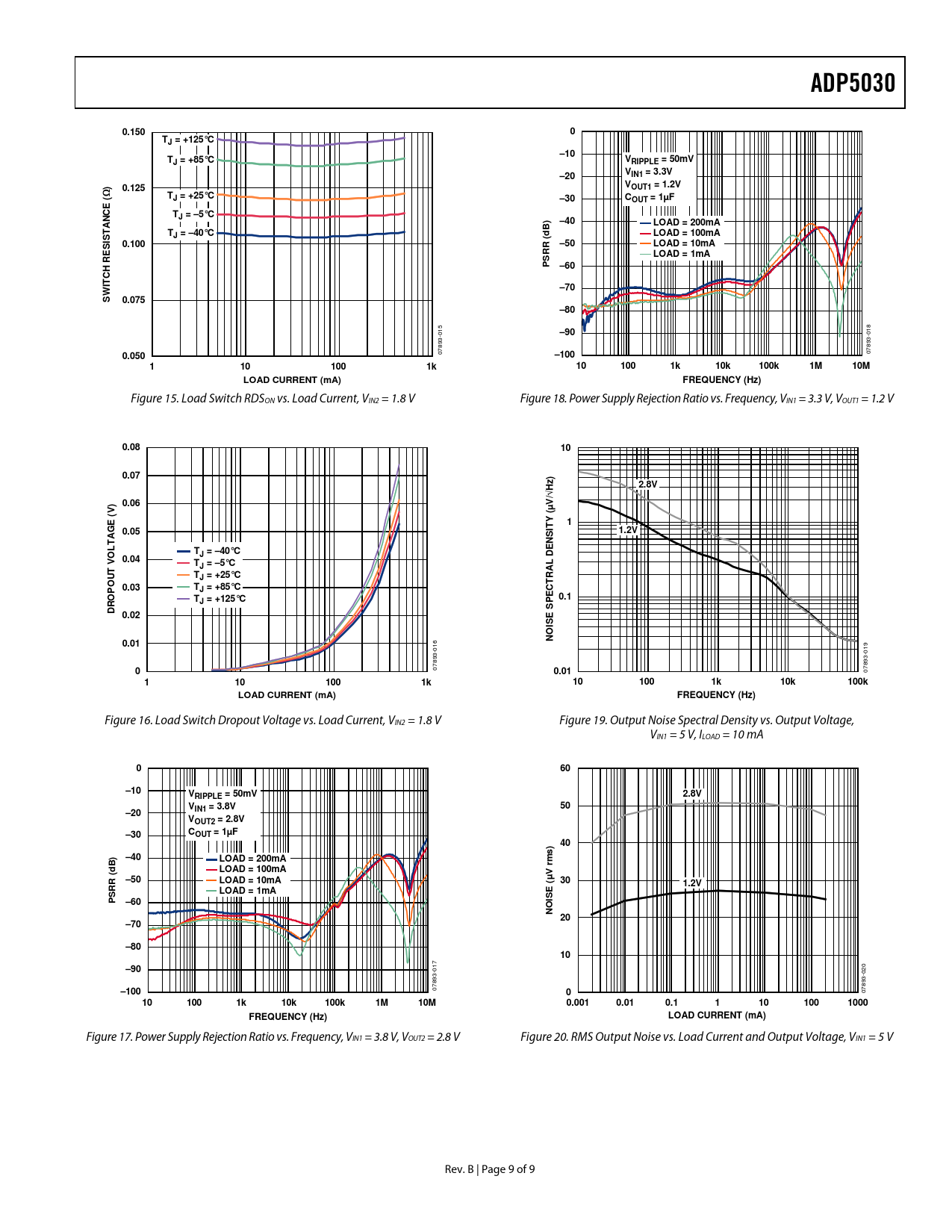

ADP5030. 0.150. TJ = +125°C. –10. J = +85°C. RIPPLE = 50mV. –20. IN1 = 3.3V. 0.125. VOUT1 = 1.2V. Ω (. TJ = +25°C. –30. COUT = 1µF. TJ = –5°C. –40
ADP5030 0.150 TJ = +125°C –10 J = +85°C RIPPLE = 50mV –20 IN1 = 3.3V 0.125 VOUT1 = 1.2V Ω ( TJ = +25°C –30 COUT = 1µF TJ = –5°C –40
ADP5030 0.150 0 TJ = +125°C –10 T V J = +85°C RIPPLE = 50mV V –20 IN1 = 3.3V ) 0.125 VOUT1 = 1.2V Ω ( TJ = +25°C –30 COUT = 1µF CE TJ = –5°C –40 AN LOAD = 200mA B) T TJ = –40°C d LOAD = 100mA IS 0.100 S –50 R ( LOAD = 10mA R S LOAD = 1mA P H RE –60 C IT –70 W S 0.075 –80

Figure 15. Load Switch RDSON vs. Load Current, VIN2 = 1.8 V Figure 18. Power Supply Rejection Ratio vs. Frequency, VIN1 = 3.3 V, VOUT1 = 1.2 V

Figure 16. Load Switch Dropout Voltage vs. Load Current, VIN2 = 1.8 V Figure 19. Output Noise Spectral Density vs. Output Voltage, VIN1 = 5 V, ILOAD = 10 mA

Figure 17. Power Supply Rejection Ratio vs. Frequency, VIN1 = 3.8 V, VOUT2 = 2.8 V Figure 20. RMS Output Noise vs. Load Current and Output Voltage, VIN1 = 5 V Rev. B | Page 9 of 9 Document Outline FEATURES APPLICATIONS GENERAL DESCRIPTION FUNCTIONAL BLOCK DIAGRAM TABLE OF CONTENTS REVISION HISTORY SPECIFICATIONS INPUT AND OUTPUT CAPACITOR, RECOMMENDED SPECIFICATIONS ABSOLUTE MAXIMUM RATINGS THERMAL DATA THERMAL RESISTANCE ESD CAUTION PIN CONFIGURATION AND FUNCTION DESCRIPTIONS TYPICAL PERFORMANCE CHARACTERISTICS THEORY OF OPERATION APPLICATIONS INFORMATION LDO2 AND LOAD SWITCH ACTIVATION LOGIC SEQUENCING CAPACITOR SELECTION Output Capacitor Input Bypass Capacitor Input and Output Capacitor Properties UNDERVOLTAGE LOCKOUT ENABLE FEATURE CURRENT-LIMIT AND THERMAL OVERLOAD PROTECTION THERMAL CONSIDERATIONS PCB LAYOUT CONSIDERATIONS OUTLINE DIMENSIONS ORDERING GUIDE
