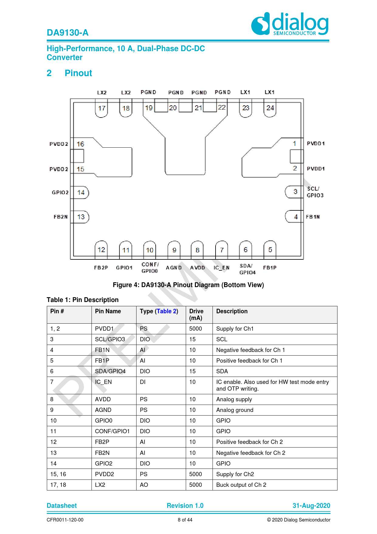

DA9130-A. High-Performance, 10 A, Dual-Phase DC-DC. Converter. Pinout. Figure 4: DA9130-A Pinout Diagram (Bottom View)
DA9130-A High-Performance, 10 A, Dual-Phase DC-DC Converter Pinout Figure 4: DA9130-A Pinout Diagram (Bottom View)
link to page 9
DA9130-A High-Performance, 10 A, Dual-Phase DC-DC Converter 2 Pinout Figure 4: DA9130-A Pinout Diagram (Bottom View) Table 1: Pin Description Pin # Pin Name Type (Table 2) Drive Description (mA)
1, 2 PVDD1 PS 5000 Supply for Ch1 3 SCL/GPIO3 DIO 15 SCL 4 FB1N AI 10 Negative feedback for Ch 1 5 FB1P AI 10 Positive feedback for Ch 1 6 SDA/GPIO4 DIO 15 SDA 7 IC_EN DI 10 IC enable. Also used for HW test mode entry and OTP writing. 8 AVDD PS 10 Analog supply 9 AGND PS 10 Analog ground 10 GPIO0 DIO 10 GPIO 11 CONF/GPIO1 DIO 10 GPIO 12 FB2P AI 10 Positive feedback for Ch 2 13 FB2N AI 10 Negative feedback for Ch 2 14 GPIO2 DIO 10 GPIO 15, 16 PVDD2 PS 5000 Supply for Ch2 17, 18 LX2 AO 5000 Buck output of Ch 2
