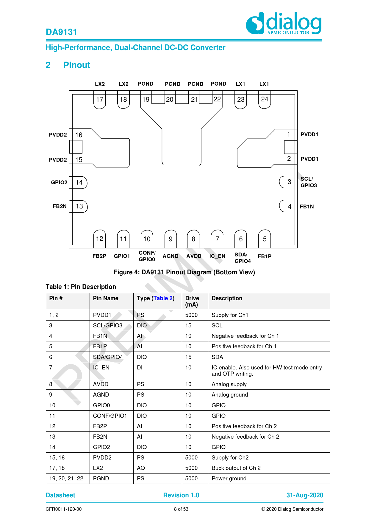

Datasheet DA9131 (Dialog Semiconductor) - 8
ManufacturerDialog Semiconductor
DescriptionHigh-Performance, Dual-Channel DC-DC Converter
Pages / Page53 / 8 — DA9131. High-Performance, Dual-Channel DC-DC Converter. Pinout. LX2. …
DA9131. High-Performance, Dual-Channel DC-DC Converter. Pinout. LX2. PGND. LX1. PVDD2. PVDD1. SCL/. GPIO2. GPIO3. FB2N. FB1N. CONF/. SDA/. FB2P. GPIO1
DA9131 High-Performance, Dual-Channel DC-DC Converter Pinout LX2 PGND LX1 PVDD2 PVDD1 SCL/ GPIO2 GPIO3 FB2N FB1N CONF/ SDA/ FB2P GPIO1
link to page 9
DA9131 High-Performance, Dual-Channel DC-DC Converter 2 Pinout LX2 LX2 PGND PGND PGND PGND LX1 LX1
17 18 19 20 21 22 23 24
PVDD2
16 1
PVDD1 PVDD2
15 2
PVDD1 SCL/ GPIO2
14 3
GPIO3 FB2N
13 4
FB1N
12 11 10 9 8 7 6 5
CONF/ SDA/ FB2P GPIO1 AGND AVDD IC_EN FB1P GPIO0 GPIO4 Figure 4: DA9131 Pinout Diagram (Bottom View) Table 1: Pin Description Pin # Pin Name Type (Table 2) Drive Description (mA)
1, 2 PVDD1 PS 5000 Supply for Ch1 3 SCL/GPIO3 DIO 15 SCL 4 FB1N AI 10 Negative feedback for Ch 1 5 FB1P AI 10 Positive feedback for Ch 1 6 SDA/GPIO4 DIO 15 SDA 7 IC_EN DI 10 IC enable. Also used for HW test mode entry and OTP writing. 8 AVDD PS 10 Analog supply 9 AGND PS 10 Analog ground 10 GPIO0 DIO 10 GPIO 11 CONF/GPIO1 DIO 10 GPIO 12 FB2P AI 10 Positive feedback for Ch 2 13 FB2N AI 10 Negative feedback for Ch 2 14 GPIO2 DIO 10 GPIO 15, 16 PVDD2 PS 5000 Supply for Ch2 17, 18 LX2 AO 5000 Buck output of Ch 2 19, 20, 21, 22 PGND PS 5000 Power ground
