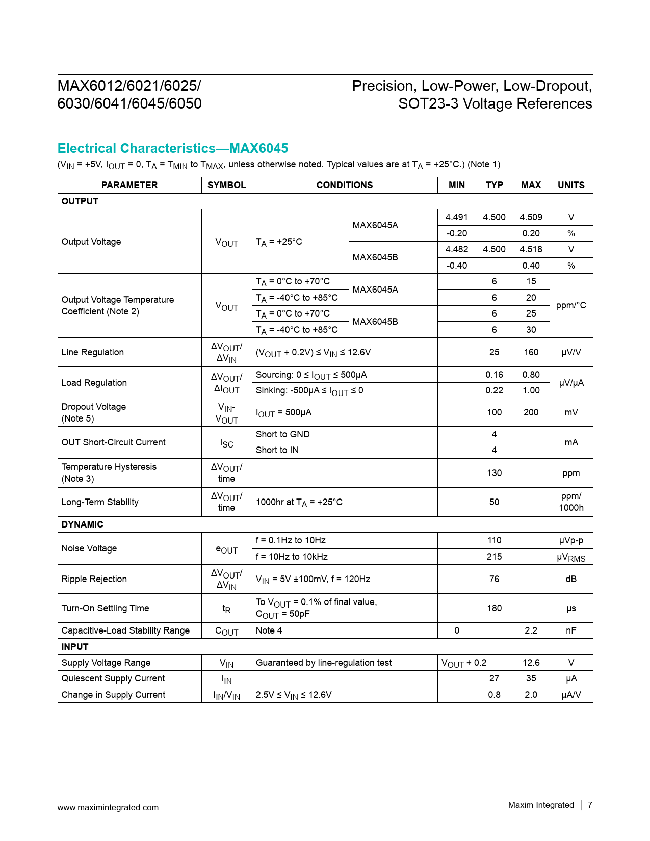

Electrical Characteristics—MAX6045
(VIN = +5V, IOUT = 0, TA = TMIN to TMAX, unless otherwise noted. Typical values are at TA = +25°C.) (Note 1)
PARAMETER SYMBOL CONDITIONS MIN TYP MAX UNITS OUTPUT
4.491 4.500 4.509 V MAX6045A -0.20 0.20 % Output Voltage VOUT TA = +25°C 4.482 4.500 4.518 V MAX6045B -0.40 0.40 % TA = 0°C to +70°C 6 15 MAX6045A Output Voltage Temperature TA = -40°C to +85°C 6 20 Coefficient (Note 2) VOUT ppm/°C TA = 0°C to +70°C 6 25 MAX6045B TA = -40°C to +85°C 6 30 Line Regulation ΔVOUT/ ΔV (VOUT + 0.2V) ≤ VIN ≤ 12.6V 25 160 μV/V IN Sourcing: 0 ≤ I Load Regulation ΔVOUT/ OUT ≤ 500μA 0.16 0.80 ΔI μV/μA OUT Sinking: -500μA ≤ IOUT ≤ 0 0.22 1.00 Dropout Voltage VIN- (Note 5) V IOUT = 500μA 100 200 mV OUT Short to GND 4 OUT Short-Circuit Current ISC mA Short to IN 4 Temperature Hysteresis ΔVOUT/ (Note 3) time 130 ppm Long-Term Stability ΔVOUT/ time 1000hr at TA = +25°C 50 ppm/ 1000h
DYNAMIC
f = 0.1Hz to 10Hz 110 μVp-p Noise Voltage eOUT f = 10Hz to 10kHz 215 μVRMS Ripple Rejection ΔVOUT/ ΔV VIN = 5V ±100mV, f = 120Hz 76 dB IN Turn-On Settling Time t To VOUT = 0.1% of final value, R COUT = 50pF 180 μs Capacitive-Load Stability Range COUT Note 4 0 2.2 nF
INPUT
