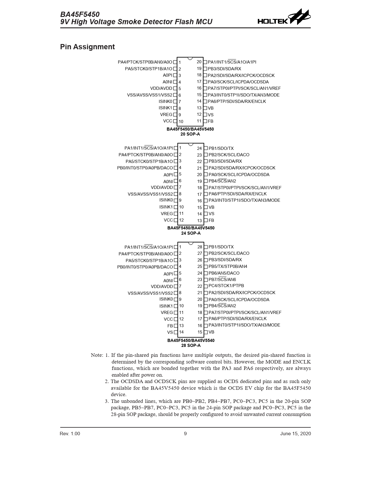

BA45F5450. 9V High Voltage Smoke Detector Flash MCU. Pin Assignment. BA45F5450/BA45V5450. 20 SOP-A. 24 SOP-A. BA45F5450/BA45V5540
BA45F5450 9V High Voltage Smoke Detector Flash MCU Pin Assignment BA45F5450/BA45V5450 20 SOP-A 24 SOP-A BA45F5450/BA45V5540
BA45F5450 BA45F5450 9V High Voltage Smoke Detector Flash MCU 9V High Voltage Smoke Detector Flash MCU Pin Assignment
PA4/PTCK/STP0B/AN0/A0O 1 20 PA1/INT1/SCS/A1O/A1PI PA5/STCK0/STP1B/A1O 2 19 PB3/SDI/SDA/RX A0PI 3 18 PA2/SDI/SDA/RX/ICPCK/OCDSCK A0NI 4 17 PA0/SCK/SCL/ICPDA/OCDSDA VDD/AVDD 5 16 PA7/STP0I/PTPI/SCK/SCL/AN1/VREF VSS/AVSS/VSS1/VSS2 6 15 PA3/INT0/STP1I/SDO/TX/AN3/MODE ISINK0 7 14 PA6/PTP/SDI/SDA/RX/ENCLK ISINK1 8 13 VB VREG 9 12 VS VCC 10 11 FB
PA1/INT1/SCS/A1O/A1PI 1 24 PB1/SDO/TX PA4/PTCK/STP0B/AN0/A0O 2 23 PB2/SCK/SCL/DACO PA5/STCK0/STP1B/A1O 3 22 PB3/SDI/SDA/RX PB0/INT0/STP0/A0PB/DACO 4 21 PA2/SDI/SDA/RX/ICPCK/OCDSCK A0PI 5 20 PA0/SCK/SCL/ICPDA/OCDSDA A0NI 6 19 PB4/SCS/AN2 VDD/AVDD 7 18 PA7/STP0I/PTPI/SCK/SCL/AN1/VREF VSS/AVSS/VSS1/VSS2 8 17 PA6/PTP/SDI/SDA/RX/ENCLK ISINK0 9 16 PA3/INT0/STP1I/SDO/TX/AN3/MODE ISINK1 10 15 VB VREG 11 14 VS VCC 12 13 FB
BA45F5450/BA45V5450 24 SOP-A
PA1/INT1/SCS/A1O/A1PI 1 28 PB1/SDO/TX PA4/PTCK/STP0B/AN0/A0O 2 27 PB2/SCK/SCL/DACO PA5/STCK0/STP1B/A1O 3 26 PB3/SDI/SDA/RX PB0/INT0/STP0/A0PB/DACO 4 25 PB5/TX/STP0B/AN4 A0PI 5 24 PB6/AN5/DACO A0NI 6 23 PB7/SCS/AN6 VDD/AVDD 7 22 PC4/STCK1/PTPB VSS/AVSS/VSS1/VSS2 8 21 PA2/SDI/SDA/RX/ICPCK/OCDSCK ISINK0 9 20 PA0/SCK/SCL/ICPDA/OCDSDA ISINK1 10 19 PB4/SCS/AN2 VREG 11 18 PA7/STP0I/PTPI/SCK/SCL/AN1/VREF VCC 12 17 PA6/PTP/SDI/SDA/RX/ENCLK FB 13 16 PA3/INT0/STP1I/SDO/TX/AN3/MODE VS 14 15 VB
BA45F5450/BA45V5540 28 SOP-A
Note: 1. If the pin-shared pin functions have multiple outputs, the desired pin-shared function is determined by the corresponding software control bits. However, the MODE and ENCLK functions, which are bonded together with the PA3 and PA6 respectively, are always enabled after power on. 2. The OCDSDA and OCDSCK pins are supplied as OCDS dedicated pins and as such only available for the BA45V5450 device which is the OCDS EV chip for the BA45F5450 device. 3. The unbonded lines, which are PB0~PB2, PB4~PB7, PC0~PC3, PC5 in the 20-pin SOP package, PB5~PB7, PC0~PC3, PC5 in the 24-pin SOP package and PC0~PC3, PC5 in the 28-pin SOP package, should be properly configured to avoid unwanted current consumption Rev. 1.00 8 June 15, 2020 Rev. 1.00 9 June 15, 2020 Document Outline Features CPU Features Peripheral Features General Description Block Diagram Pin Assignment Pin Description Absolute Maximum Ratings D.C. Characteristics Operating Voltage Characteristics Operating Current Characteristics Standby Current Characteristics A.C. Characteristics High Speed Internal Oscillator – HIRC – Frequency Accuracy Low Speed Internal Oscillator – LIRC System Start Up Time Characteristics Input/Output Characteristics Memory Characteristics LVD & LVR Electrical Characteristics A/D Converter Electrical Characteristics Reference Voltage Characteristics Sink Current Generator Electrical Characteristics Sink Current Generator Characteristic Curves Operational Amplifier Electrical Characteristics – Smoke Detector AFE 16-bit Voice D/A Converter Electrical Characteristics LDO Electrical Characteristics Piezoelectric Horn Driver Characteristics Power-on Reset Characteristics System Architecture Clocking and Pipelining Program Counter Stack Arithmetic and Logic Unit – ALU Flash Program Memory Structure Special Vectors Look-up Table Table Program Example In Circuit Programming – ICP On Chip Debug Support – OCDS In Application Programming – IAP Data Memory Structure Data Memory Addressing General Purpose Data Memory Special Purpose Data Memory Special Function Register Description Indirect Addressing Registers – IAR0, IAR1, IAR2 Memory Pointers – MP0, MP1L, MP1H, MP2L, MP2H Accumulator – ACC Program Counter Low Register – PCL Look-up Table Registers – TBLP, TBHP, TBLH Status Register – STATUS EEPROM Data Memory EEPROM Data Memory Structure EEPROM Registers Reading Data from the EEPROM Writing Data to the EEPROM Write Protection EEPROM Interrupt Programming Considerations Oscillators Oscillator Overview System Clock Configurations Internal High Speed RC Oscillator – HIRC Internal 32kHz Oscillator – LIRC Operating Modes and System Clocks System Clocks System Operation Modes Control Registers Operating Mode Switching Standby Current Considerations Wake-up Watchdog Timer Watchdog Timer Clock Source Watchdog Timer Control Register Watchdog Timer Operation Reset and Initialisation Reset Functions Reset Initial Conditions Input/Output Ports Pull-high Resistors Port A Wake-up I/O Port Control Registers I/O Port Source Current Control Pin-shared Functions I/O Pin Structures Programming Considerations Timer Modules – TM Introduction TM Operation TM Clock Source TM Interrupts TM External Pins Programming Considerations Standard Type TM – STM Standard TM Operation Standard Type TM Register Description Standard Type TM Operation Modes Periodic Type TM – PTM Periodic TM Operation Periodic Type TM Register Description Periodic Type TM Operating Modes Smoke Detector AFE Smoke Detector AFE Registers Operational Amplifier Operation Operational Amplifier Input Offset Calibration Piezoelectric Horn Driver Self-driving Mode External-driving Mode Analog to Digital Converter A/D Converter Overview A/D Converter Register Description A/D Converter Operation A/D Converter Reference Voltage A/D Converter Input Signals Conversion Rate and Timing Diagram Summary of A/D Conversion Steps Programming Considerations A/D Conversion Function A/D Conversion Programming Examples Sink Current Generator Sink Current Generator Registers 16-bit Voice D/A Converter D/A Converter Registers Serial Interface Module – SIM SPI Interface I2C Interface UART Interface UART External Pins UART Data Transfer Scheme UART Status and Control Registers Baud Rate Generator UART Setup and Control UART Transmitter UART Receiver Managing Receiver Errors UART Interrupt Structure UART Power Down and Wake-up Low Voltage Detector – LVD LVD Register LVD Operation Interrupts Interrupt Registers Interrupt Operation External Interrupts A/D Converter Interrupt Time Base Interrupts Multi-function Interrupt SIM Interrupt UART Interrupt LVD Interrupt EEPROM Interrupt TM Interrupts Interrupt Wake-up Function Programming Considerations Application Circuits External-Driving Buzzer Application Circuit Self-Driving Buzzer Application Circuit Instruction Set Introduction Instruction Timing Moving and Transferring Data Arithmetic Operations Logical and Rotate Operation Branches and Control Transfer Bit Operations Table Read Operations Other Operations Instruction Set Summary Table Conventions Extended Instruction Set Instruction Definition Extended Instruction Definition Package Information 20-pin SOP (300mil) Outline Dimensions 24-pin SOP (300mil) Outline Dimensions 28-pin SOP (300mil) Outline Dimensions
