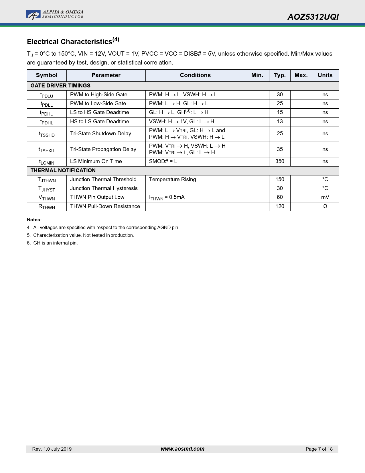

TJ = 0°C to 150°C, VIN = 12V, VOUT = 1V, PVCC = VCC = DISB# = 5V, unless otherwise specified. Min/Max values are guaranteed by test, design, or statistical correlation.
Symbol Parameter Conditions Min. Typ. Max. Units GATE DRIVER TIMINGS
tPDLU PWM to High-Side Gate PWM: H  L, VSWH: H  L 30 ns tPDLL PWM to Low-Side Gate PWM: L  H, GL: H  L 25 ns tPDHU LS to HS Gate Deadtime GL: H  L, GH(6): L  H 15 ns tPDHL HS to LS Gate Deadtime VSWH: H  1V, GL: L  H 13 ns tTSSHD Tri-State Shutdown Delay PWM: L  VTRI, GL: H  L and PWM: H  VTRI, VSWH: H  L 25 ns tTSEXIT Tri-State Propagation Delay PWM: VTRI  H, VSWH: L  H PWM: VTRI  L, GL: L  H 35 ns tLGMIN LS Minimum On Time SMOD# = L 350 ns
THERMAL NOTIFICATION
TJTHWN Junction Thermal Threshold Temperature Rising 150 °C TJHYST Junction Thermal Hysteresis 30 °C VTHWN THWN Pin Output Low ITHWN = 0.5mA 60 mV RTHWN THWN Pull-Down Resistance 120 Ω
Notes:
4. All voltages are specified with respect to the corresponding AGND pin. 5. Characterization value. Not tested in production. 6. GH is an internal pin. Rev. 1.0 July 2019
