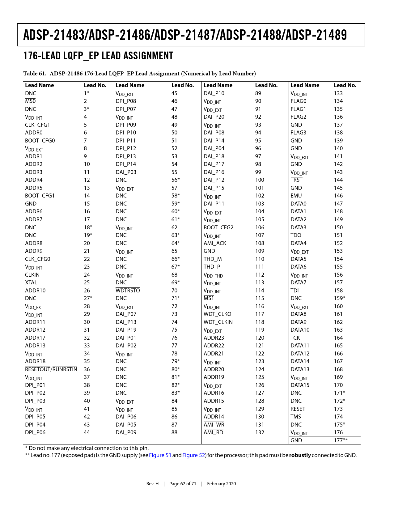

ADSP-21483/ADSP-21486/ADSP-21487/ADSP-21488/ADSP-21489. 176-LEAD LQFP_EP LEAD ASSIGNMENT
ADSP-21483/ADSP-21486/ADSP-21487/ADSP-21488/ADSP-21489 176-LEAD LQFP_EP LEAD ASSIGNMENT
link to page 65 link to page 65
ADSP-21483/ADSP-21486/ADSP-21487/ADSP-21488/ADSP-21489 176-LEAD LQFP_EP LEAD ASSIGNMENT Table 61. ADSP-21486 176-Lead LQFP_EP Lead Assignment (Numerical by Lead Number) Lead Name Lead No. Lead Name Lead No. Lead Name Lead No. Lead Name Lead No.
DNC 1* VDD_EXT 45 DAI_P10 89 VDD_INT 133 MS0 2 DPI_P08 46 VDD_INT 90 FLAG0 134 DNC 3* DPI_P07 47 VDD_EXT 91 FLAG1 135 VDD_INT 4 VDD_INT 48 DAI_P20 92 FLAG2 136 CLK_CFG1 5 DPI_P09 49 VDD_INT 93 GND 137 ADDR0 6 DPI_P10 50 DAI_P08 94 FLAG3 138 BOOT_CFG0 7 DPI_P11 51 DAI_P14 95 GND 139 VDD_EXT 8 DPI_P12 52 DAI_P04 96 GND 140 ADDR1 9 DPI_P13 53 DAI_P18 97 VDD_EXT 141 ADDR2 10 DPI_P14 54 DAI_P17 98 GND 142 ADDR3 11 DAI_P03 55 DAI_P16 99 VDD_INT 143 ADDR4 12 DNC 56* DAI_P12 100 TRST 144 ADDR5 13 VDD_EXT 57 DAI_P15 101 GND 145 BOOT_CFG1 14 DNC 58* VDD_INT 102 EMU 146 GND 15 DNC 59* DAI_P11 103 DATA0 147 ADDR6 16 DNC 60* VDD_EXT 104 DATA1 148 ADDR7 17 DNC 61* VDD_INT 105 DATA2 149 DNC 18* VDD_INT 62 BOOT_CFG2 106 DATA3 150 DNC 19* DNC 63* VDD_INT 107 TDO 151 ADDR8 20 DNC 64* AMI_ACK 108 DATA4 152 ADDR9 21 VDD_INT 65 GND 109 VDD_EXT 153 CLK_CFG0 22 DNC 66* THD_M 110 DATA5 154 VDD_INT 23 DNC 67* THD_P 111 DATA6 155 CLKIN 24 VDD_INT 68 VDD_THD 112 VDD_INT 156 XTAL 25 DNC 69* VDD_INT 113 DATA7 157 ADDR10 26 WDTRSTO 70 VDD_INT 114 TDI 158 DNC 27* DNC 71* MS1 115 DNC 159* VDD_EXT 28 VDD_EXT 72 VDD_INT 116 VDD_EXT 160 VDD_INT 29 DAI_P07 73 WDT_CLKO 117 DATA8 161 ADDR11 30 DAI_P13 74 WDT_CLKIN 118 DATA9 162 ADDR12 31 DAI_P19 75 VDD_EXT 119 DATA10 163 ADDR17 32 DAI_P01 76 ADDR23 120 TCK 164 ADDR13 33 DAI_P02 77 ADDR22 121 DATA11 165 VDD_INT 34 VDD_INT 78 ADDR21 122 DATA12 166 ADDR18 35 DNC 79* VDD_INT 123 DATA14 167 RESETOUT/RUNRSTIN 36 DNC 80* ADDR20 124 DATA13 168 VDD_INT 37 DNC 81* ADDR19 125 VDD_INT 169 DPI_P01 38 DNC 82* VDD_EXT 126 DATA15 170 DPI_P02 39 DNC 83* ADDR16 127 DNC 171* DPI_P03 40 VDD_EXT 84 ADDR15 128 DNC 172* VDD_INT 41 VDD_INT 85 VDD_INT 129 RESET 173 DPI_P05 42 DAI_P06 86 ADDR14 130 TMS 174 DPI_P04 43 DAI_P05 87 AMI_WR 131 DNC 175* DPI_P06 44 DAI_P09 88 AMI_RD 132 VDD_INT 176 GND 177** * Do not make any electrical connection to this pin. ** Lead no. 177 (exposed pad) is the GND supply (see Figure 51 and Figure 52) for the processor; this pad must be
