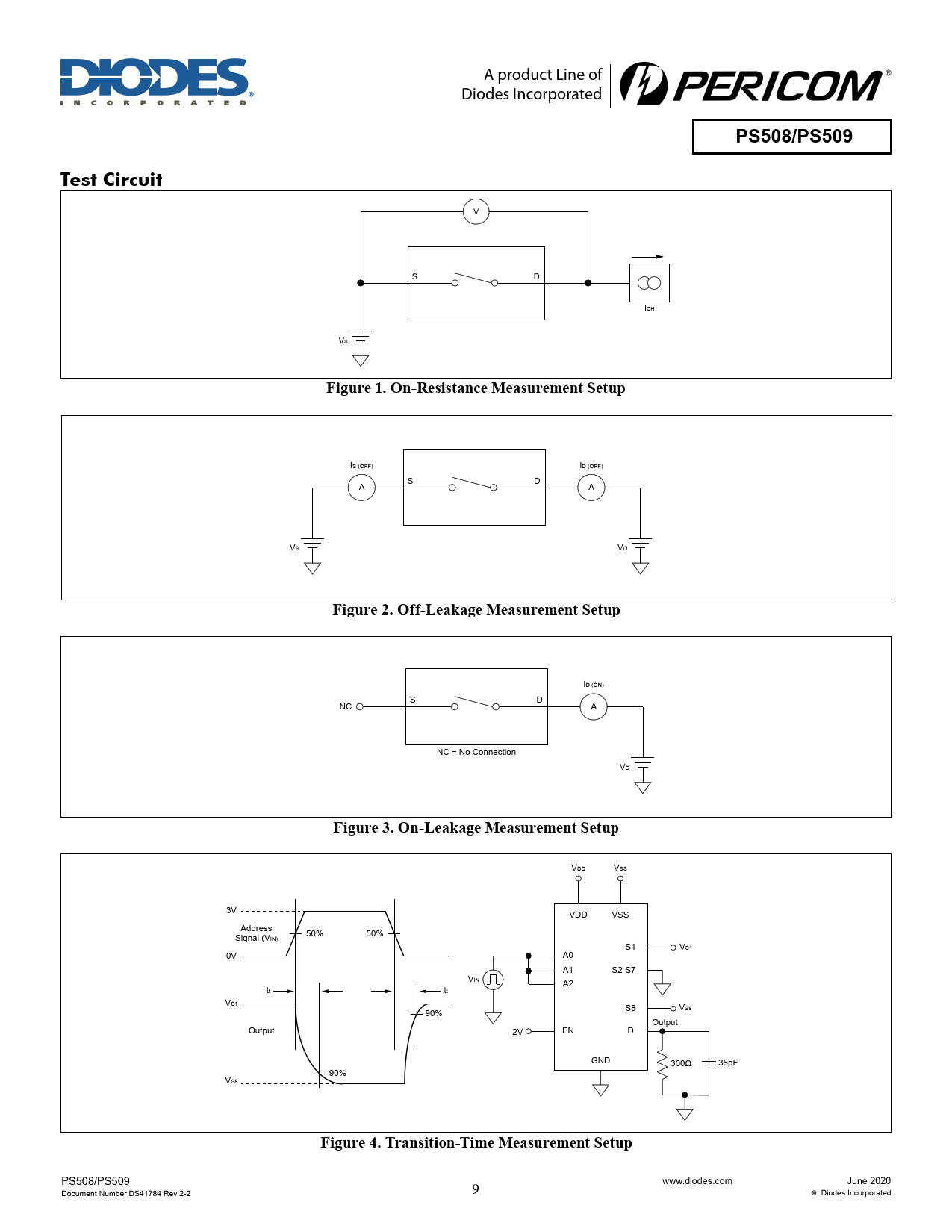

PS508/PS509. Test Circuit. Figure 1. On-Resistance Measurement Setup. Figure 2. Off-Leakage Measurement Setup

PS508/PS509 Test Circuit
V S D ICH VS
IS (OFF) ID (OFF) S D A A VS VD
ID (ON) S D NC A NC = No Connection VD
Figure 3. On-Leakage Measurement Setup
VDD VSS 3V VDD VSS Address Signal (V 50% 50% IN) S1 VS1 0V A0 A1 S2-S7 VIN A2 tt tt VS1 S8 VS8 90% Output Output 2V EN D GND 300Ω 35pF 90% VS8
Figure 4. Transition-Time Measurement Setup
