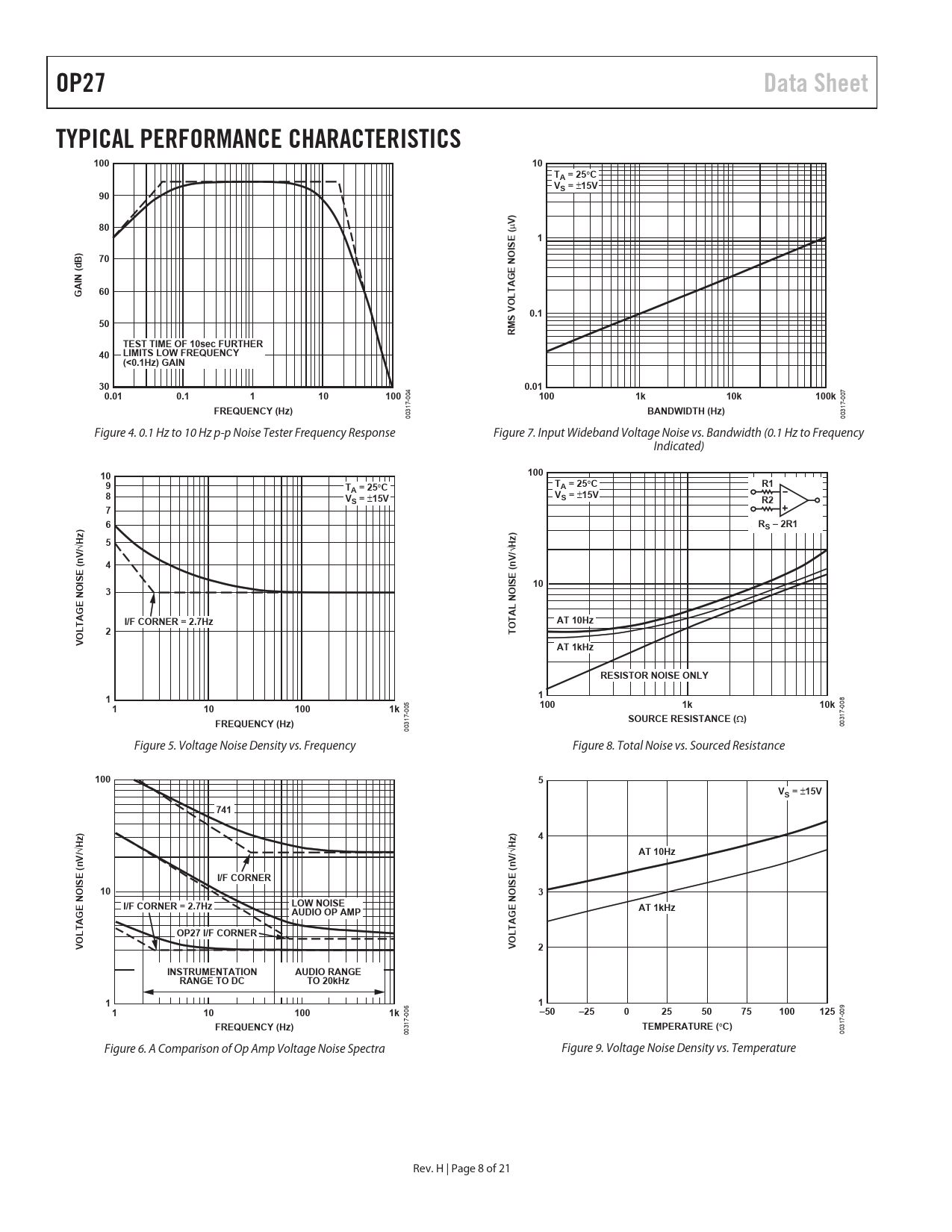

OP27 Data Sheet TYPICAL PERFORMANCE CHARACTERISTICS

0 0 0 Figure 4. 0.1 Hz to 10 Hz p-p Noise Tester Frequency Response Figure 7. Input Wideband Voltage Noise vs. Bandwidth (0.1 Hz to Frequency Indicated)

3 0 0 0 0 Figure 5. Voltage Noise Density vs. Frequency Figure 8. Total Noise vs. Sourced Resistance

H AT 10Hz V V (n (n I/F CORNER ISE ISE O 10 O 3 N N E I/F CORNER = 2.7Hz LOW NOISE E AT 1kHz AUDIO OP AMP G G A A T T L OP27 I/F CORNER L O O V V 2 INSTRUMENTATION AUDIO RANGE RANGE TO DC TO 20kHz 1 1

3 0 0 0 0 Figure 6. A Comparison of Op Amp Voltage Noise Spectra Figure 9. Voltage Noise Density vs. Temperature Rev. H | Page 8 of 21
