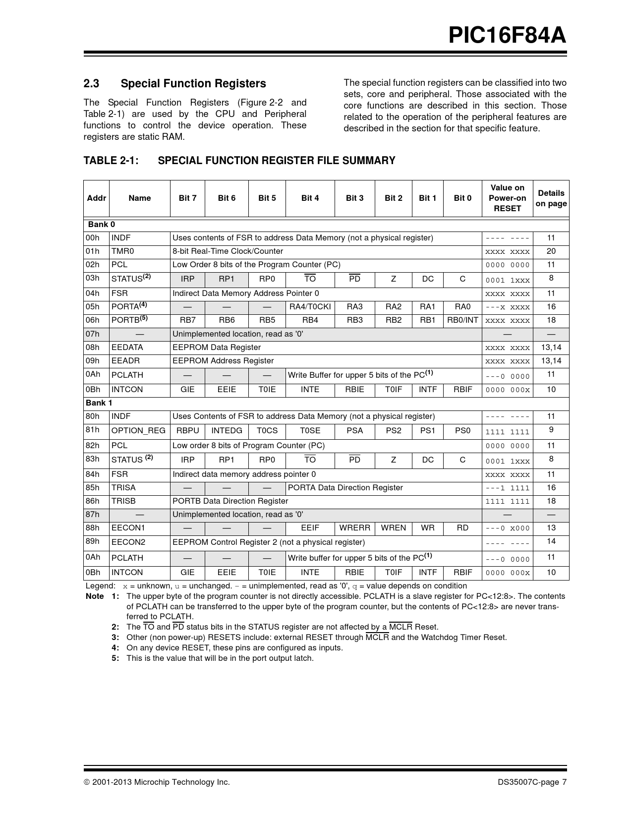

PIC16F84A 2.3 Special Function Registers
The special function registers can be classified into two sets, core and peripheral. Those associated with the The Special Function Registers (Figure 2-2 and core functions are described in this section. Those Table 2-1) are used by the CPU and Peripheral related to the operation of the peripheral features are functions to control the device operation. These described in the section for that specific feature. registers are static RAM.
TABLE 2-1: SPECIAL FUNCTION REGISTER FILE SUMMARY Value on Details Addr Name Bit 7 Bit 6 Bit 5 Bit 4 Bit 3 Bit 2 Bit 1 Bit 0 Power-on on page RESET Bank 0
00h INDF Uses contents of FSR to address Data Memory (not a physical register) ---- ---- 11 01h TMR0 8-bit Real-Time Clock/Counter xxxx xxxx 20 02h PCL Low Order 8 bits of the Program Counter (PC) 0000 0000 11 03h STATUS
(2)
IRP RP1 RP0 TO PD Z DC C 0001 1xxx 8 04h FSR Indirect Data Memory Address Pointer 0 xxxx xxxx 11 05h PORTA
(4)
— — — RA4/T0CKI RA3 RA2 RA1 RA0 ---x xxxx 16 06h PORTB
(5)
RB7 RB6 RB5 RB4 RB3 RB2 RB1 RB0/INT xxxx xxxx 18 07h — Unimplemented location, read as '0' — — 08h EEDATA EEPROM Data Register xxxx xxxx 13,14 09h EEADR EEPROM Address Register xxxx xxxx 13,14 0Ah PCLATH — — — Write Buffer for upper 5 bits of the PC
(1)
---0 0000 11 0Bh INTCON GIE EEIE T0IE INTE RBIE T0IF INTF RBIF 0000 000x 10
Bank 1
80h INDF Uses Contents of FSR to address Data Memory (not a physical register) ---- ---- 11 81h OPTION_REG RBPU INTEDG T0CS T0SE PSA PS2 PS1 PS0 1111 1111 9 82h PCL Low order 8 bits of Program Counter (PC) 0000 0000 11 83h STATUS
(2)
IRP RP1 RP0 TO PD Z DC C 0001 1xxx 8 84h FSR Indirect data memory address pointer 0 xxxx xxxx 11 85h TRISA — — — PORTA Data Direction Register ---1 1111 16 86h TRISB PORTB Data Direction Register 1111 1111 18 87h — Unimplemented location, read as '0' — — 88h EECON1 — — — EEIF WRERR WREN WR RD ---0 x000 13 89h EECON2 EEPROM Control Register 2 (not a physical register) ---- ---- 14 0Ah PCLATH — — — Write buffer for upper 5 bits of the PC
(1)
---0 0000 11 0Bh INTCON GIE EEIE T0IE INTE RBIE T0IF INTF RBIF 0000 000x 10 Legend: x = unknown, u = unchanged. - = unimplemented, read as '0', q = value depends on condition
Note 1:
The upper byte of the program counter is not directly accessible. PCLATH is a slave register for PC<12:8>. The contents of PCLATH can be transferred to the upper byte of the program counter, but the contents of PC<12:8> are never trans- ferred to PCLATH.
2:
The TO and PD status bits in the STATUS register are not affected by a MCLR Reset.
3:
Other (non power-up) RESETS include: external RESET through MCLR and the Watchdog Timer Reset.
4:
On any device RESET, these pins are configured as inputs.
5:
This is the value that will be in the port output latch.  2001-2013 Microchip Technology Inc. DS35007C-page 7 Document Outline 1.0 Device Overview FIGURE 1-1: PIC16F84A Block Diagram TABLE 1-1: PIC16F84A Pinout Description 2.0 Memory Organization 2.1 Program Memory Organization FIGURE 2-1: Program Memory Map and Stack - PIC16F84A 2.2 Data Memory Organization 2.2.1 General purpose Register File FIGURE 2-2: Register File Map - PIC16F84A 2.3 Special Function Registers TABLE 2-1: Special Function Register File Summary 2.3.1 STATUS Register Register 2-1: Status Register (Address 03h, 83h) 2.3.2 OPTION Register Register 2-2: OPTION Register (Address 81h) 2.3.3 INTCOn Register Register 2-3: INTCON Register (Address 0Bh, 8Bh) 2.4 PCL and PCLATH 2.4.1 Stack 2.5 Indirect Addressing; INDF and FSR Registers EXAMPLE 2-1: Indirect Addressing EXAMPLE 2-2: How to Clear RAM Using Indirect Addressing FIGURE 2-3: Direct/Indirect Addressing 3.0 Data EEPROM Memory Register 3-1: EECON1 Register (Address 88h) 3.1 Reading the EEPROM Data Memory EXAMPLE 3-1: Data EEPROM Read 3.2 Writing to the EEPROM Data Memory EXAMPLE 3-2: Data EEPROM Write 3.3 Write Verify EXAMPLE 3-3: Write Verify TABLE 3-1: Registers/Bits Associated with Data EEPROM 4.0 I/O Ports 4.1 PORTA and TRISA Registers EXAMPLE 4-1: Initializing PORTA FIGURE 4-1: Block Diagram of Pins RA3:RA0 FIGURE 4-2: Block Diagram of Pin RA4 TABLE 4-1: PORTA Functions TABLE 4-2: Summary of Registers Associated With PORTA 4.2 PORTB and TRISB Registers EXAMPLE 4-2: Initializing PORTB FIGURE 4-3: Block Diagram of Pins RB7:RB4 FIGURE 4-4: Block Diagram of Pins RB3:RB0 TABLE 4-3: PORTB Functions TABLE 4-4: Summary of Registers Associated With PORTB 5.0 Timer0 Module 5.1 Timer0 Operation 5.2 Prescaler FIGURE 5-1: Timer0 Block Diagram 5.2.1 Switching Prescaler ASSIGnment 5.3 Timer0 Interrupt FIGURE 5-2: Block Diagram of the Timer0/WDT Prescaler TABLE 5-1: Registers Associated with Timer0 6.0 Special Features of the CPU 6.1 Configuration Bits Register 6-1: PIC16F84A Configuration Word 6.2 Oscillator Configurations 6.2.1 Oscillator Types 6.2.2 Crystal Oscillator/CERAmic Resonators FIGURE 6-1: Crystal/Ceramic Resonator Operation (HS, XT or LP OSC Configuration) FIGURE 6-2: External Clock Input Operation (HS, XT or LP OSC Configuration) TABLE 6-1: Capacitor Selection for Ceramic Resonators TABLE 6-2: Capacitor Selection for Crystal Oscillator 6.2.3 RC Oscillator FIGURE 6-3: RC Oscillator Mode 6.3 Reset FIGURE 6-4: Simplified Block Diagram of On-Chip Reset Circuit TABLE 6-3: Reset Condition for Program Counter and the STATUS Register TABLE 6-4: Reset Conditions for All Registers 6.4 Power-on Reset (POR) 6.5 Power-up Timer (PWRT) 6.6 Oscillator Start-up Timer (OST) FIGURE 6-5: External Power-on Reset Circuit (For Slow Vdd Power-up) FIGURE 6-6: Time-out Sequence on Power-up (MCLR not Tied to Vdd): Case 1 FIGURE 6-7: Time-out Sequence on Power-up (MCLR Not Tied To Vdd): Case 2 FIGURE 6-8: Time-out Sequence on Power-up (MCLR Tied to Vdd): Fast Vdd Rise Time FIGURE 6-9: Time-Out Sequence on Power-Up (MCLR Tied to Vdd): Slow Vdd Rise Time 6.7 Time-out Sequence and Power-down Status Bits (TO/PD) TABLE 6-5: Time-out in Various Situations TABLE 6-6: STATUS bits and Their Significance 6.8 Interrupts FIGURE 6-10: Interrupt Logic 6.8.1 INT Interrupt 6.8.2 TMR0 Interrupt 6.8.3 PORTB Interrupt 6.8.4 Data EEPROM Interrupt 6.9 Context Saving During Interrupts EXAMPLE 6-1: Saving STATUS and W Registers in RAM 6.10 Watchdog Timer (WDT) 6.10.1 WDT Period 6.10.2 WDT Programming Considerations FIGURE 6-11: Watchdog Timer Block Diagram TABLE 6-7: Summary of Registers Associated With the Watchdog Timer 6.11 Power-down Mode (SLEEP) 6.11.1 SLEEP 6.11.2 Wake-up from SLEEP FIGURE 6-12: Wake-up From Sleep Through Interrupt 6.11.3 Wake-Up Using Interrupts 6.12 Program Verification/Code Protection 6.13 ID Locations 6.14 In-Circuit Serial Programming 7.0 Instruction Set Summary TABLE 7-1: Opcode Field Descriptions FIGURE 7-1: General Format for Instructions TABLE 7-2: PIC16CXXX Instruction Set 7.1 Instruction Descriptions 8.0 Development Support 9.0 Electrical Characteristics FIGURE 9-1: PIC16F84A-20 Voltage-Frequency Graph FIGURE 9-2: PIC16LF84A-04 Voltage- Frequency Graph FIGURE 9-3: PIC16F84A-04 Voltage- Frequency Graph 9.1 DC Characteristics 9.2 DC Characteristics: PIC16F84A-04 (Commercial, Industrial) PIC16F84A-20 (Commercial, Industrial) PIC16LF84A-04 (Commercial, Industrial) 9.3 AC (Timing) Characteristics 9.3.1 Timing Parameter Symbology 9.3.2 Timing Conditions TABLE 9-1: Temperature and Voltage Specifications - AC FIGURE 9-4: Parameter Measurement Information FIGURE 9-5: Load Conditions 9.3.3 Timing Diagrams and Specifications FIGURE 9-6: External Clock Timing TABLE 9-2: External Clock Timing Requirements FIGURE 9-7: CLKOUT and I/O Timing TABLE 9-3: CLKOUT and I/O Timing Requirements FIGURE 9-8: Reset, Watchdog Timer, Oscillator Start-up Timer and Power-up Timer Timing TABLE 9-4: Reset, Watchdog Timer, Oscillator Start-up Timer and Power-up Timer Requirements FIGURE 9-9: Timer0 Clock Timings TABLE 9-5: Timer0 Clock Requirements 10.0 DC/AC Characteristic Graphs FIGURE 10-1: Typical Idd vs. Fosc OVER Vdd (HS Mode, 25°C) FIGURE 10-2: Maximum Idd vs. Fosc OVER Vdd (HS Mode, -40° to +125°C) FIGURE 10-3: Typical Idd vs. Fosc OVER Vdd (XT Mode, 25°C) FIGURE 10-4: Maximum Idd vs. Fosc OVER Vdd (XT Mode, -40° to +125°C) FIGURE 10-5: Typical Idd vs. Fosc OVER Vdd (LP Mode, 25°C) FIGURE 10-6: Maximum Idd vs. Fosc OVER Vdd (LP Mode, -40° to +125°C) FIGURE 10-7: Average Fosc vs. Vdd for R (RC Mode, C = 22 pF, 25°C) FIGURE 10-8: Average Fosc vs. Vdd for R (RC Mode, C = 100 pF, 25°C) FIGURE 10-9: Average Fosc vs. Vdd for R (RC Mode, C = 300 pF, 25°C) FIGURE 10-10: Ipd vs. Vdd (Sleep Mode, all peripherals disabled) FIGURE 10-11: Ipd vs. Vdd (WDT Mode) FIGURE 10-12: Typical, Minimum, and Maximum WDT Period vs. Vdd over Temp FIGURE 10-13: Typical, Minimum and Maximum Voh vs. Ioh (Vdd = 5V, -40°C to +125°C) FIGURE 10-14: Typical, Minimum and Maximum Voh vs. Ioh (Vdd = 3V, -40°C to +125°C) FIGURE 10-15: Typical, Minimum and Maximum Vol vs. Iol (Vdd = 5V, -40°C to +125°C) FIGURE 10-16: Typical, Minimum and Maximum Vol vs. Iol (Vdd = 3V, -40°C to +125°C) FIGURE 10-17: Minimum and Maximum Vin vs. Vdd, (TTL Input, -40°C to +125°C) FIGURE 10-18: Minimum and Maximum Vin vs. Vdd (ST Input, -40°C to +125°C) 11.0 Packaging Information 11.1 Package Marking Information Appendix A: Revision History Appendix B: Conversion Considerations Appendix C: Migration from Baseline to Mid-range Devices A B C D E F I M O P R S T W Z The Microchip Web Site Customer Change Notification Service Customer Support Reader Response Corporate Office Atlanta Boston Chicago Cleveland Fax: 216-447-0643 Dallas Detroit Indianapolis Toronto Fax: 852-2401-3431 Australia - Sydney China - Beijing China - Shanghai India - Bangalore Korea - Daegu Korea - Seoul Singapore Taiwan - Taipei Fax: 43-7242-2244-393 Denmark - Copenhagen France - Paris Germany - Munich Italy - Milan Spain - Madrid UK - Wokingham Worldwide Sales and Service
