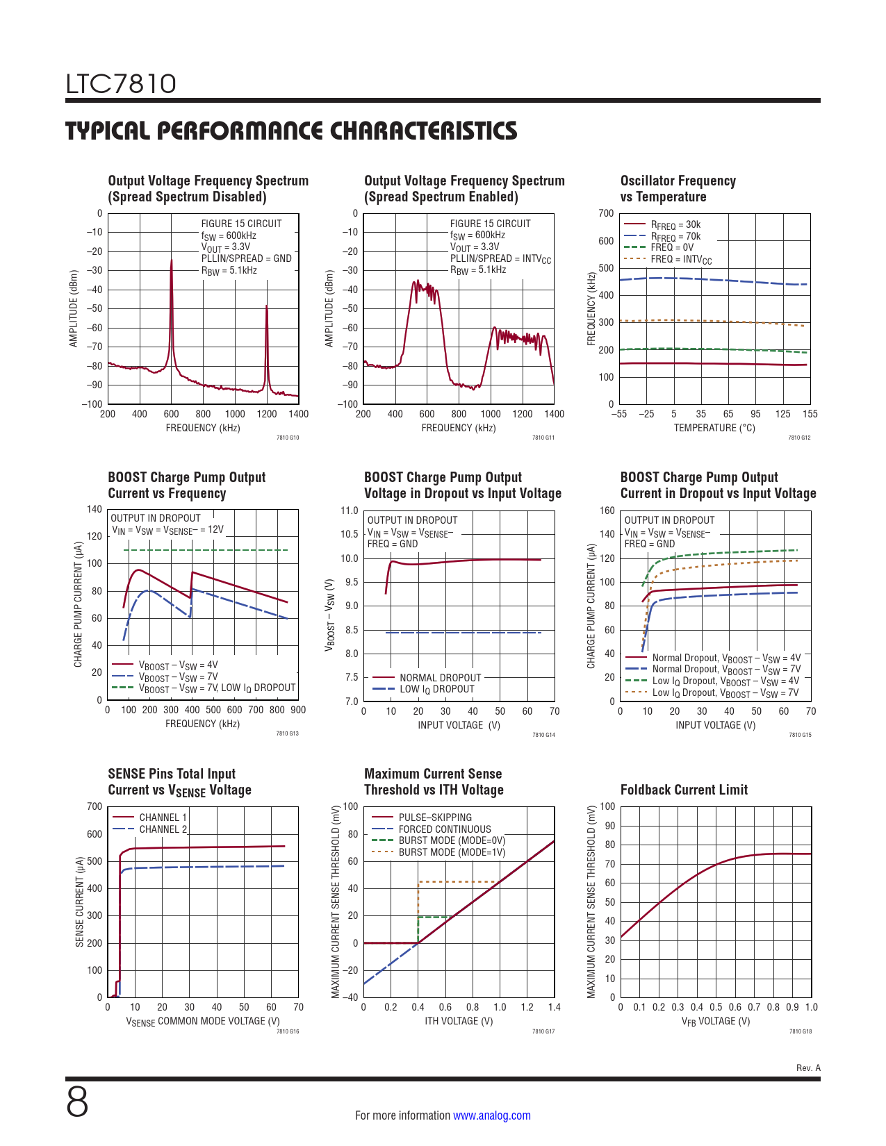

TYPICAL PERFORMANCE CHARACTERISTICS. Output Voltage Frequency Spectrum. Oscillator Frequency. (Spread Spectrum Disabled)
TYPICAL PERFORMANCE CHARACTERISTICS Output Voltage Frequency Spectrum Oscillator Frequency (Spread Spectrum Disabled)
LTC7810
TYPICAL PERFORMANCE CHARACTERISTICS Output Voltage Frequency Spectrum Output Voltage Frequency Spectrum Oscillator Frequency (Spread Spectrum Disabled) (Spread Spectrum Enabled) vs Temperature
0 0 700 FIGURE 15 CIRCUIT FIGURE 15 CIRCUIT RFREQ = 30k –10 f –10 SW = 600kHz fSW = 600kHz RFREQ = 70k 600 VOUT = 3.3V VOUT = 3.3V FREQ = 0V –20 –20 PLLIN/SPREAD = GND PLLIN/SPREAD = INTVCC FREQ = INTVCC –30 R –30 R 500 BW = 5.1kHz BW = 5.1kHz –40 –40 400 –50 –50 300 –60 –60 AMPLITUDE (dBm) AMPLITUDE (dBm) FREQUENCY (kHz) –70 –70 200 –80 –80 100 –90 –90 –100 –100 0 200 400 600 800 1000 1200 1400 200 400 600 800 1000 1200 1400 –55 –25 5 35 65 95 125 155 FREQUENCY (kHz) FREQUENCY (kHz) TEMPERATURE (°C) 7810 G10 7810 G11 7810 G12
BOOST Charge Pump Output BOOST Charge Pump Output BOOST Charge Pump Output Current vs Frequency Voltage in Dropout vs Input Voltage Current in Dropout vs Input Voltage
140 11.0 160 OUTPUT IN DROPOUT OUTPUT IN DROPOUT OUTPUT IN DROPOUT VIN = VSW = VSENSE– = 12V 120 10.5 VIN = VSW = VSENSE– 140 VIN = VSW = VSENSE– FREQ = GND FREQ = GND 100 10.0 120 9.5 100 80 (V) SW 9.0 80 60 – V 8.5 60 40 V BOOST 8.0 40 CHARGE PUMP CURRENT (µA) Normal Dropout, V V BOOST – VSW = 4V BOOST – VSW = 4V CHARGE PUMP CURRENT (µA) 20 Normal Dropout, V V BOOST – VSW = 7V BOOST – VSW = 7V 7.5 NORMAL DROPOUT 20 Low I V Q Dropout, VBOOST – VSW = 4V BOOST – VSW = 7V, LOW IQ DROPOUT LOW IQ DROPOUT Low I 0 Q Dropout, VBOOST – VSW = 7V 7.0 0 0 100 200 300 400 500 600 700 800 900 0 10 20 30 40 50 60 70 0 10 20 30 40 50 60 70 FREQUENCY (kHz) INPUT VOLTAGE (V) INPUT VOLTAGE (V) 7810 G13 7810 G14 7810 G15
SENSE Pins Total Input Maximum Current Sense Current vs VSENSE Voltage Threshold vs ITH Voltage Foldback Current Limit
