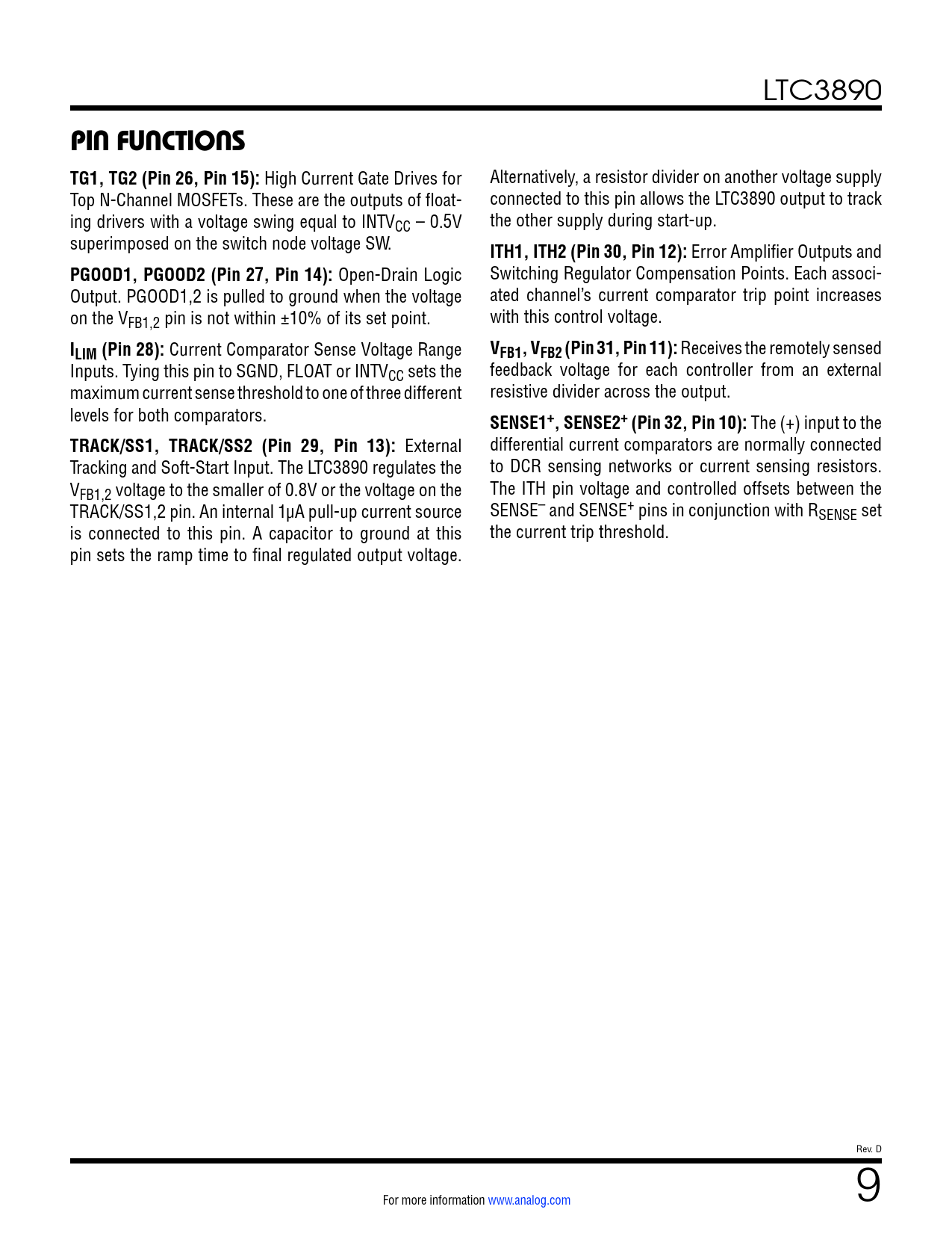

High Current Gate Drives for Alternatively, a resistor divider on another voltage supply Top N-Channel MOSFETs. These are the outputs of float- connected to this pin allows the LTC3890 output to track ing drivers with a voltage swing equal to INTVCC – 0.5V the other supply during start-up. superimposed on the switch node voltage SW.

Error Amplifier Outputs and

Open-Drain Logic Switching Regulator Compensation Points. Each associ- Output. PGOOD1,2 is pulled to ground when the voltage ated channel’s current comparator trip point increases on the VFB1,2 pin is not within ±10% of its set point. with this control voltage.

Current Comparator Sense Voltage Range

Receives the remotely sensed Inputs. Tying this pin to SGND, FLOAT or INTVCC sets the feedback voltage for each controller from an external maximum current sense threshold to one of three different resistive divider across the output. levels for both comparators.

The (+) input to the

External differential current comparators are normally connected Tracking and Soft-Start Input. The LTC3890 regulates the to DCR sensing networks or current sensing resistors. VFB1,2 voltage to the smaller of 0.8V or the voltage on the The ITH pin voltage and controlled offsets between the TRACK/SS1,2 pin. An internal 1µA pull-up current source SENSE– and SENSE+ pins in conjunction with RSENSE set is connected to this pin. A capacitor to ground at this the current trip threshold. pin sets the ramp time to final regulated output voltage. Rev. D For more information www.analog.com 9 Document Outline Features Applications Typical Application Description Absolute Maximum Ratings Order Information Pin Configuration Electrical Characteristics Typical Performance Characteristics Pin Functions Functional Diagram Operation Applications Information Typical Applications Package Description Revision History Typical Application Related Parts
