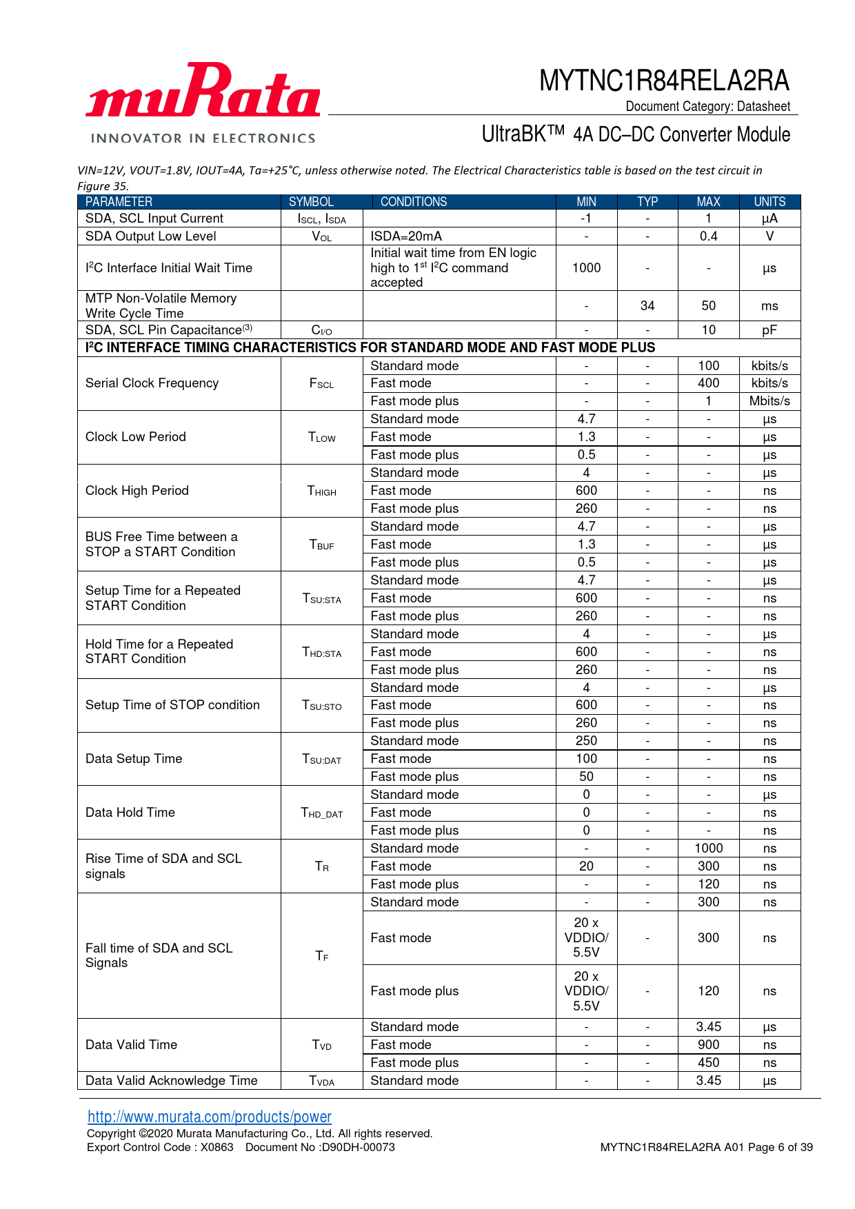

Document Category: Datasheet UltraBK™ 4A DC–DC Converter Module VIN=12V, VOUT=1.8V, IOUT=4A, Ta=+25°C, unless otherwise noted. The Electrical Characteristics table is based on the test circuit in Figure 35.
PARAMETER SYMBOL CONDITIONS MIN TYP MAX UNITS
SDA, SCL Input Current ISCL, ISDA -1 - 1 µA SDA Output Low Level VOL ISDA=20mA - - 0.4 V Initial wait time from EN logic I2C Interface Initial Wait Time high to 1st I2C command 1000 - - µs accepted MTP Non-Volatile Memory - 34 50 ms Write Cycle Time SDA, SCL Pin Capacitance(3) CI/O - - 10 pF
I2C INTERFACE TIMING CHARACTERISTICS FOR STANDARD MODE AND FAST MODE PLUS
Standard mode - - 100 kbits/s Serial Clock Frequency FSCL Fast mode - - 400 kbits/s Fast mode plus - - 1 Mbits/s Standard mode 4.7 - - µs Clock Low Period TLOW Fast mode 1.3 - - µs Fast mode plus 0.5 - - µs Standard mode 4 - - µs Clock High Period THIGH Fast mode 600 - - ns Fast mode plus 260 - - ns Standard mode 4.7 - - µs BUS Free Time between a T Fast mode 1.3 - - µs STOP a START Condition BUF Fast mode plus 0.5 - - µs Standard mode 4.7 - - µs Setup Time for a Repeated T Fast mode 600 - - ns START Condition SU:STA Fast mode plus 260 - - ns Standard mode 4 - - µs Hold Time for a Repeated T Fast mode 600 - - ns START Condition HD:STA Fast mode plus 260 - - ns Standard mode 4 - - µs Setup Time of STOP condition TSU:STO Fast mode 600 - - ns Fast mode plus 260 - - ns Standard mode 250 - - ns Data Setup Time TSU:DAT Fast mode 100 - - ns Fast mode plus 50 - - ns Standard mode 0 - - µs Data Hold Time THD_DAT Fast mode 0 - - ns Fast mode plus 0 - - ns Standard mode - - 1000 ns Rise Time of SDA and SCL T Fast mode 20 - 300 ns signals R Fast mode plus - - 120 ns Standard mode - - 300 ns 20 x Fast mode VDDIO/ - 300 ns Fall time of SDA and SCL T 5.5V Signals F 20 x Fast mode plus VDDIO/ - 120 ns 5.5V Standard mode - - 3.45 µs Data Valid Time TVD Fast mode - - 900 ns Fast mode plus - - 450 ns Data Valid Acknowledge Time TVDA Standard mode - - 3.45 µs
