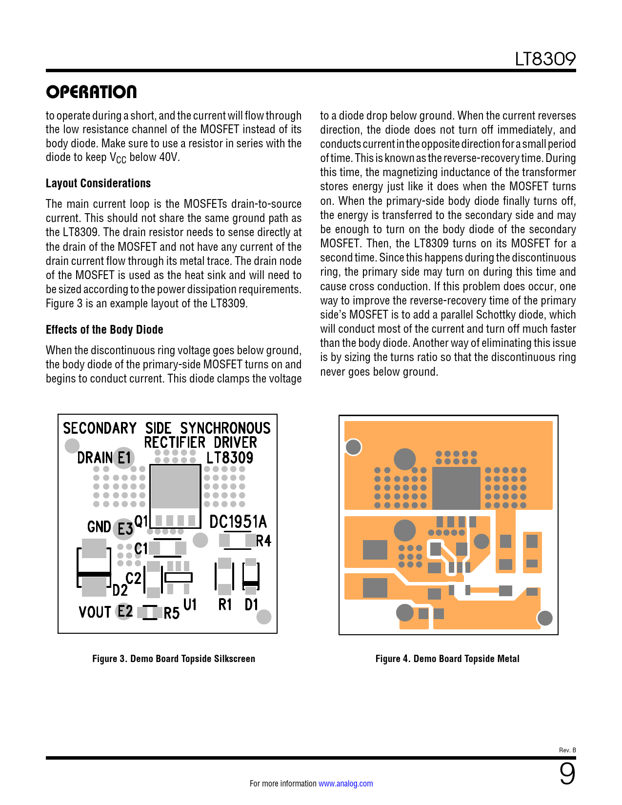

Layout Considerations
stores energy just like it does when the MOSFET turns The main current loop is the MOSFETs drain-to-source on. When the primary-side body diode finally turns off, current. This should not share the same ground path as the energy is transferred to the secondary side and may the LT8309. The drain resistor needs to sense directly at be enough to turn on the body diode of the secondary the drain of the MOSFET and not have any current of the MOSFET. Then, the LT8309 turns on its MOSFET for a drain current flow through its metal trace. The drain node second time. Since this happens during the discontinuous of the MOSFET is used as the heat sink and will need to ring, the primary side may turn on during this time and be sized according to the power dissipation requirements. cause cross conduction. If this problem does occur, one Figure 3 is an example layout of the LT8309. way to improve the reverse-recovery time of the primary side’s MOSFET is to add a parallel Schottky diode, which

Figure 3. Demo Board Topside Silkscreen Figure 4. Demo Board Topside Metal
