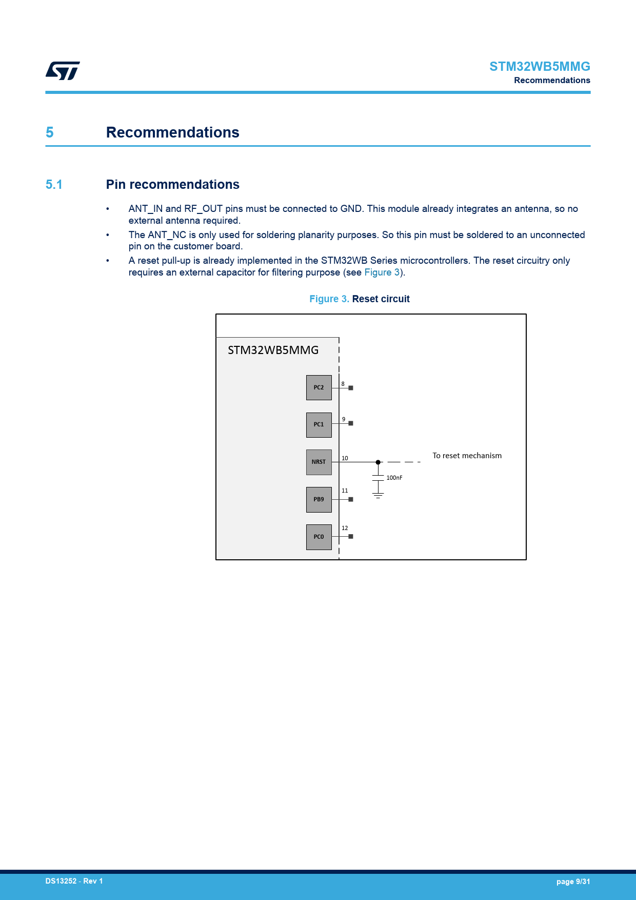

STM32WB5MMG Recommendations 5 Recommendations 5.1 Pin recommendations
• ANT_IN and RF_OUT pins must be connected to GND. This module already integrates an antenna, so no external antenna required. • The ANT_NC is only used for soldering planarity purposes. So this pin must be soldered to an unconnected pin on the customer board. • A reset pull-up is already implemented in the STM32WB Series microcontrollers. The reset circuitry only requires an external capacitor for filtering purpose (see Figure 3).
Figure 3. Reset circuit
STM32WB5MMG
PC2
8 9
PC1
10 To reset mechanism
NRST
100nF 11
PB9
12
PC0 DS13252
Rev 1 page 9/31
