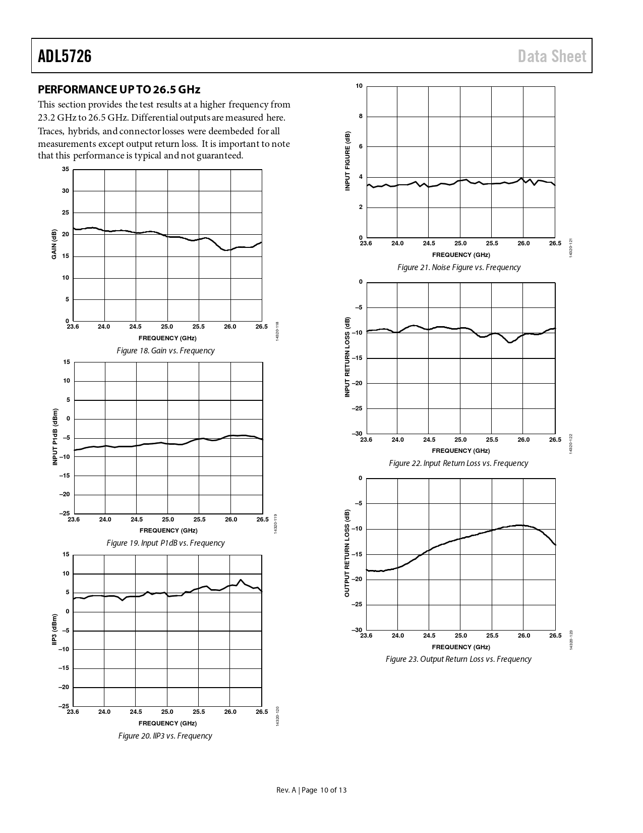

ADL5726. Data Sheet. PERFORMANCE UP TO 26.5 GHz. dB (. T FIGU. U P. N (. 23.6. 24.0. 24.5. 25.0. 25.5. 26.0. 26.5. AI G. FREQUENCY (GHz). d ( S –10. –15
ADL5726 Data Sheet PERFORMANCE UP TO 26.5 GHz dB ( T FIGU U P N ( 23.6 24.0 24.5 25.0 25.5 26.0 26.5 AI G FREQUENCY (GHz) d ( S –10 –15
ADL5726 Data Sheet PERFORMANCE UP TO 26.5 GHz 10
This section provides the test results at a higher frequency from 23.2 GHz to 26.5 GHz. Differential outputs are measured here.
8
Traces, hybrids, and connector losses were deembeded for al
measurements except output return loss. It is important to note
dB ( 6 E
that this performance is typical and not guaranteed.
R 35 T FIGU 4 U P 30 IN 2 25 B) 20 d 0 N ( 23.6 24.0 24.5 25.0 25.5 26.0 26.5
121
AI G 15 FREQUENCY (GHz)
14320- Figure 21. Noise Figure vs. Frequency
10 0 5 –5 0 B) 23.6 24.0 24.5 25.0 25.5 26.0 26.5
118
d ( S –10 FREQUENCY (GHz) S
14320-
O
Figure 18. Gain vs. Frequency
–15 15 URN L T RE 10 –20 UT INP 5 –25 Bm) 0 d B ( –30 1d –5 23.6 24.0 24.5 25.0 25.5 26.0 26.5
122
P UT FREQUENCY (GHz)
14320-
–10 INP
Figure 22. Input Return Loss vs. Frequency
–15 0 –20 –5 –25 B) 23.6 24.0 24.5 25.0 25.5 26.0 26.5
119
d ( S FREQUENCY (GHz) S –10
14320-
O
Figure 19. Input P1dB vs. Frequency
15 URN L –15 T RE 10 UT P –20 5 UT O –25 0 Bm) d –5 –30 3 ( 23.6 24.0 24.5 25.0 25.5 26.0 26.5
123
IIP –10 FREQUENCY (GHz)
14320- Figure 23. Output Return Loss vs. Frequency
–15 –20 –2523.6 24.0 24.5 25.0 25.5 26.0 26.5
120
FREQUENCY (GHz)
14320- Figure 20. IIP3 vs. Frequency Rev. A | Page 10 of 13 Document Outline FEATURES APPLICATIONS FUNCTIONAL BLOCK DIAGRAM GENERAL DESCRIPTION REVISION HISTORY SPECIFICATIONS AC SPECIFICATIONS DC SPECIFICATIONS ABSOLUTE MAXIMUM RATINGS THERMAL RESISTANCE ESD CAUTION PIN CONFIGURATION AND FUNCTION DESCRIPTIONS TYPICAL PERFORMANCE CHARACTERISTICS THEORY OF OPERATION APPLICATIONS INFORMATION LAYOUT DIFFERENTIAL vs. SINGLE-ENDED OUTPUT PERFORMANCE UP TO 26.5 GHz EVALUATION BOARD INITIAL SETUP RESULTS BASIC CONNECTIONS FOR OPERATION OUTLINE DIMENSIONS ORDERING GUIDE
