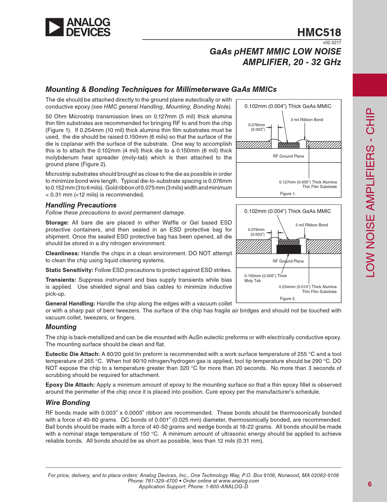

The die should be attached directly to the ground plane eutectical y or with conductive epoxy (see HMC general Handling, Mounting, Bonding Note). 0.102mm (0.004”) Thick GaAs MMIC 50 Ohm Microstrip transmission lines on 0.127mm (5 mil) thick alumina IP 3 mil Ribbon Bond thin film substrates are recommended for bringing RF to and from the chip 0.076mm H (Figure 1). If 0.254mm (10 mil) thick alumina thin film substrates must be (0.003”) used, the die should be raised 0.150mm (6 mils) so that the surface of the C die is coplanar with the surface of the substrate. One way to accomplish - this is to attach the 0.102mm (4 mil) thick die to a 0.150mm (6 mil) thick S molybdenum heat spreader (moly-tab) which is then attached to the RF Ground Plane R ground plane (Figure 2). IE Microstrip substrates should brought as close to the die as possible in order to minimize bond wire length. Typical die-to-substrate spacing is 0.076mm 0.127mm (0.005”) Thick Alumina Thin Film Substrate LIF to 0.152 mm (3 to 6 mils). Gold ribbon of 0.075 mm (3 mils) width and minimum < 0.31 mm (<12 mils) is recommended. Figure 1. P M

Follow these precautions to avoid permanent damage. 0.102mm (0.004”) Thick GaAs MMIC A E

All bare die are placed in either Waffle or Gel based ESD 3 mil Ribbon Bond protective containers, and then sealed in an ESD protective bag for 0.076mm IS shipment. Once the sealed ESD protective bag has been opened, all die (0.003”) O should be stored in a dry nitrogen environment. N

Handle the chips in a clean environment. DO NOT attempt to clean the chip using liquid cleaning systems. RF Ground Plane W

Suppress instrument and bias supply transients while bias Moly Tab is applied. Use shielded signal and bias cables to minimize inductive 0.254mm (0.010”) Thick Alumina pick-up. Thin Film Substrate Figure 2.

The chip is back-metal ized and can be die mounted with AuSn eutectic preforms or with electrical y conductive epoxy. The mounting surface should be clean and flat.
Eutectic Die Attach:
A 80/20 gold tin preform is recommended with a work surface temperature of 255 °C and a tool temperature of 265 °C. When hot 90/10 nitrogen/hydrogen gas is applied, tool tip temperature should be 290 °C. DO NOT expose the chip to a temperature greater than 320 °C for more than 20 seconds. No more than 3 seconds of scrubbing should be required for attachment.
Epoxy Die Attach:
Apply a minimum amount of epoxy to the mounting surface so that a thin epoxy fil et is observed around the perimeter of the chip once it is placed into position. Cure epoxy per the manufacturer’s schedule.
Wire Bonding
RF bonds made with 0.003” x 0.0005” ribbon are recommended. These bonds should be thermosonical y bonded with a force of 40-60 grams. DC bonds of 0.001” (0.025 mm) diameter, thermosonical y bonded, are recommended. Ball bonds should be made with a force of 40-50 grams and wedge bonds at 18-22 grams. All bonds should be made with a nominal stage temperature of 150 °C. A minimum amount of ultrasonic energy should be applied to achieve reliable bonds. All bonds should be as short as possible, less than 12 mils (0.31 mm). For price, delivery, and to place orders: Analog Devices, Inc., One Technology Way, P.O. Box 9106, Norwood, MA 02062-9106 Phone: 781-329-4700 • Order online at www.analog.com Application Support: Phone: 1-800-ANALOG-D
