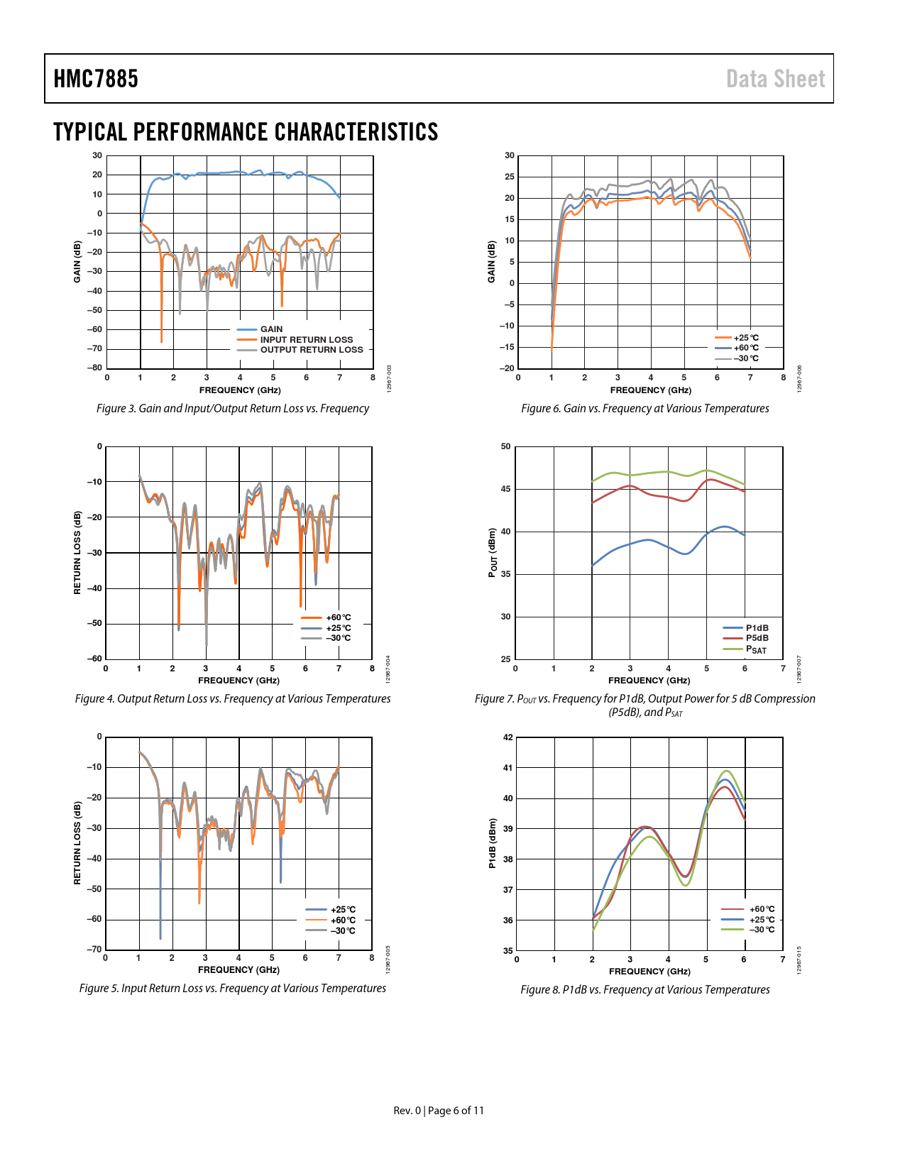

HMC7885. Data Sheet. TYPICAL PERFORMANCE CHARACTERISTICS. –10. d –20. N (. AI –30. –40. –50. –60. GAIN. INPUT RETURN LOSS. +25°C. –70
HMC7885 Data Sheet TYPICAL PERFORMANCE CHARACTERISTICS –10 d –20 N ( AI –30 –40 –50 –60 GAIN INPUT RETURN LOSS +25°C –70
HMC7885 Data Sheet TYPICAL PERFORMANCE CHARACTERISTICS 30 30 20 25 10 20 0 15 –10 10 B) B) d –20 d N ( N ( 5 AI –30 AI G G 0 –40 –5 –50 –60 GAIN –10 INPUT RETURN LOSS +25°C –70 OUTPUT RETURN LOSS –15 +60°C –30°C –80 –20
003 006
0 1 2 3 4 5 6 7 8 0 1 2 3 4 5 6 7 8 FREQUENCY (GHz)
12967-
FREQUENCY (GHz)
12967- Figure 3. Gain and Input/Output Return Loss vs. Frequency Figure 6. Gain vs. Frequency at Various Temperatures
0 50 –10 45 B) –20 d ( S 40 S Bm) O d –30 ( UT O URN L P 35 T RE –40 +60°C 30 –50 +25°C P1dB –30°C P5dB PSAT –60 25
004 007
0 1 2 3 4 5 6 7 8 0 1 2 3 4 5 6 7 FREQUENCY (GHz)
12967-
FREQUENCY (GHz)
12967- Figure 4. Output Return Loss vs. Frequency at Various Temperatures Figure 7. POUT vs. Frequency for P1dB, Output Power for 5 dB Compression (P5dB), and PSAT
0 42 –10 41 –20 40 B) d ( S S –30 Bm) 39 O d B ( –40 1d 38 URN L T P RE –50 37 +25°C +60°C –60 +60°C 36 +25°C –30°C –30°C –70 35
005
0 1 2 3 4 5 6 7 8
015
12967-
FREQUENCY (GHz)
12967- Figure 5. Input Return Loss vs. Frequency at Various Temperatures Figure 8. P1dB vs. Frequency at Various Temperatures Rev. 0 | Page 6 of 11 Document Outline FEATURES APPLICATIONS GENERAL DESCRIPTION FUNCTIONAL BLOCK DIAGRAM TABLE OF CONTENTS REVISION HISTORY SPECIFICATIONS ABSOLUTE MAXIMUM RATINGS ESD CAUTION PIN CONFIGURATION AND FUNCTION DESCRIPTIONS TYPICAL PERFORMANCE CHARACTERISTICS APPLICATIONS INFORMATION EVALUATION BOARD ASSEMBLY BILL OF MATERIALS OUTLINE DIMENSIONS ORDERING GUIDE
