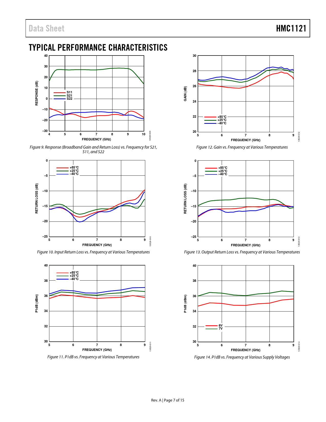

Description4 W, GaAs, pHEMT, MMIC Power Amplifier, 5.5 GHz to 8.5 GHz

Data Sheet. HMC1121. TYPICAL PERFORMANCE CHARACTERISTICS. ) B. SE (d. S11 S21. N (. S22. AI G. ESPO. –10. +85°C. –20. +25°C –40°C. –30
Data Sheet HMC1121 TYPICAL PERFORMANCE CHARACTERISTICS ) B SE (d S11 S21 N ( S22 AI G ESPO –10 +85°C –20 +25°C –40°C –30
Data Sheet HMC1121 TYPICAL PERFORMANCE CHARACTERISTICS 40 30 30 28 20 ) B 26 10 B) SE (d d N S11 S21 N ( 0 S22 AI G ESPO 24 R –10 22 +85°C –20 +25°C –40°C –30 20 4 5 6 7 8 9 10
009
5 6 7 8 9
012
FREQUENCY (GHz)
13529-
FREQUENCY (GHz)
13529- Figure 9. Response (Broadband Gain and Return Loss) vs. Frequency for S21, Figure 12. Gain vs. Frequency at Various Temperatures S11, and S22
0 0 +85°C +85°C +25°C +25°C –40°C –40°C –5 –5 B) B) d d ( –10 ( S –10 S S S O O URN L –15 URN L –15 T T RE RE –20 –20 –25 –25 5 6 7 8 9
010
5 6 7 8 9
013
FREQUENCY (GHz)
13529-
FREQUENCY (GHz)
13529- Figure 10. Input Return Loss vs. Frequency at Various Temperatures Figure 13. Output Return Loss vs. Frequency at Various Temperatures
40 40 +85°C +25°C –40°C 38 38 36 36 Bm) Bm) d d B ( B ( 1d 1d P 34 P 34 32 32 6V 7V 30
1
30
1
5 6 7 8 9
0
5 6 7 8 9
014
FREQUENCY (GHz)
13529-
FREQUENCY (GHz)
13529- Figure 11. P1dB vs. Frequency at Various Temperatures Figure 14. P1dB vs. Frequency at Various Supply Voltages Rev. A | Page 7 of 15 Document Outline Features Applications Functional Block Diagram General Description Revision History Specifications Electrical Specifications Absolute Maximum Ratings ESD Caution Pin Configuration and Function Descriptions Interface Schematics Typical Performance Characteristics Theory of Operation Applications Information Recommended Bias Sequence During Power-Up During Power-Down Typical Application Circuit Evaluation Board Bill of Materials Evaluation Board Schematic Outline Dimensions Ordering Guide
