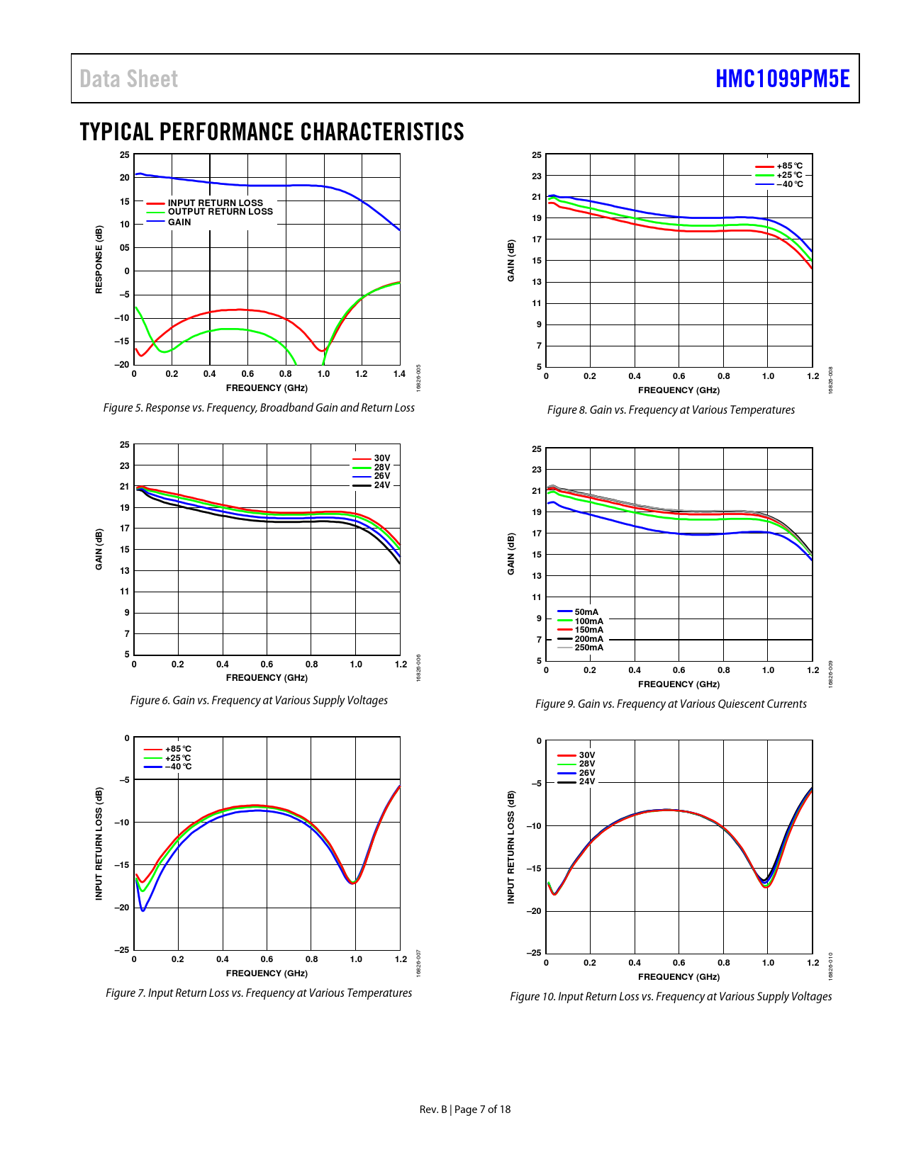

Data Sheet. HMC1099PM5E. TYPICAL PERFORMANCE CHARACTERISTICS. +85°C. +25°C – 40°C. INPUT RETURN LOSS OUTPUT RETURN LOSS. GAIN. SE (d
Data Sheet HMC1099PM5E TYPICAL PERFORMANCE CHARACTERISTICS +85°C +25°C – 40°C INPUT RETURN LOSS OUTPUT RETURN LOSS GAIN SE (d
Data Sheet HMC1099PM5E TYPICAL PERFORMANCE CHARACTERISTICS 25 25 +85°C 20 23 +25°C – 40°C 21 15 INPUT RETURN LOSS OUTPUT RETURN LOSS 19 ) 10 GAIN B 17 05 B) SE (d d N N ( 15 0 AI G ESPO 13 R –5 11 –10 9 –15 7 –20 5 0 0.2 0.4 0.6 0.8 1.0 1.2 1.4
005
008
FREQUENCY (GHz)
16826-
FREQUENCY (GHz)
16826- Figure 5. Response vs. Frequency, Broadband Gain and Return Loss Figure 8. Gain vs. Frequency at Various Temperatures
25 25 30V 23 28V 23 26V 21 24V 21 19 19 17 B) 17 d B) d N ( 15 15 AI N ( G AI 13 G 13 11 11 9 50mA 9 100mA 7 150mA 7 200mA 250mA 5 0 0.2 0.4 0.6 0.8 1.0 1.2
006
009
FREQUENCY (GHz)
16826-
FREQUENCY (GHz)
16826- Figure 6. Gain vs. Frequency at Various Supply Voltages Figure 9. Gain vs. Frequency at Various Quiescent Currents
0 0 +85°C +25°C 30V –40°C 28V 26V –5 –5 24V B) d B) ( d S ( S S O –10 S O –10 URN L T URN L T –15 RE –15 RE UT UT INP INP –20 –20 –25 –25 0 0.2 0.4 0.6 0.8 1.0 1.2
007
010
FREQUENCY (GHz)
16826-
FREQUENCY (GHz)
16826- Figure 7. Input Return Loss vs. Frequency at Various Temperatures Figure 10. Input Return Loss vs. Frequency at Various Supply Voltages Rev. B | Page 7 of 18 Document Outline Features Applications Functional Block Diagram General Description Revision History Specifications Electrical Specifications Total Quiescent Current by VDD Absolute Maximum Ratings Thermal Resistance ESD Caution Pin Configuration and Function Descriptions Interface Schematics Typical Performance Characteristics Theory of Operation Applications Information Evaluation PCB Outline Dimensions Ordering Guide
