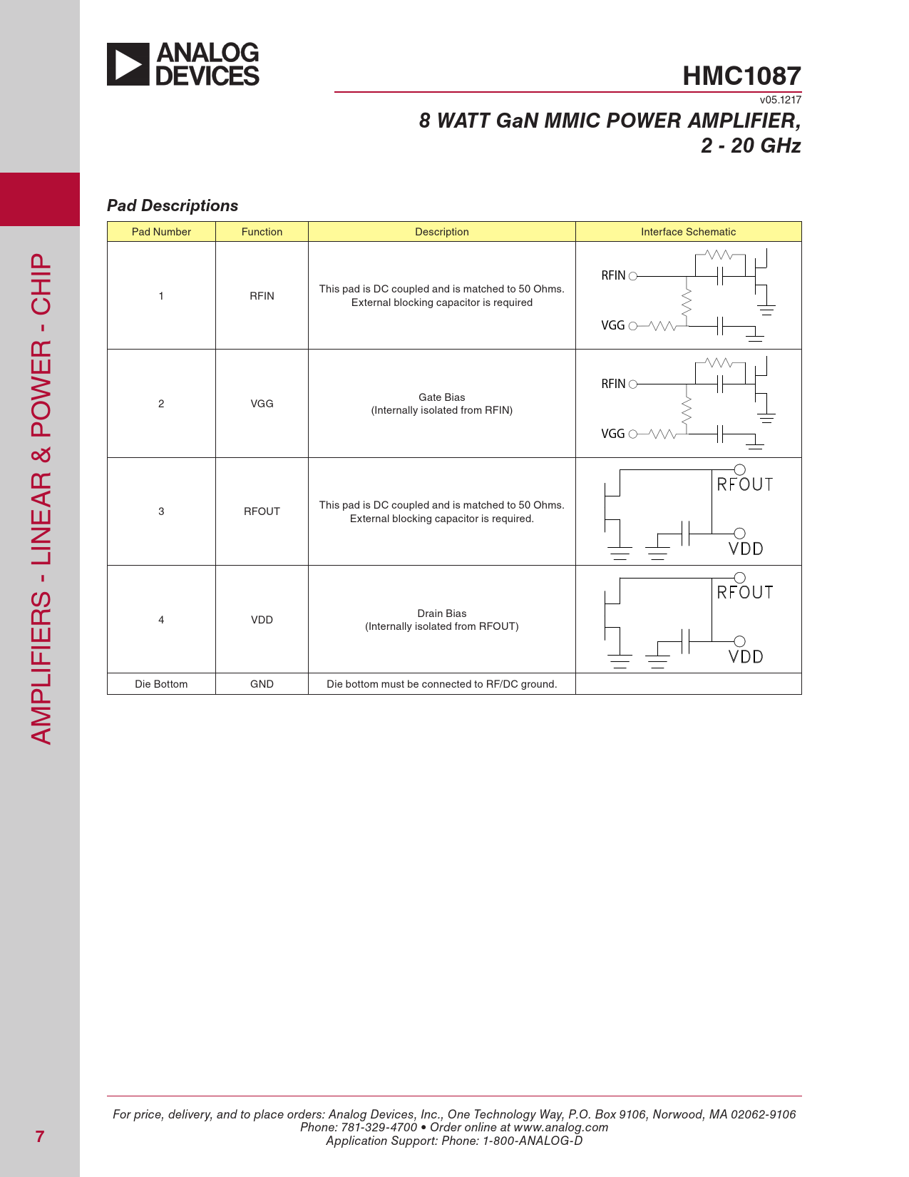

8 WATT GaN MMIC POWER AMPLIFIER, 2 - 20 GHz Pad Descriptions
Pad Number Function Description Interface Schematic IP H RFIN This pad is DC coupled and is matched to 50 Ohms. 1 RFIN External blocking capacitor is required VGG R - C E W RFIN O Gate Bias 2 VGG (Internally isolated from RFIN) VGG R & P A E This pad is DC coupled and is matched to 50 Ohms. 3 RFOUT External blocking capacitor is required. IN S - L R Drain Bias 4 VDD (Internally isolated from RFOUT) IE LIF P Die Bottom GND Die bottom must be connected to RF/DC ground. M A For price, delivery, and to place orders: Analog Devices, Inc., One Technology Way, P.O. Box 9106, Norwood, MA 02062-9106 Phone: 781-329-4700 • Order online at www.analog.com
