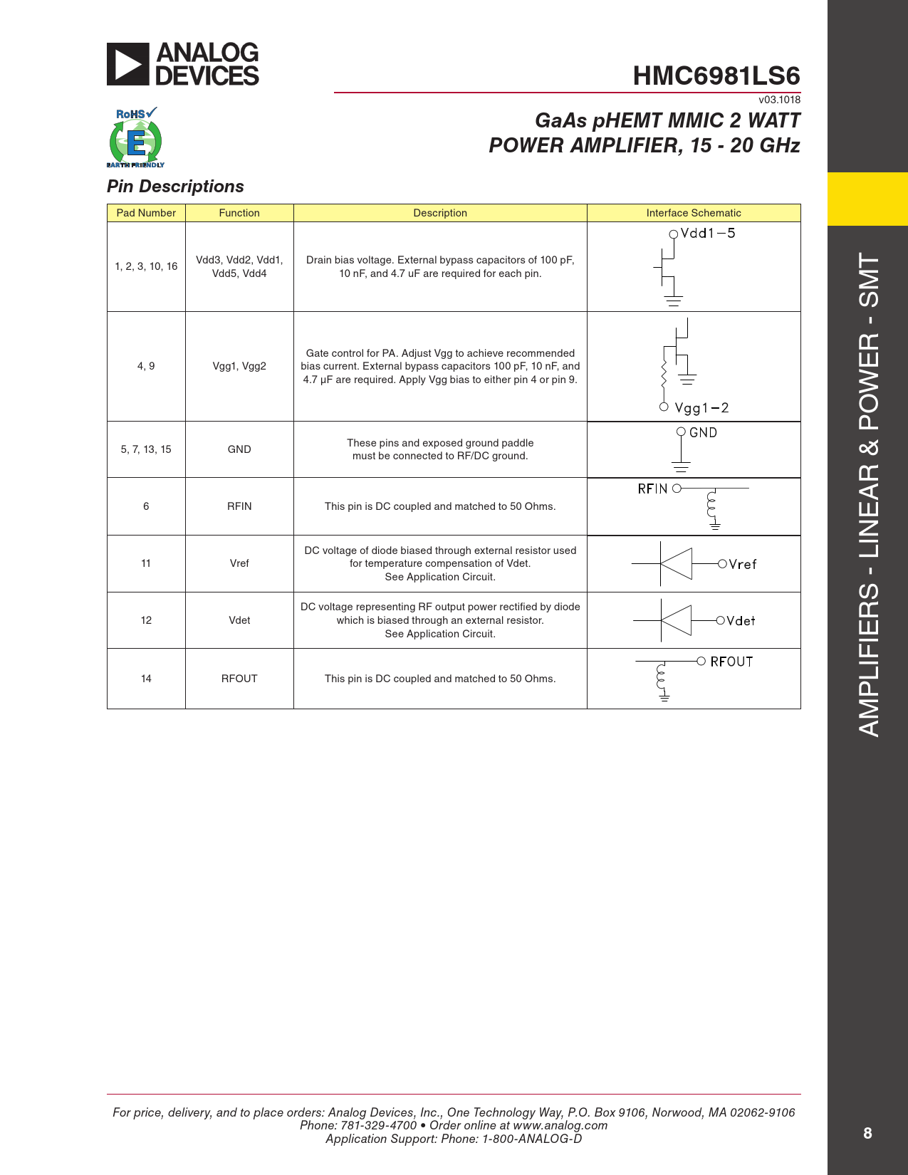

HMC6981LS6. GaAs pHEMT MMIC 2 WATT. POWER AMPLIFIER, 15 - 20 GHz. Pin Descriptions
HMC6981LS6 GaAs pHEMT MMIC 2 WATT POWER AMPLIFIER, 15 - 20 GHz Pin Descriptions
HMC6981LS6
v03.1018
pad number function Description interface schematic Vdd3, Vdd2, Vdd1, Drain bias voltage. external bypass capacitors of 100 pf, 1, 2, 3, 10, 16 T Vdd5, Vdd4 10 nf, and 4.7 uf are required for each pin. m s Gate control for pA. Adjust Vgg to achieve recommended r - 4, 9 Vgg1, Vgg2 bias current. external bypass capacitors 100 pf, 10 nf, and e 4.7 μf are required. Apply Vgg bias to either pin 4 or pin 9. w o p These pins and exposed ground paddle 5, 7, 13, 15 GnD must be connected to rf/DC ground. r & A 6 rfin This pin is DC coupled and matched to 50 ohms. e DC voltage of diode biased through external resistor used lin 11 Vref for temperature compensation of Vdet. see Application Circuit. s - DC voltage representing rf output power rectified by diode 12 Vdet which is biased through an external resistor. r see Application Circuit. ie 14 rfoUT This pin is DC coupled and matched to 50 ohms. lif p m A For price, delivery, and to place orders: Analog Devices, Inc., One Technology Way, P.O. Box 9106, Norwood, MA 02062-9106 Phone: 781-329-4700 • Order online at www.analog.com Application Support: Phone: 1-800-ANALOG-D
