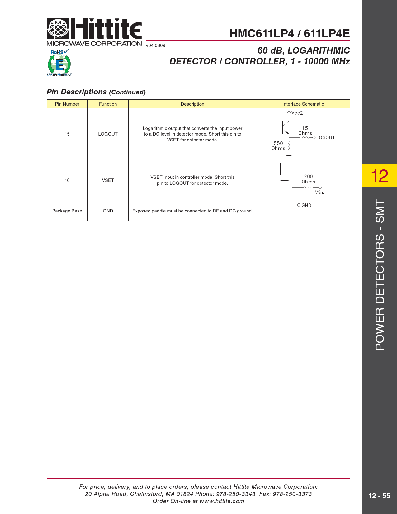

HMC611LP4 / 611LP4E. 60 dB, LOGARITHMIC. DETECTOR / CONTROLLER, 1 - 10000 MHz. Pin Descriptions (Continued). 12 - 55
HMC611LP4 / 611LP4E 60 dB, LOGARITHMIC DETECTOR / CONTROLLER, 1 - 10000 MHz Pin Descriptions (Continued) 12 - 55
HMC611LP4 / 611LP4E
v04.0309
Pin Number Function Description Interface Schematic Logarithmic output that converts the input power 15 LOGOUT to a DC level in detector mode. Short this pin to VSET for detector mode. VSET input in controller mode. Short this 16 VSET pin to LOGOUT for detector mode. 12 T Package Base GND Exposed paddle must be connected to RF and DC ground. S - SM R O T C E T E R D E W O P For price, delivery, and to place orders, please contact Hittite Microwave Corporation: 20 Alpha Road, Chelmsford, MA 01824 Phone: 978-250-3343 Fax: 978-250-3373
