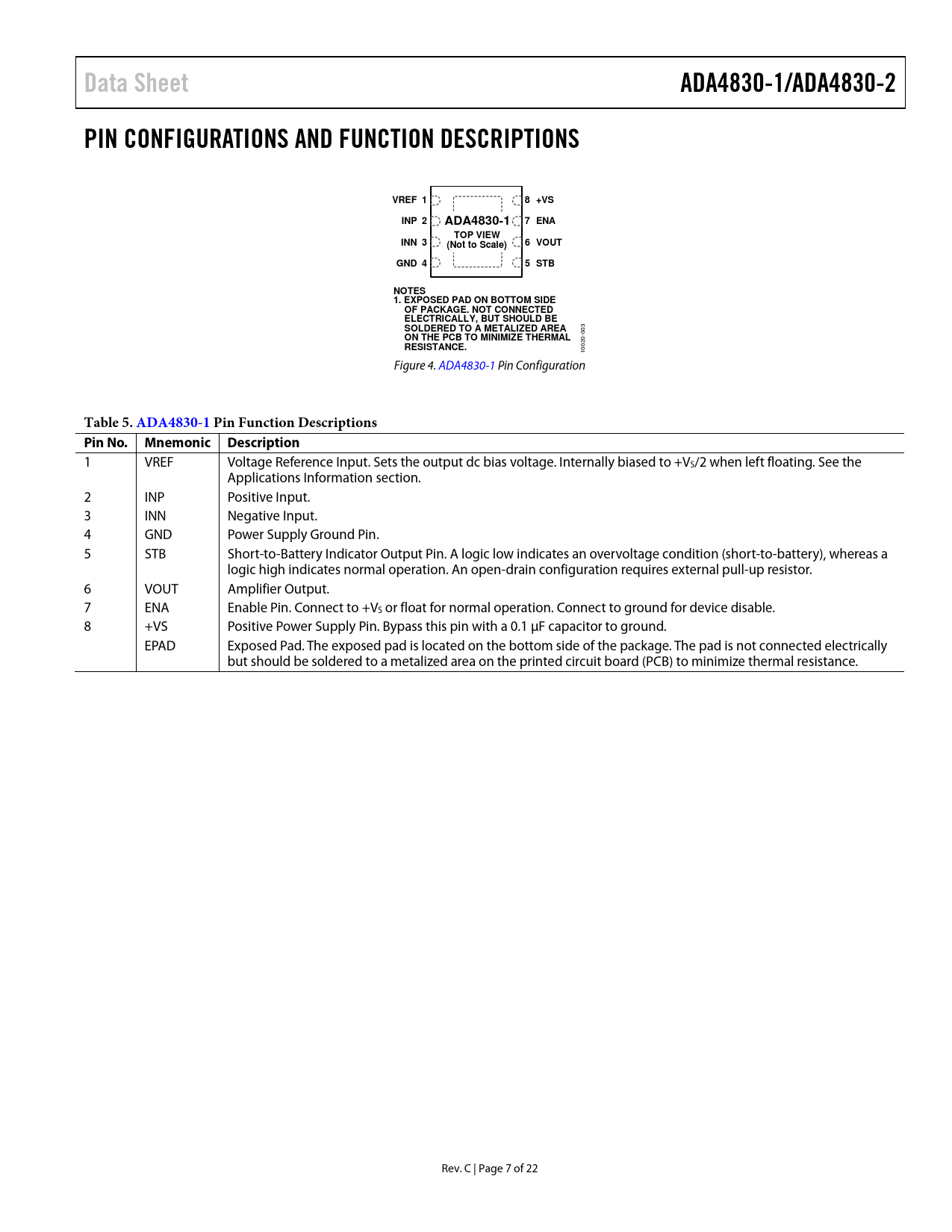

Data Sheet. ADA4830-1/ADA4830-2. PIN CONFIGURATIONS AND FUNCTION DESCRIPTIONS. VREF 1. 8 +VS. INP 2. ADA4830-1. 7 ENA. TOP VIEW. INN 3
Data Sheet ADA4830-1/ADA4830-2 PIN CONFIGURATIONS AND FUNCTION DESCRIPTIONS VREF 1 8 +VS INP 2 ADA4830-1 7 ENA TOP VIEW INN 3
link to page 14
Data Sheet ADA4830-1/ADA4830-2 PIN CONFIGURATIONS AND FUNCTION DESCRIPTIONS VREF 1 8 +VS INP 2 ADA4830-1 7 ENA TOP VIEW INN 3 6 VOUT (Not to Scale) GND 4 5 STB NOTES 1. EXPOSED PAD ON BOTTOM SIDE OF PACKAGE. NOT CONNECTED ELECTRICALLY, BUT SHOULD BE SOLDERED TO A METALIZED AREA
003
ON THE PCB TO MINIMIZE THERMAL RESISTANCE.
10020- Figure 4. ADA4830-1 Pin Configuration
Table 5. ADA4830-1 P in Function Descriptions Pin No. Mnemonic Description
1 VREF Voltage Reference Input. Sets the output dc bias voltage. Internally biased to +VS/2 when left floating. See the Applications Information section. 2 INP Positive Input. 3 INN Negative Input. 4 GND Power Supply Ground Pin. 5 STB Short-to-Battery Indicator Output Pin. A logic low indicates an overvoltage condition (short-to-battery), whereas a logic high indicates normal operation. An open-drain configuration requires external pull-up resistor. 6 VOUT Amplifier Output. 7 ENA Enable Pin. Connect to +VS or float for normal operation. Connect to ground for device disable. 8 +VS Positive Power Supply Pin. Bypass this pin with a 0.1 µF capacitor to ground. EPAD Exposed Pad. The exposed pad is located on the bottom side of the package. The pad is not connected electrically but should be soldered to a metalized area on the printed circuit board (PCB) to minimize thermal resistance. Rev. C | Page 7 of 22 Document Outline Features Applications General Description Functional Block Diagram Table of Contents Revision History Specifications 5 V Operation 3.3 V Operation Absolute Maximum Ratings Thermal Resistance Maximum Power Dissipation ESD Caution Pin Configurations and Function Descriptions Typical Performance Characteristics Theory of Operation Core Amplifier Overvoltage (Short-to-Battery) Protection Short-to-Battery Output Flag ESD Protection Power Supply Pins (ADA4830-2) Applications Information Methods of Transmission Pseudo Differential Mode (Unbalanced Source Termination) Pseudo Differential Mode (Balanced Source Impedance) Fully Differential Mode Voltage Reference (VREF Pin) Input Common-Mode Range Short-to-Battery Output Flag Pin Enable/Disable Modes (ENA Pin) PCB Layout Exposed Paddle (EPAD) Connection Using the ADA4830-2 as a Low Cost Video Switch Driving Capacitive Loads Typical Applications Circuits Fully DC-Coupled Transmission Line Packaging and Ordering Information Outline Dimensions Ordering Guide Automotive Products
