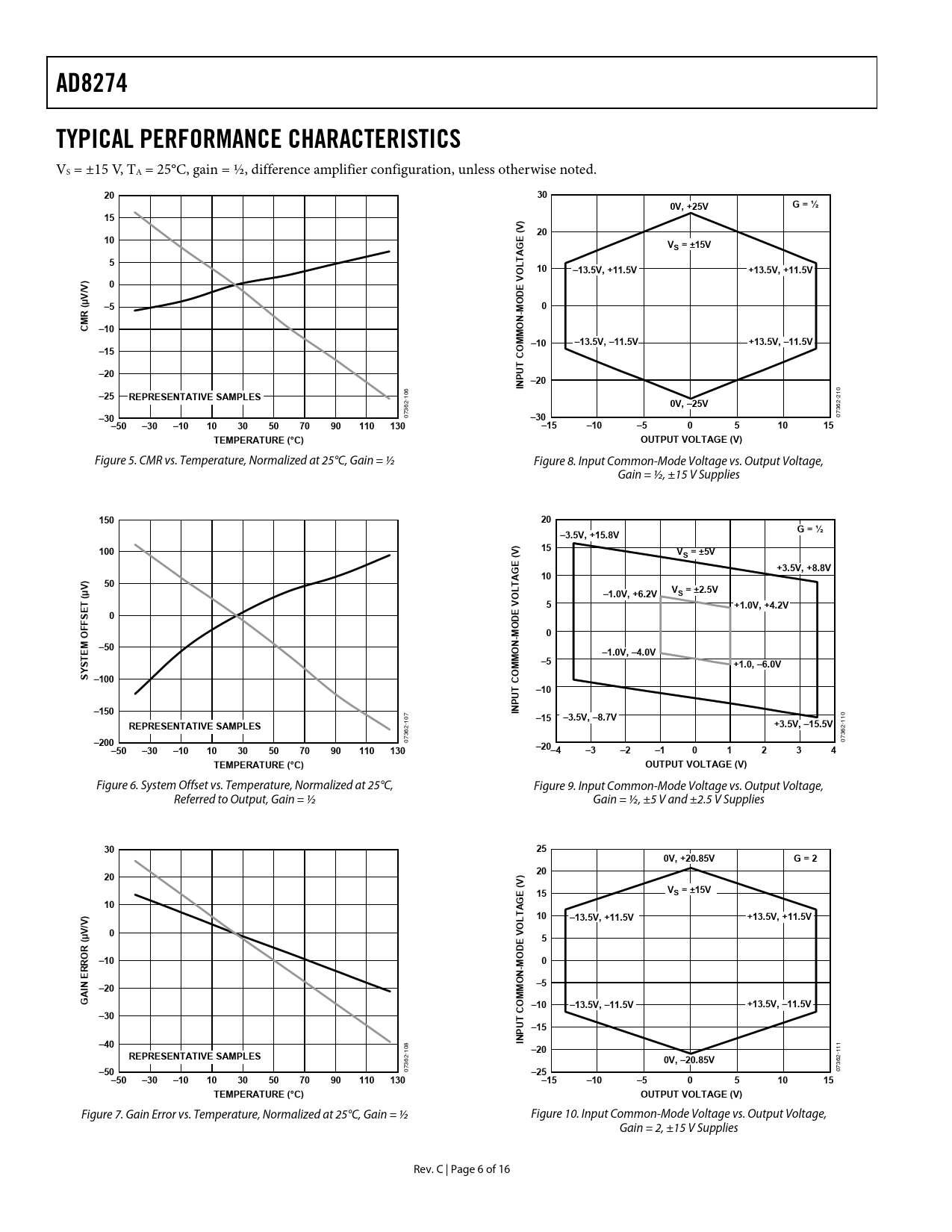

VS = ±15 V, TA = 25°C, gain = ½, difference amplifier configuration, unless otherwise noted.

Figure 5. CMR vs. Temperature, Normalized at 25°C, Gain = ½ Figure 8. Input Common-Mode Voltage vs. Output Voltage, Gain = ½, ±15 V Supplies

Figure 6. System Offset vs. Temperature, Normalized at 25°C, Figure 9. Input Common-Mode Voltage vs. Output Voltage, Referred to Output, Gain = ½ Gain = ½, ±5 V and ±2.5 V Supplies

Figure 7. Gain Error vs. Temperature, Normalized at 25°C, Gain = ½ Figure 10. Input Common-Mode Voltage vs. Output Voltage, Gain = 2, ±15 V Supplies Rev. C | Page 6 of 16 Document Outline FEATURES APPLICATIONS GENERAL DESCRIPTION FUNCTIONAL BLOCK DIAGRAM TABLE OF CONTENTS REVISION HISTORY SPECIFICATIONS ABSOLUTE MAXIMUM RATINGS THERMAL RESISTANCE MAXIMUM POWER DISSIPATION SHORT-CIRCUIT CURRENT ESD CAUTION PIN CONFIGURATIONS AND FUNCTION DESCRIPTION TYPICAL PERFORMANCE CHARACTERISTICS THEORY OF OPERATION CIRCUIT INFORMATION DC Performance AC Performance Production Costs Size DRIVING THE AD8274 POWER SUPPLIES INPUT VOLTAGE RANGE CONFIGURATIONS DRIVING CABLING OUTLINE DIMENSIONS ORDERING GUIDE
