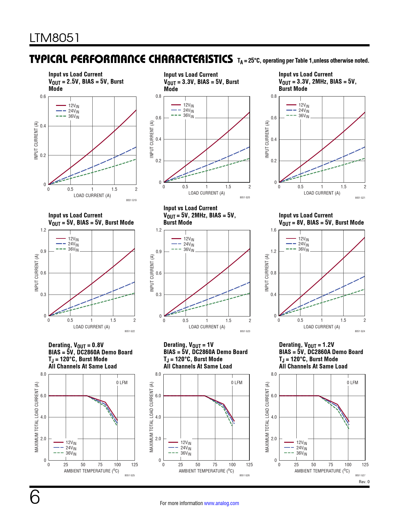

TYPICAL PERFORMANCE CHARACTERISTICS TA = 25°C, operating per Table 1,unless other. wise noted. Input vs Load Current
TYPICAL PERFORMANCE CHARACTERISTICS TA = 25°C, operating per Table 1,unless other wise noted Input vs Load Current
link to page 16 LTM8051
TYPICAL PERFORMANCE CHARACTERISTICS TA = 25°C, operating per Table 1,unless other wise noted. Input vs Load Current Input vs Load Current Input vs Load Current VOUT = 2.5V, BIAS = 5V, Burst Input vs Load Current, VOUT = 2.5V VOUT = 3.3V, BIAS = 5V, Burst Input vs Load Current, VOUT = 3.3V VOUT = 3.3V, 2MHz, BIAS = 5V, Input vs Load Current, VOUT = 3.3V, 2MHz Mode BIAS = 5V, Burst Mode Mode BIAS = 5V, Burst Mode Burst Mode BIAS = 5V, Burst Mode
0.6 0.8 0.8 12VIN 12VIN 12VIN 24VIN 24VIN 24VIN 36VIN 36VIN 0.6 36VIN 0.6 0.4 0.4 0.4 0.2 INPUT CURRENT (A) INPUT CURRENT (A) INPUT CURRENT (A) 0.2 0.2 0 0 0 0 0.5 1 1.5 2 0 0.5 1 1.5 2 0 0.5 1 1.5 2 LOAD CURRENT (A) LOAD CURRENT (A) LOAD CURRENT (A) 8051 G20 8051 G21 8051 G19
Input vs Load Current Input vs Load Current Input vs Load Current, VOUT = 5V VOUT = 5V, 2MHz, BIAS = 5V, Input vs Load Current, VOUT = 5V, 2MHz Input vs Load Current Input vs Load Current, VOUT = 8V VOUT = 5V, BIAS = 5V, Burst Mode BIAS = 5V, Burst Mode Burst Mode BIAS = 5V, Burst Mode VOUT = 8V, BIAS = 5V, Burst Mode BIAS = 5V, Burst Mode
1.2 1.2 1.6 12VIN 12VIN 12VIN 24VIN 24VIN 24VIN 36VIN 0.9 36VIN 0.9 36VIN 1.2 0.6 0.6 0.8 INPUT CURRENT (A) INPUT CURRENT (A) INPUT CURRENT (A) 0.3 0.3 0.4 0 0 0 0 0.5 1 1.5 2 0 0.5 1 1.5 2 0 0.5 1 1.5 2 LOAD CURRENT (A) LOAD CURRENT (A) LOAD CURRENT (A) 8051 G22 8051 G23 8051 G24
Derating, VOUT Derating, V = 0.8V Derating, V OUT = 0.8V OUT = 1V Derating, V OUT = 1V OUT Derating, V = 1.2V OUT = 1.2V BIAS = 5V, DC2860A Demo Board BIAS = 5V, DC2860A Demo Bd BIAS = 5V, DC2860A Demo Board BIAS = 5V, DC2860A Demo Bd BIAS = 5V, DC2860A Demo Board BIAS = 5V, DC2860A Demo Bd TJ T = 120°C, Burst Mode T JMAX = 120oC, Burst Mode J = 120°C, Burst Mode T JMAX = 120oC, Burst Mode J T = 120°C, Burst Mode JMAX = 120oC, Burst Mode All Channels At Same Load All Channels At Same Load All Channels At Same Load
8.0 8.0 8.0 0 LFM 0 LFM 0 LFM 6.0 6.0 6.0 4.0 4.0 4.0 AL LOAD CURRENT (A) AL LOAD CURRENT (A) AL LOAD CURRENT (A) 2.0 2.0 2.0 12VIN 12VIN 12VIN 24VIN 24V 24V MAXIMUM TOT IN IN 36V MAXIMUM TOT MAXIMUM TOT IN 36VIN 36VIN 0 0 0 0 25 50 75 100 125 0 25 50 75 100 125 0 25 50 75 100 125 AMBIENT TEMPERATURE (oC) AMBIENT TEMPERATURE (oC) AMBIENT TEMPERATURE (oC) 8051 G25 8051 G26 8051 G27 Rev. 0 6 For more information www.analog.com Document Outline Features Applications Typical Application Description Absolute Maximum Ratings Pin Configuration Order Information Electrical Characteristics Typical Performance Characteristics Pin Functions Block Diagram Operation Applications Information Typical Applications Package Description Package Photo Design Resources Related Parts
