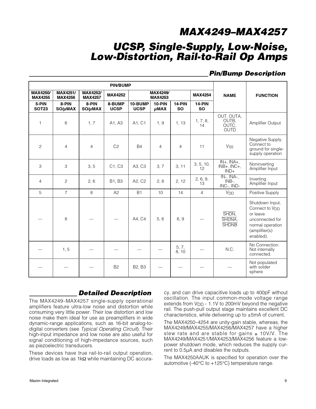

MAX4249–MAX4257 UCSP, Single-Supply, Low-Noise, Low-Distortion, Rail-to-Rail Op Amps Pin/Bump Description
PIN/BUMP M A X4 2 5 0 / M A X4 2 5 1 / M A X4 2 5 2 / M A X4 2 4 9 / M A X4 2 5 2 M A X4 2 5 4 M A X4 2 5 5 M A X4 2 5 6 M A X4 2 5 7 M A X4 2 5 3 NAME FUNCTION 5-PIN 8-PIN 8-PIN 8-BUMP 10-BUMP 10-PIN 1 4 - PIN 14-PIN SOT23 SO/µMAX SO/µMAX UCSP UCSP µMAX SO SO
OUT, OUTA, 1 6 1, 7 A1, A3 A1, C1 1, 9 1, 13 1, 7, 8, OUTB, 14 OUTC, Amplifier Output OUTD Negative Supply. 2 4 4 C2 B4 4 4 11 V Connect to SS ground for single- supply operation IN + , IN A+ , 3 3 3, 5 C1, C3 A3, C3 3, 7 3, 11 3, 5, 10, Noninverting 12 IN B+ , IN C + , IN D + Amplifier Input IN-, INA-, 4 2 2, 6 B1, B3 A2, C2 2, 8 2, 12 2, 6, 9, Inverting 13 INB-, INC-, IND- Amplifier Input 5 7 8 A2 B1 10 14 4 VDD Positive Supply Shutdown Input, Connect to VDD SHDN, or leave — 8 — — A4, C4 5, 6 6, 9 — SHDNA, unconnected for SHDNB normal operation (amplifier(s) enabled). No Connection. — 1, 5 — — — — 5, 7, 8, 10 — N.C. Not internally connected. Not populated — — — B2 B2, B3 — — — — with solder sphere Detailed Description cy, and can drive capacitive loads up to 400pF without oscillation. The input common-mode voltage range The MAX4249–MAX4257 single-supply operational extends from V amplifiers feature ultra-low noise and distortion while DD - 1.1V to 200mV beyond the negative rail. The push-pull output stage maintains excellent DC consuming very little power. Their low distortion and low characteristics, while delivering up to ±5mA of current. noise make them ideal for use as preamplifiers in wide dynamic-range applications, such as 16-bit analog-to- The MAX4250–4254 are unity-gain stable, whereas, the digital converters (see Typical Operating Circuit). Their MAX4249/MAX4255/MAX4256/MAX4257 have a higher high-input impedance and low noise are also useful for slew rate and are stable for gains # 10V/V. The signal conditioning of high-impedance sources, such MAX4249/MAX4251/MAX4253/MAX4256 feature a low- as piezoelectric transducers. power shutdown mode, which reduces the supply cur- rent to 0.5µA and disables the outputs. These devices have true rail-to-rail output operation, drive loads as low as 1k" while maintaining DC accura- The MAX4250AAUK is specified for operation over the automotive (-40°C to +125°C) temperature range. Maxim Integrated 9
