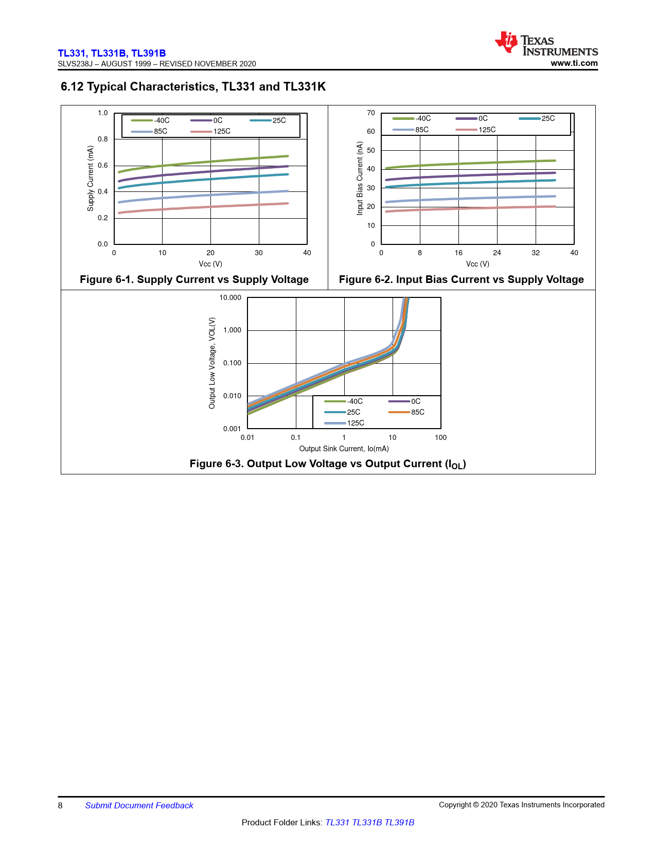

TL331, TL331B, TL391B. www.ti.com. 6.12 Typical Characteristics, TL331 and TL331K
TL331, TL331B, TL391B www.ti.com 6.12 Typical Characteristics, TL331 and TL331K
SLVS238J – AUGUST 1999 – REVISED NOVEMBER 2020
1.0 70 -40C 0C 25C -40C 0C 25C 85C 125C 60 85C 125C 0.8 ) A A 50 (n (m t t n 0.6 n re 40 re Cur Cur 30 ly 0.4 ias p B p t u u S p 20 In 0.2 10 0.0 0 0 10 20 30 40 0 8 16 24 32 40 Vcc (V) C001 Vcc (V) C002
Figure 6-1. Supply Current vs Supply Voltage Figure 6-2. Input Bias Current vs Supply Voltage
10.000 ) (V 1.000 OL V , e g lta o 0.100 V w o L t u tp 0.010 -40C 0C Ou 25C 85C 125C 0.001 0.01 0.1 1 10 100 Output Sink Current, Io(mA) C005
Figure 6-3. Output Low Voltage vs Output Current (IOL)
