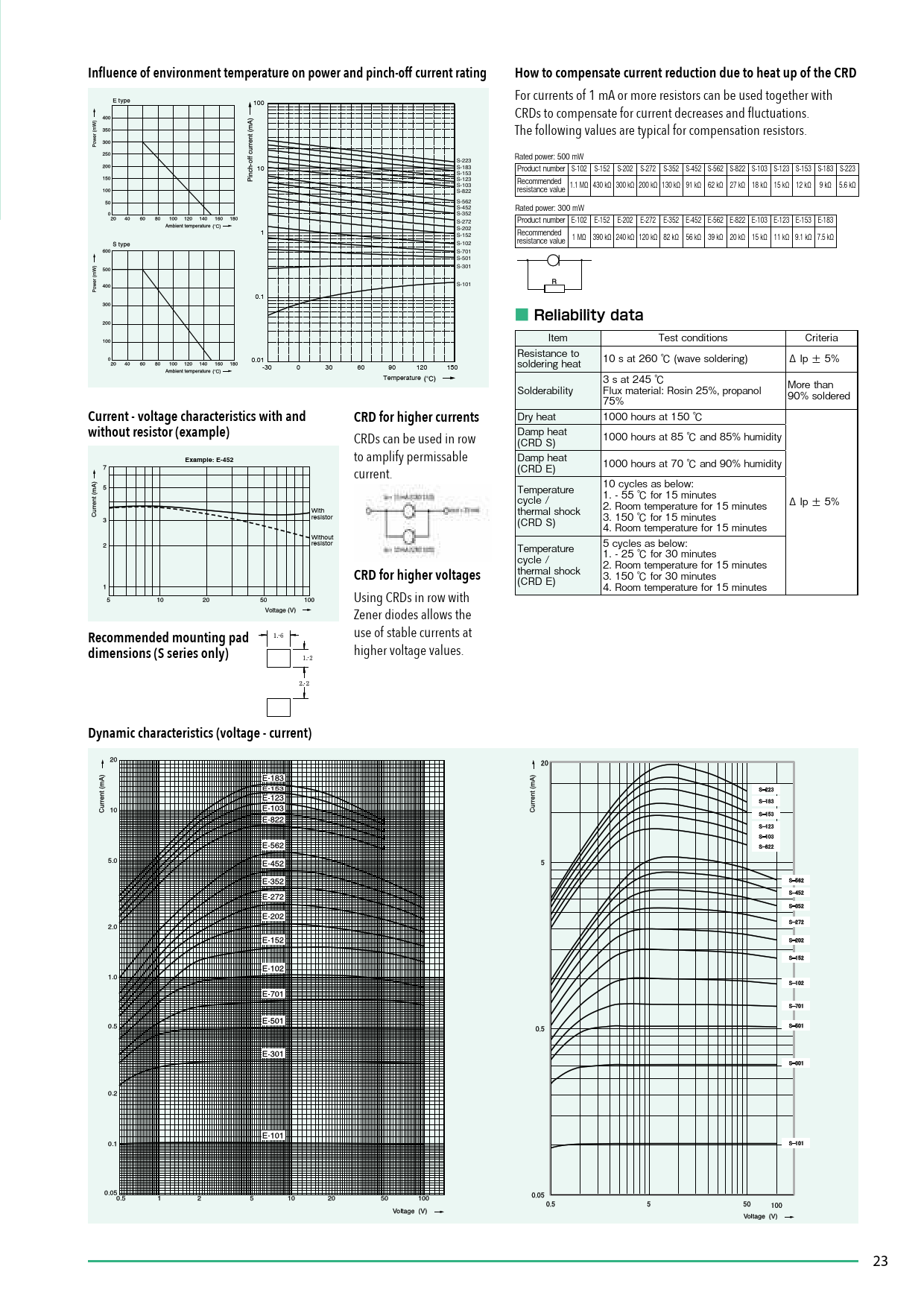

Pages / Page2 / 2 — Influence of environment temperature on power and pinch-off current rating
File Format / SizePDF / 238 Kb
Influence of environment temperature on power and pinch-off current rating How to compensate current reduction due to heat up of the CRD
For currents of 1 mA or more resistors can be used together with 100 CRDs to compensate for current decreases and fluctuations. The following values are typical for compensation resistors. Rated power: 500 mW S-223 10 S-183 Product number S-102 S-152 S-202 S-272 S-352 S-452 S-562 S-822 S-103 S-123 S-153 S-183 S-223 S-153 S-123 Recommended S-103 S-822 resistance value 1.1 MΩ 430 kΩ 300 kΩ 200 kΩ 130 kΩ 91 kΩ 62 kΩ 27 kΩ 18 kΩ 15 kΩ 12 kΩ 9 kΩ 5.6 kΩ S-562 S-452 Rated power: 300 mW S-352 S-272 Product number E-102 E-152 E-202 E-272 E-352 E-452 E-562 E-822 E-103 E-123 E-153 E-183 1 S-202 Recommended S-152 resistance value 1 MΩ 390 kΩ 240 kΩ 120 kΩ 82 kΩ 56 kΩ 39 kΩ 20 kΩ 15 kΩ 11 kΩ 9.1 kΩ 7.5 kΩ S-102 S-701 S-501 S-301 S-101 0.1

Current - voltage characteristics with and CRD for higher currents
Dry heat 1000 hours at 150 ℃
without resistor (example)
CRDs can be used in row Damp heat (CRD S) 1000 hours at 85 ℃ and 85% humidity
Example: E-452
to amplify permissable Damp heat current. (CRD E) 1000 hours at 70 ℃ and 90% humidity Temperature 10 cycles as below: cycle / 1. - 55 ℃ for 15 minutes Δ Ip ± 5% 2. Room temperature for 15 minutes With thermal shock resistor (CRD S) 3. 150 ℃ for 15 minutes 4. Room temperature for 15 minutes Without resistor Temperature 5 cycles as below: cycle / 1. - 25 ℃ for 30 minutes 2. Room temperature for 15 minutes
CRD for higher voltages
thermal shock (CRD E) 3. 150 ℃ for 30 minutes 4. Room temperature for 15 minutes Using CRDs in row with Zener diodes allows the

Dynamic characteristics (voltage - current)
