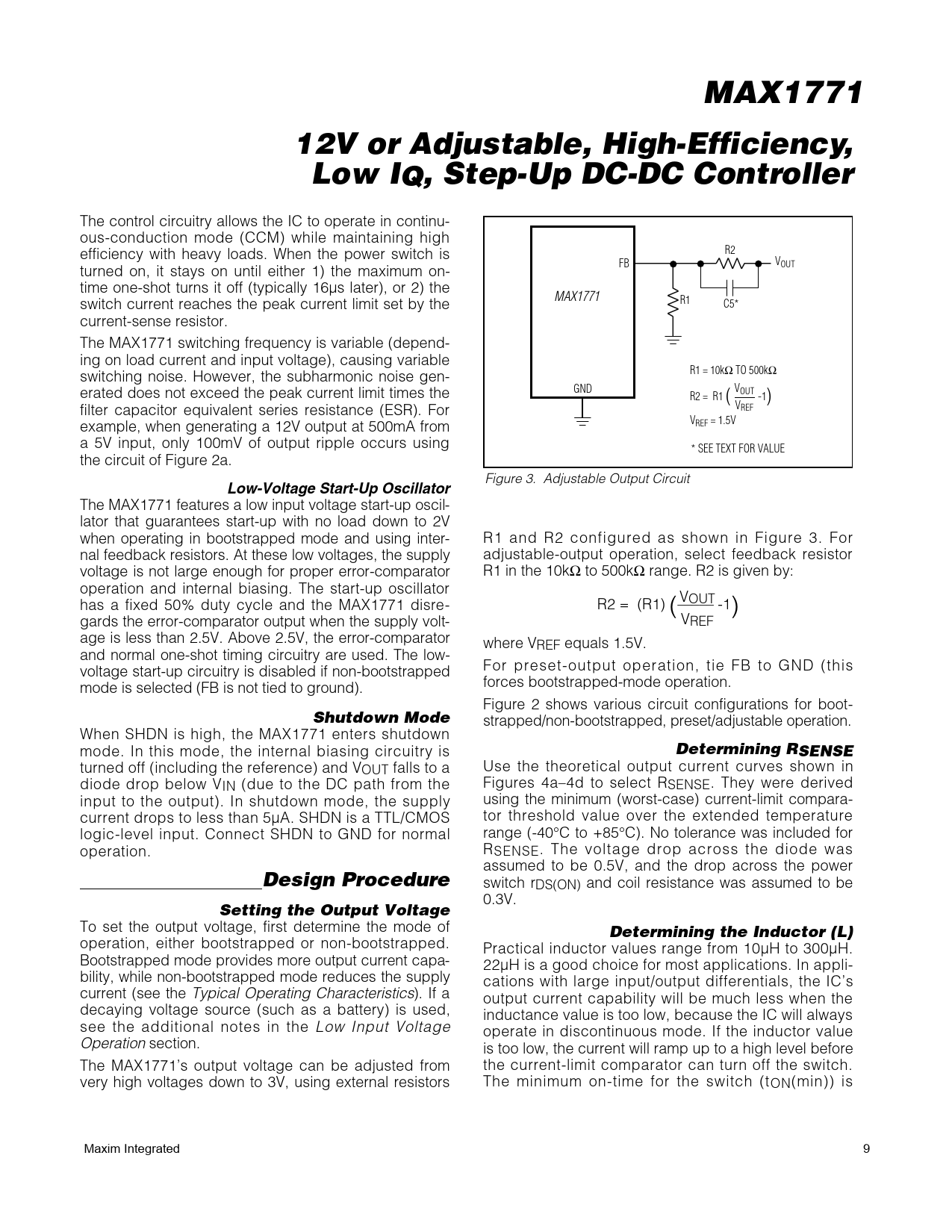

The control circuitry allows the IC to operate in continu- ous-conduction mode (CCM) while maintaining high efficiency with heavy loads. When the power switch is R2 FB VOUT turned on, it stays on until either 1) the maximum on- time one-shot turns it off (typically 16µs later), or 2) the MAX1771 switch current reaches the peak current limit set by the R1 C5* current-sense resistor. The MAX1771 switching frequency is variable (depend- ing on load current and input voltage), causing variable switching noise. However, the subharmonic noise gen- R1 = 10kΩ TO 500kΩ erated does not exceed the peak current limit times the GND VOUT R2 = R1 ( -1) filter capacitor equivalent series resistance (ESR). For VREF example, when generating a 12V output at 500mA from VREF = 1.5V a 5V input, only 100mV of output ripple occurs using * SEE TEXT FOR VALUE the circuit of Figure 2a. Figure 3. Adjustable Output Circuit

The MAX1771 features a low input voltage start-up oscil- lator that guarantees start-up with no load down to 2V when operating in bootstrapped mode and using inter- R1 and R2 configured as shown in Figure 3. For nal feedback resistors. At these low voltages, the supply adjustable-output operation, select feedback resistor voltage is not large enough for proper error-comparator R1 in the 10kΩ to 500kΩ range. R2 is given by: operation and internal biasing. The start-up oscillator V has a fixed 50% duty cycle and the MAX1771 disre- OUT R2 = (R1) (––––– -1) gards the error-comparator output when the supply volt- VREF age is less than 2.5V. Above 2.5V, the error-comparator where VREF equals 1.5V. and normal one-shot timing circuitry are used. The low- voltage start-up circuitry is disabled if non-bootstrapped For preset-output operation, tie FB to GND (this mode is selected (FB is not tied to ground). forces bootstrapped-mode operation. Figure 2 shows various circuit configurations for boot-
