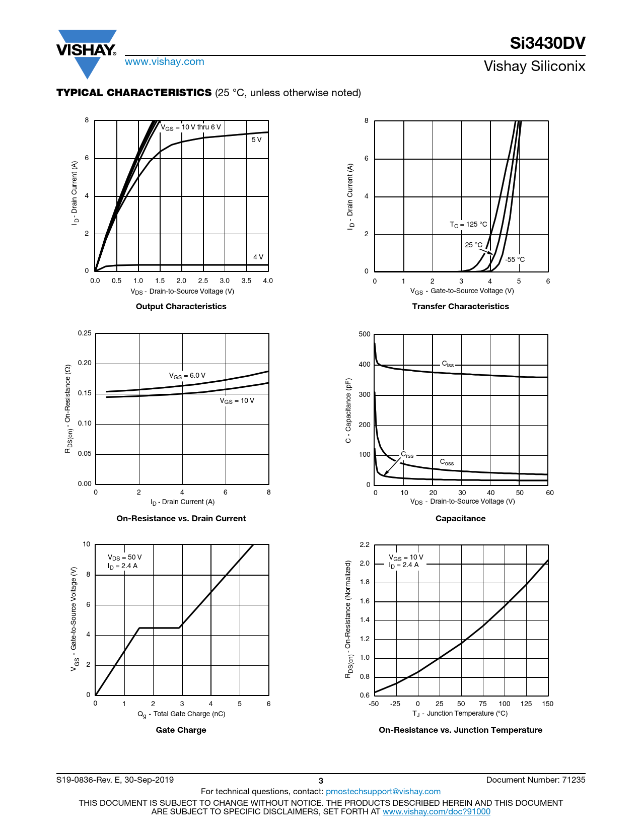

Si3430DV. TYPICAL CHARACTERISTICS. Output Characteristics. Transfer Characteristics. On-Resistance vs. Drain Current. Capacitance
Si3430DV TYPICAL CHARACTERISTICS Output Characteristics Transfer Characteristics On-Resistance vs Drain Current Capacitance
Si3430DV
(25 °C, unless otherwise noted) 8 8 VGS = 10 V thru 6 V 5 V 6 6 4 4 rain Current (A) ain Current (A) D - - Dr I D TC = 125 °C I D 2 2 25 °C 4 V -55 °C 0 0 0.0 0.5 1.0 1.5 2.0 2.5 3.0 3.5 4.0 0 1 2 3 4 5 6 VDS - Drain-to-Source Voltage (V) VGS - Gate-to-Source Voltage (V)
0.25 500 ) 0.20 400 C iss ( VGS = 6.0 V 0.15 300 V esistance GS = 10 V -R - On 0.10 200 - Capacitance (pF) C DS(on)R 0.05 100 rss C Coss 0.00 0 0 2 4 6 8 0 10 20 30 40 50 60 ID - Drain Current (A) VDS - Drain-to-Source Voltage (V)
On-Resistance vs. Drain Current Capacitance
10 2.2 VDS = 50 V VGS = 10 V I 2.0 D = 2.4 A ID = 2.4 A ed) 8 1.8 maliz oltage (V) V (Nor 1.6 6 1.4 4 1.2 - Gate-to-Source - On-Resistance 1.0 GS 2 V DS(on)R 0.8 0 0.6 0 1 2 3 4 5 6 -50 -25 0 25 50 75 100 125 150 Qg - Total Gate Charge (nC) TJ - Junction Temperature (°C)
Gate Charge On-Resistance vs. Junction Temperature
