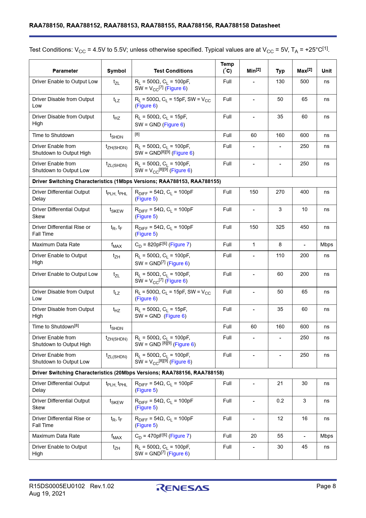

Test Conditions: VCC = 4.5V to 5.5V; unless otherwise specified. Typical values are at VCC = 5V, TA = +25°C[1].
Temp Parameter Symbol Test Conditions (°C) Min[2] Typ Max[2] Unit
Driver Enable to Output Low tZL RL = 500Ω, CL = 100pF, Full - 130 500 ns SW = V [7] CC (Figure 6) Driver Disable from Output tLZ RL = 500Ω, CL = 15pF, SW = VCC Full - 50 65 ns Low (Figure 6) Driver Disable from Output tHZ RL = 500Ω, CL = 15pF, Full - 35 60 ns High SW = GND (Figure 6) Time to Shutdown t [8] SHDN Full 60 160 600 ns Driver Enable from tZH(SHDN) RL = 500Ω, CL = 100pF, Full - - 250 ns Shutdown to Output High SW = GND[8][9] (Figure 6) Driver Enable from tZL(SHDN) RL = 500Ω, CL = 100pF, Full - - 250 ns Shutdown to Output Low SW = V [8][9] CC (Figure 6)
Driver Switching Characteristics (1Mbps Versions; RAA788153, RAA788155)
Driver Differential Output tPLH, tPHL RDIFF = 54Ω, CL = 100pF Full 150 270 400 ns Delay (Figure 5) Driver Differential Output tSKEW RDIFF = 54Ω, CL = 100pF Full - 3 10 ns Skew (Figure 5) Driver Differential Rise or tR, tF RDIFF = 54Ω, CL = 100pF Full 150 325 450 ns Fall Time (Figure 5) Maximum Data Rate fMAX CD = 820pF[6] (Figure 7) Full 1 8 - Mbps Driver Enable to Output tZH RL = 500Ω, CL = 100pF, Full - 110 200 ns High SW = GND[7] (Figure 6) Driver Enable to Output Low tZL RL = 500Ω, CL = 100pF, Full - 60 200 ns SW = V [7] CC (Figure 6) Driver Disable from Output tLZ RL = 500Ω, CL = 15pF, SW = VCC Full - 50 65 ns Low (Figure 6) Driver Disable from Output tHZ RL = 500Ω, CL = 15pF, Full - 35 60 ns High SW = GND (Figure 6) Time to Shutdown[8] tSHDN Full 60 160 600 ns Driver Enable from tZH(SHDN) RL = 500Ω, CL = 100pF, Full - - 250 ns Shutdown to Output High SW = GND [8][9] (Figure 6) Driver Enable from tZL(SHDN) RL = 500Ω, CL = 100pF, Full - - 250 ns Shutdown to Output Low SW = V [8][9] CC (Figure 6)
Driver Switching Characteristics (20Mbps Versions; RAA788156, RAA788158)
Driver Differential Output tPLH, tPHL RDIFF = 54Ω, CL = 100pF Full - 21 30 ns Delay (Figure 5) Driver Differential Output tSKEW RDIFF = 54Ω, CL = 100pF Full - 0.2 3 ns Skew (Figure 5) Driver Differential Rise or tR, tF RDIFF = 54Ω, CL = 100pF Full - 12 16 ns Fall Time (Figure 5) Maximum Data Rate fMAX CD = 470pF[6] (Figure 7) Full 20 55 - Mbps Driver Enable to Output tZH RL = 500Ω, CL = 100pF, Full - 30 45 ns High SW = GND[7] (Figure 6) R15DS0005EU0102 Rev.1.02 Page 8 Aug 19, 2021 Document Outline Features Applications Contents 1. Overview 1.1 Typical Operating Circuit 2. Pin Information 2.1 Pin Assignments 2.2 Pin Descriptions 3. Specifications 3.1 Absolute Maximum Ratings 3.2 Recommended Operating Conditions 3.3 Thermal Information 3.4 Electrical Specifications 4. Test Circuits and Waveforms 5. Typical Performance Curves 6. Device Description 6.1 Overview 6.2 Functional Block Diagram 6.3 Operating Modes 6.3.1 Driver Operation 6.3.2 Receiver Operation 6.4 Device Features 6.4.1 Large Output Signal Swing 6.4.2 Driver Overload Protection 6.4.3 Full-Failsafe Receiver 6.4.4 Low Current Shutdown Mode 6.4.5 Hot Plug Function 6.4.6 High EFT Immunity 6.4.7 High ESD Protection 7. Application Information 7.1 Network Design 7.1.1 Cable Type 7.1.2 Cable Length vs Data Rate 7.1.3 Topologies and Stub Lengths 7.1.4 Minimum Distance between Nodes 7.1.5 Failsafe Biasing Termination 7.2 Transient Protection 7.3 Layout Guidelines 7.3.1 Layout Example 8. Package Outline Drawings 9. Ordering Information 10. Revision History
