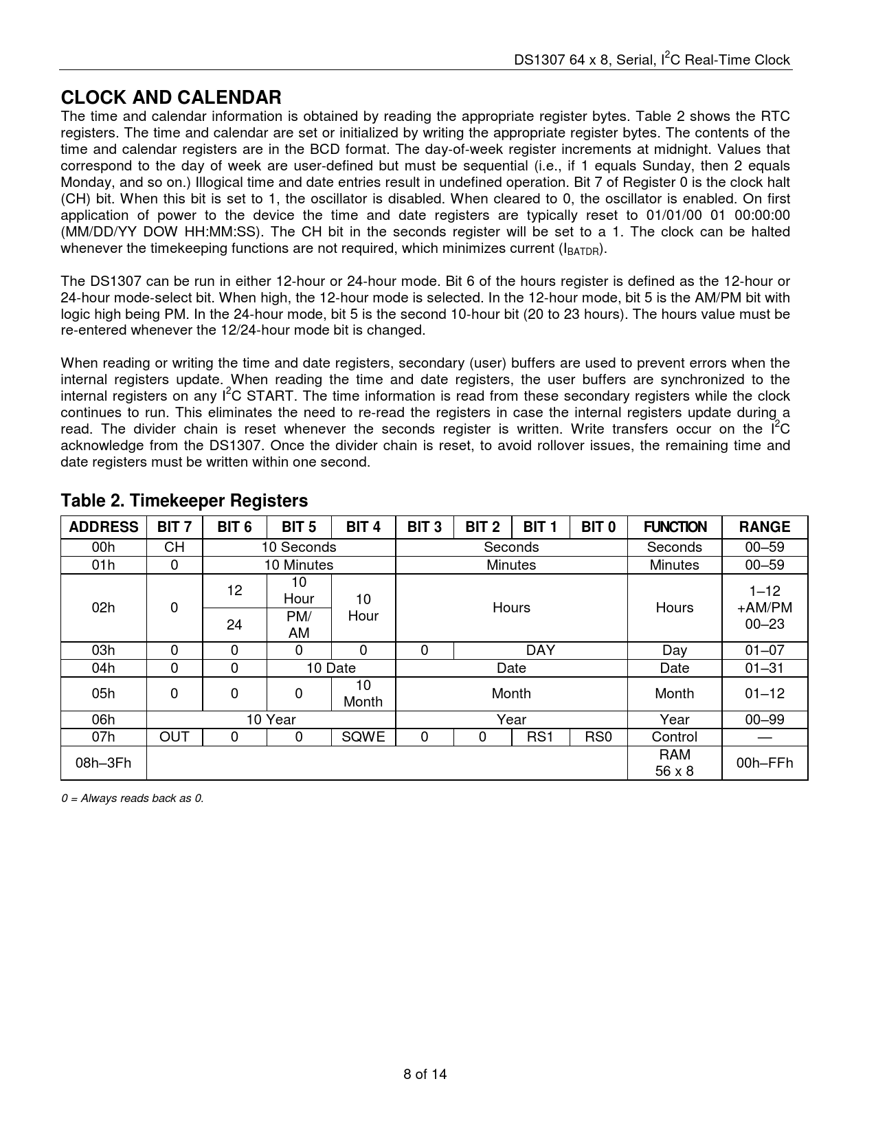

CLOCK AND CALENDAR
The time and calendar information is obtained by reading the appropriate register bytes. Table 2 shows the RTC registers. The time and calendar are set or initialized by writing the appropriate register bytes. The contents of the time and calendar registers are in the BCD format. The day-of-week register increments at midnight. Values that correspond to the day of week are user-defined but must be sequential (i.e., if 1 equals Sunday, then 2 equals Monday, and so on.) Illogical time and date entries result in undefined operation. Bit 7 of Register 0 is the clock halt (CH) bit. When this bit is set to 1, the oscillator is disabled. When cleared to 0, the oscillator is enabled. On first application of power to the device the time and date registers are typically reset to 01/01/00 01 00:00:00 (MM/DD/YY DOW HH:MM:SS). The CH bit in the seconds register will be set to a 1. The clock can be halted whenever the timekeeping functions are not required, which minimizes current (IBATDR). The DS1307 can be run in either 12-hour or 24-hour mode. Bit 6 of the hours register is defined as the 12-hour or 24-hour mode-select bit. When high, the 12-hour mode is selected. In the 12-hour mode, bit 5 is the AM/PM bit with logic high being PM. In the 24-hour mode, bit 5 is the second 10-hour bit (20 to 23 hours). The hours value must be re-entered whenever the 12/24-hour mode bit is changed. When reading or writing the time and date registers, secondary (user) buffers are used to prevent errors when the internal registers update. When reading the time and date registers, the user buffers are synchronized to the internal registers on any I2C START. The time information is read from these secondary registers while the clock continues to run. This eliminates the need to re-read the registers in case the internal registers update during a read. The divider chain is reset whenever the seconds register is written. Write transfers occur on the I2C acknowledge from the DS1307. Once the divider chain is reset, to avoid rollover issues, the remaining time and date registers must be written within one second.
Table 2. Timekeeper Registers ADDRESS BIT 7 BIT 6 BIT 5 BIT 4 BIT 3 BIT 2 BIT 1 BIT 0 FUNCTION RANGE
00h CH 10 Seconds Seconds Seconds 00–59 01h 0 10 Minutes Minutes Minutes 00–59 10 12 1–12 Hour 10 02h 0 Hours Hours +AM/PM PM/ Hour 24 00–23 AM 03h 0 0 0 0 0 DAY Day 01–07 04h 0 0 10 Date Date Date 01–31 10 05h 0 0 0 Month Month 01–12 Month 06h 10 Year Year Year 00–99 07h OUT 0 0 SQWE 0 0 RS1 RS0 Control — RAM 08h–3Fh 00h–FFh 56 x 8 0 = Always reads back as 0. 8 of 14 Document Outline TYPICAL OPERATING CIRCUIT PIN CONFIGURATIONS ORDERING INFORMATION ABSOLUTE MAXIMUM RATINGS RECOMMENDED DC OPERATING CONDITIONS (TA = 0 C to +70 C, TA = -40 C to +85 C.) (Notes 1, 2) DC ELECTRICAL CHARACTERISTICS (VCC = 4.5V to 5.5V; TA = 0 C to +70 C, TA = -40 C to +85 C.) (Notes 1, 2) DC ELECTRICAL CHARACTERISTICS (VCC = 0V, VBAT = 3.0V; TA = 0 C to +70 C, TA = -40 C to +85 C.) (Notes 1, 2) AC ELECTRICAL CHARACTERISTICS (VCC = 4.5V to 5.5V; TA = 0 C to +70 C, TA = -40 C to +85 C.) CAPACITANCE (TA = +25 C) 64 x 8, Serial, I2C Real-Time Clock SYMBOL TIMING DIAGRAM CLOCK ACCURACY RTC AND RAM ADDRESS MAP CLOCK AND CALENDAR CONTROL REGISTER I2C DATA BUS RS1
