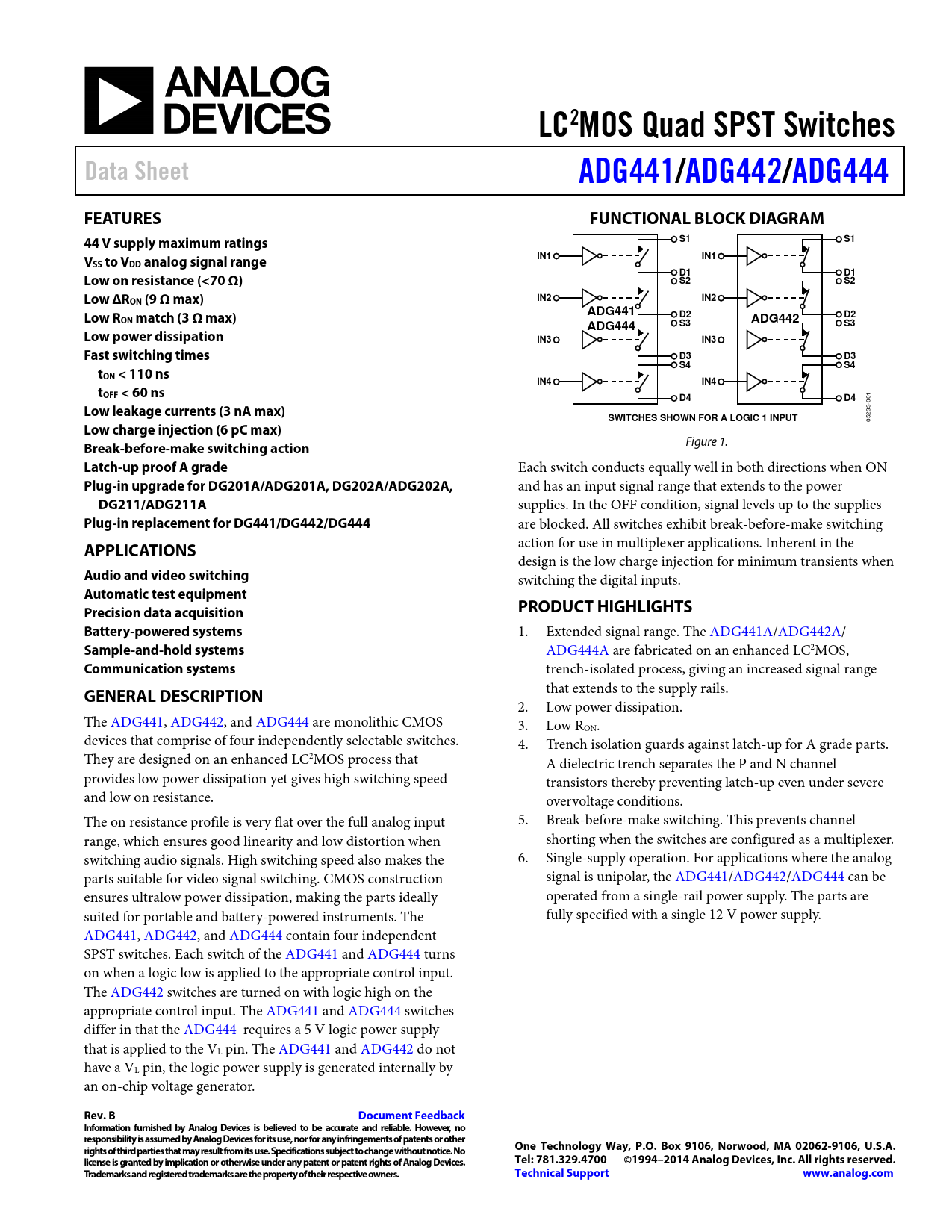

LC2MOS Quad SPST Switches Data Sheet ADG441/ ADG442/ ADG444 FEATURES FUNCTIONAL BLOCK DIAGRAM 44 V supply maximum ratings S1 S1 IN1 IN1 VSS to VDD analog signal range D1 D1 Low on resistance (<70 Ω) S2 S2 Low ΔR IN2 IN2 ON (9 Ω max) ADG441 Low R D2 D2 ON match (3 Ω max) ADG442 S3 S3 ADG444 Low power dissipation IN3 IN3 Fast switching times D3 D3 S4 S4 tON < 110 ns IN4 IN4 tOFF < 60 ns D4 D4 Low leakage currents (3 nA max) SWITCHES SHOWN FOR A LOGIC 1 INPUT

Figure 1.
