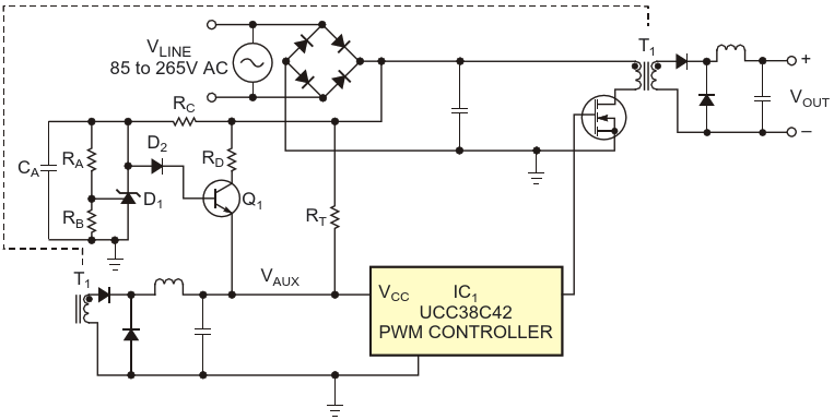

In this improved design, pulse-width-controller IC1 derives its power from RT for start-up, auxiliary winding WAUX for normal operation, and shunt-regulator circuit IC2 and Q1 for low-load operation
AuthorsMichael O'loughlin
Main DocumentArticle «Shunt regulator eases power-supply-start-up woes»
DescriptionFigure 3
File Format / SizePDF / 52 Kb
In this improved design, pulse-width-controller IC sub 1  /sub derives its power from R sub T  /sub for start-up, auxiliary winding W sub AUX /sub  for normal operation, and shunt-regulator circuit IC sub 2 /sub  and Q sub 1  /sub for low-load operation
