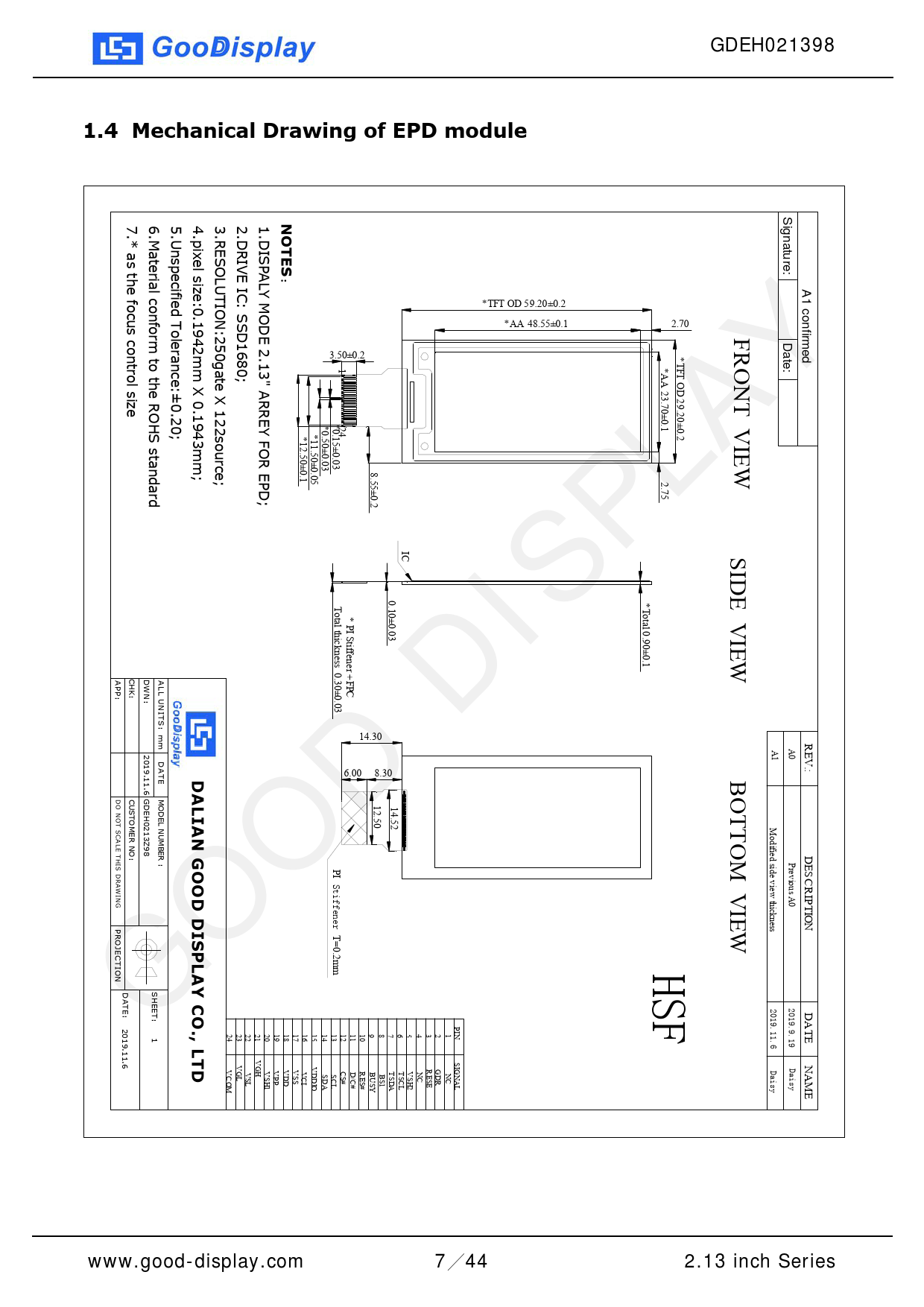

Previous A0 Modified side view thickness MODEL NUMBER : DO NOT SCALE THIS DRAWING CUSTOMER NO: 2019.11.6 GDEH0213Z98 DATE PROJECTION 2019.11.6 DATE Daisy Daisy NAME SIGNAL
NC
GDR
RESE
NC
VSH2
TSCL
TSDA
BS1
BUSY
RES#
D/C#
CS#
SCL
SDA
VDDIO
VCI
VSS
VDD
VPP
VSH1
VGH
VSL
VGL
VCOM 2019.9.19 SHEET: DATE: 2019.11.6 1 DALIAN GOOD DISPLAY CO., LTD PIN
1
2
3
4
5
6
7
8
9
10
11
12
13
14
15
16
17
18
19
20
21
22
23
24 HSF PI Stiffener T=0.2mm BOTTOM VIEW 14.52
12.50 D D IS
P *Total 0.90±0.1 SIDE VIEW IC 0.10±0.03 * PI Stiffener +FPC
Total thickness 0.30±0.03 O LA Y A1 confirmed
Date: FRONT VIEW
*TFT OD 29.20±0.2
2.75 8.55±0.2
24
*0.15±0.03
*0.50±0.03
*11.50±0.05
*12.50±0.1 14.30
ALL UNITS: mm
DWN: 8.30 6.00 2.13 inch Series 7/44 www.good-display.com *AA 23.70±0.1 1 2.DRIVE IC: SSD1680;
3.RESOLUTION:250gate X 122source;
4.pixel size:0.1942mm X 0.1943mm;
5.Unspecified Tolerance:±0.20;
6.Material conform to the ROHS standard APP: CHK: O Signature: NOTES : 3.50±0.2 2.70
*AA 48.55±0.1 1.DISPALY MODE 2.13" ARREY FOR EPD; *TFT OD 59.20±0.2 7.* as the focus control size G GDEH021398 1.4 Mechanical Drawing of EPD module
