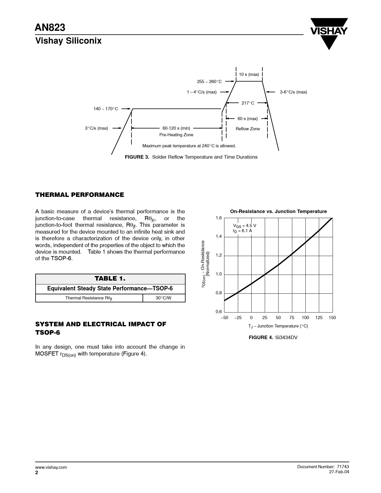

AN823. Vishay Siliconix. FIGURE 3. On-Resistance vs. Junction Temperature. Equivalent Steady State Performance—TSOP-6. FIGURE 4
AN823 Vishay Siliconix FIGURE 3 On-Resistance vs Junction Temperature Equivalent Steady State Performance—TSOP-6 FIGURE 4
10 s (max) 255 − 260_C 1X4_C/s (max) 3-6_C/s (max) 217_C 140 − 170_C 60 s (max) 3_C/s (max) 60-120 s (min) Reflow Zone Pre-Heating Zone Maximum peak temperature at 240_C is allowed.
FIGURE 3.
Solder Reflow Temperature and Time Durations THERMAL PERFORMANCE A basic measure of a device’s thermal performance is the
junction-to-case thermal resistance, Rqjc, or the 1.6 junction-to-foot thermal resistance, Rqjf. This parameter is VGS = 4.5 V measured for the device mounted to an infinite heat sink and ID = 6.1 A is therefore a characterization of the device only, in other 1.4 words, independent of the properties of the object to which the device is mounted. Table 1 shows the thermal performance of the TSOP-6. 1.2 − On-Resiistance (Normalized) 1.0 TABLE 1. (on) r DS
0.8 Thermal Resistance Rqjf 30_C/W 0.6 −50 −25 0 25 50 75 100 125 150 SYSTEM AND ELECTRICAL IMPACT OF TJ − Junction Temperature (_C) TSOP-6
FIGURE 4.
Si3434DV In any design, one must take into account the change in MOSFET rDS(on) with temperature (Figure 4). www.vishay.com Document Number: 71743
