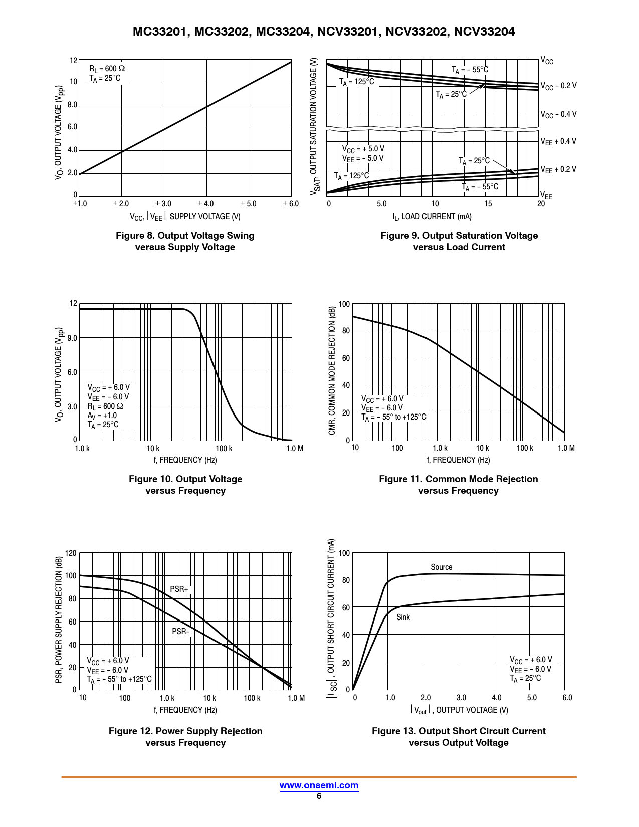

MC33201, MC33202, MC33204, NCV33201, NCV33202, NCV33204. Figure 8. Output Voltage Swing
MC33201, MC33202, MC33204, NCV33201, NCV33202, NCV33204 Figure 8 Output Voltage Swing
12 VCC RL = 600 W TA = -55°C TA = 25°C ) 10 TAGE (V) TA = 125°C VCC - 0.2 V pp TA = 25°C 8.0 TION VOL VCC - 0.4 V TAGE (V 6.0 VOL TURA SA VEE + 0.4 V 4.0 VCC = +5.0 V V OUTPUT EE = -5.0 V TA = 25°C , O 2.0 VEE + 0.2 V V , OUTPUT T T A = 125°C SA T V A = -55°C 0 VEE ±1.0 ±2.0 ±3.0 ±4.0 ±5.0 ±6.0 0 5.0 10 15 20 V I CC,⎮VEE⎮ SUPPLY VOLTAGE (V) L, LOAD CURRENT (mA)
Figure 8. Output Voltage Swing Figure 9. Output Saturation Voltage versus Supply Voltage versus Load Current
12 100 ) 80 pp 9.0 60 TAGE (V 6.0 VOL V 40 CC = +6.0 V VEE = -6.0 V VCC = +6.0 V OUTPUT , 3.0 RL = 600 W VEE = -6.0 V O 20 V AV = +1.0 TA = -55° to +125°C TA = 25°C CMR, COMMON MODE REJECTION (dB) 0 0 1.0 k 10 k 100 k 1.0 M 10 100 1.0 k 10 k 100 k 1.0 M f, FREQUENCY (Hz) f, FREQUENCY (Hz)
Figure 10. Output Voltage Figure 11. Common Mode Rejection versus Frequency versus Frequency
120 (mA) 100 Source 100 80 PSR+ CURRENT 80 REJECTION (dB) 60 Y CIRCUIT Sink 60 T PSR- 40 40 SHOR V V CC = +6.0 V 20 CC = +6.0 V 20 V V EE = -6.0 V EE = -6.0 V , OUTPUT PSR, POWER SUPPL T T A = -55° to +125°C A = 25°C 0 0 I SC 10 100 1.0 k 10 k 100 k 1.0 M 0 1.0 2.0 3.0 4.0 5.0 6.0 f, FREQUENCY (Hz) ⎮Vout⎮, OUTPUT VOLTAGE (V)
Figure 12. Power Supply Rejection Figure 13. Output Short Circuit Current versus Frequency versus Output Voltage www.onsemi.com 6
